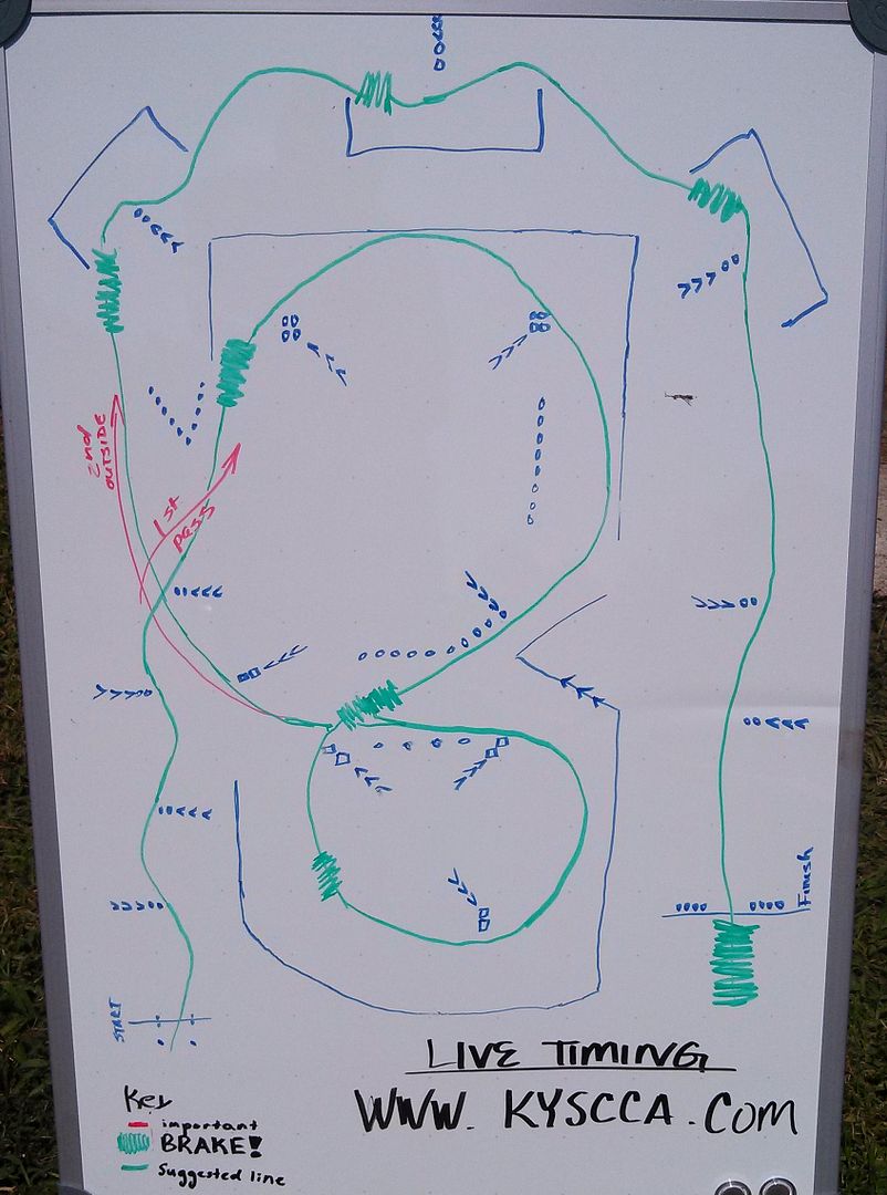

The 6 runs on the autocross were all steps towards a better time. 1st run I DNF'd as I missed the first cross over turn and the announcer came over the intercom "your going the wrong way"... 2nd run was 57.089 where I spun out on the back stretch, then 44.908, 44.784, 42.699, and 42.294. The best time of the day was in the 36 second range, so my times suck! I run the course in 2nd once I take off in 1st, but traction in 2nd gear is easily overcome in the straight line, let alone going around a corner, so less throttle lets the car go faster.

Here is a drawing of the autocross track:
Doesn't look like the videos for the 1/4 mile made it, but here are 2 from the autocross.. yeah I need a better camera for action videos.

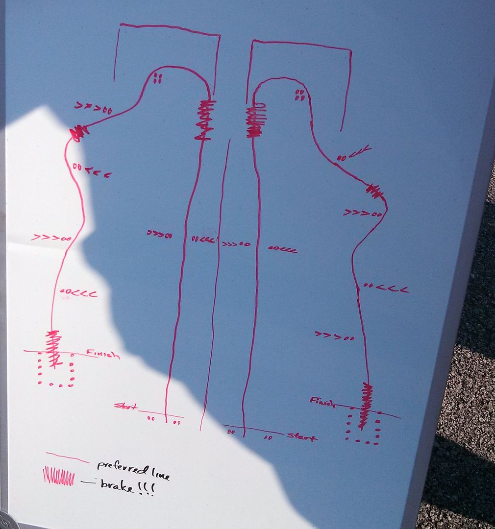

The 3S competition was a handful... Here is a picture of the course (2 cars run side by side, then turn opposite directions. Then switch sides and the average time for both decides the winner - bracket elimination):
During the practice rounds I started with a 16.623 for my 2nd time (spun out at the end for the first one and didn't get a card). Then ran a 15.957, 15.945, 15.926, and my last round was 15.230. The pro cars were running 13's, so it wasn't terrible. Tires, tires, tires...
I say it was a handful because I launched in1st, shifted to 2nd about 6000 rpm (at rev limit in 1st at 1/3 the way to the turn), WOT in 2nd, off the throttle, on the brakes, downshifting to 1st, tight turn (which I had to do 1 handed if I didn't get the shifter into 1st gear in time), give it hell in 1st, shift to 2nd and blip on/off the throttle as I went around the cones, then on the brakes again and stopping in the box.
