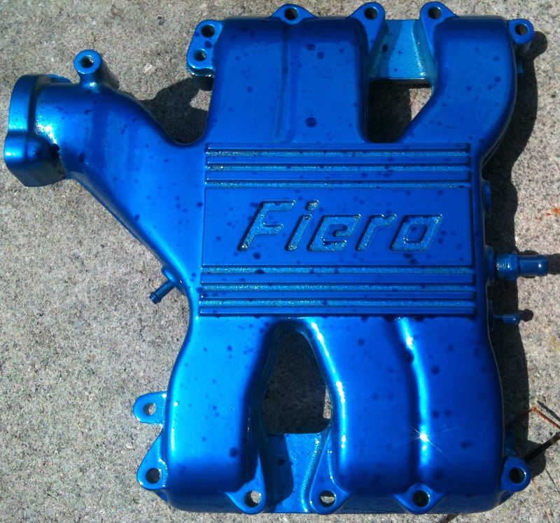

I've got a intake manifold that looks just like the color posted above. It's a 3 stage powdercoat: Silver Blue and clear with the letters in black. I have it on the car right now as I get the original one powder coated a different color... But it's coming back off in a couple weeks if your interested. PM me if you're interested.
If not, these should give you an idea of what the finished product will look like.

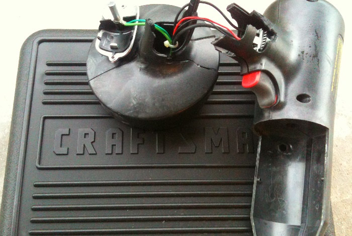

The latest is when I powder coated the upper plenum in Chrome, it out gassed and bubbled. It took 2 hours and all sorts of strippers and one heluva mess to get it all cleaned up and ready to go again. I heated the plenum for over an hour at 450 as recommended to make sure any trapped gas was removed before powder coating. This all done, I laid down the chrome powder on the already hot plenum, and it came out amazing! No bubbles, and a perfect chrome like finish! Before it cooled, I switched to the transparent blue to coat again, to give it a nice blue candy effect. This powder was manufactured by craftsman, and seemed a little coarser when I opened it to fill the canister. The AllPoderCoat chrome is a much finer powder.
Well, I set it all up, and started to spray, and clumps and chunks came out of the powder gun! It made a blotchy mess of the plenum, and ruined all the work up to this point... yet again!
This is getting ridiculous, and frustrating.... so frustrating in fact, that I now have to have to order a replacement powder coating gun, as something "happened to it" when it started spitting out clumps of powder ruining hours of work..........

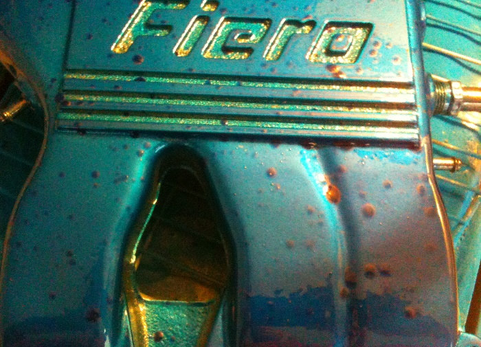

The part I am not looking forward too, is another 2 hours cleaning off all the powder coat again
Here is a better picture of what happened to it. If it was not for the clumping of the crappy, inferior, no good for nothing clumping Craftsman powder, it would have came out correctly.
This was done by heating the part to 450 degrees for an hour, taking out of the oven, and spraying on the chrome, which melted on contact and looked great! I then switched to the blue, and with the intake hot, the clumps melted in place, with no chance of fixing it....
