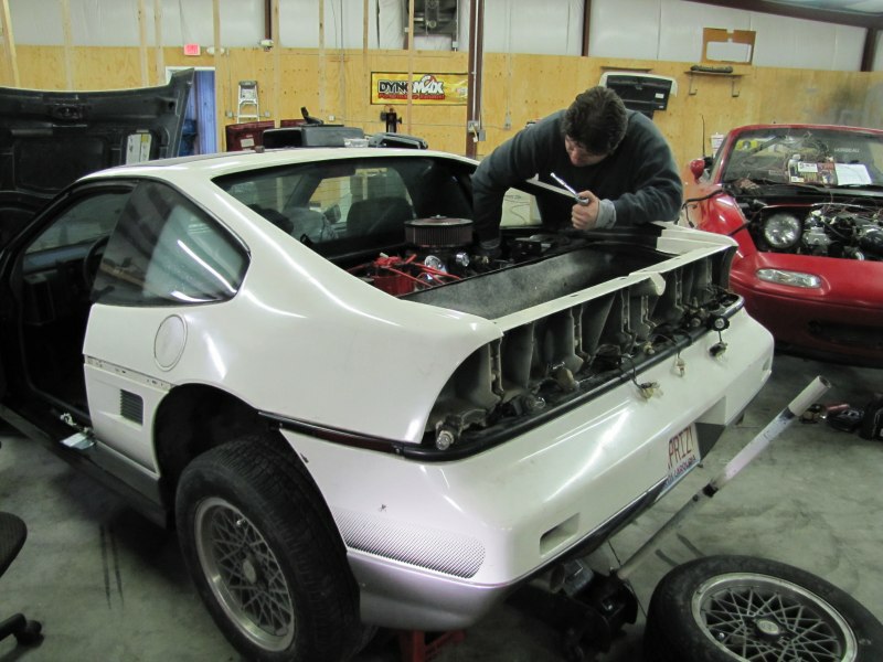

Proof that Vince CAN turn a wrench...
Startup and exhaust note.....
First drive around the parking lot...
The first drive on the road...
