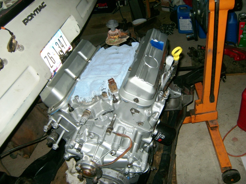

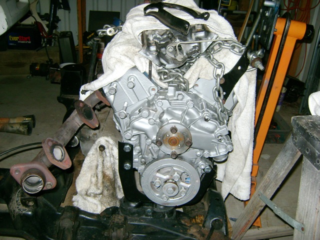

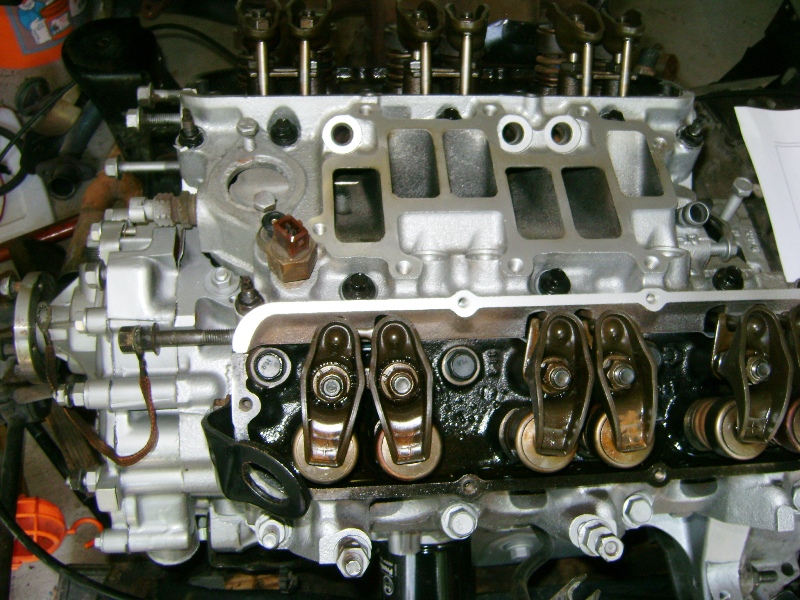

I was able to get it all back together this morning, and all of the motor mount studs in the cradle holes. TC spins vary easily by hand threw the starter hole.
and side shot:
Tomorrow's goal is lower intake and distributor.

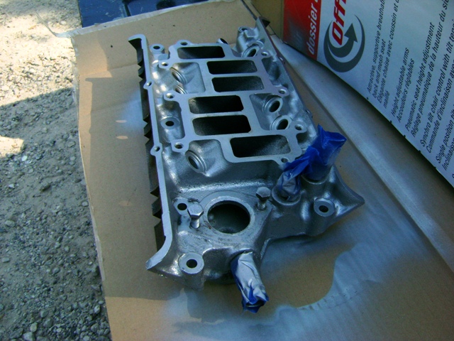

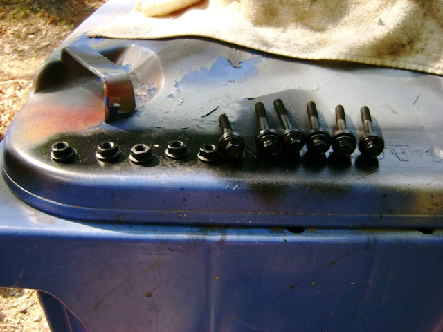

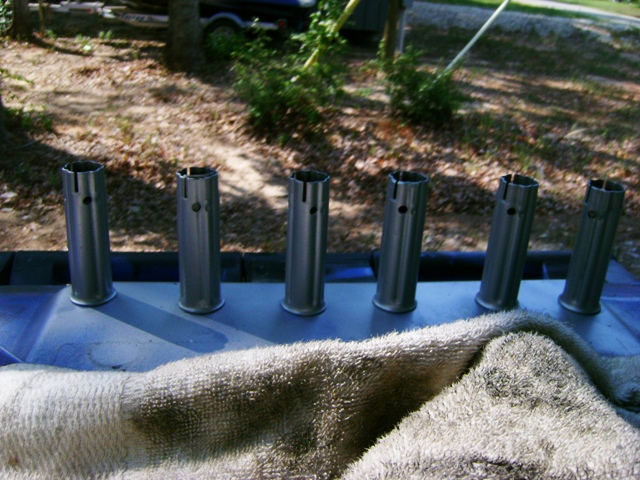

I painted the lower intake, and the fasteners for it this morning. Same for the distributor hold down. All will get a coat of engine paint, clear before they are put out in the hot Texas sun to bake at 100*. Cleaned the last of my dirty parts from the old 2.8.
Lower intake:
Fasteners:
Plug Wire protectors:

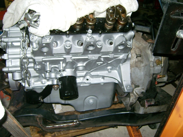

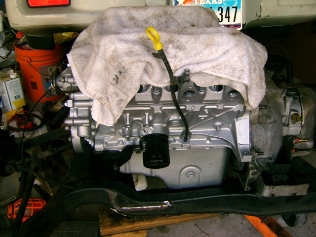

As she sits today:
josef644 JUN 11, 05:09 PM
Went back out and installed the lower intake. Torqued down to 19Ft Lbs. Starting to look like an engine.

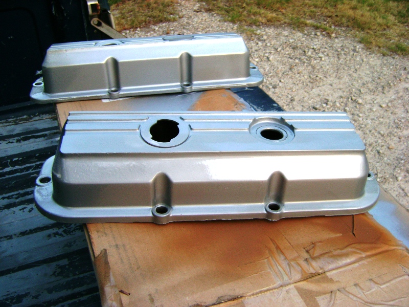

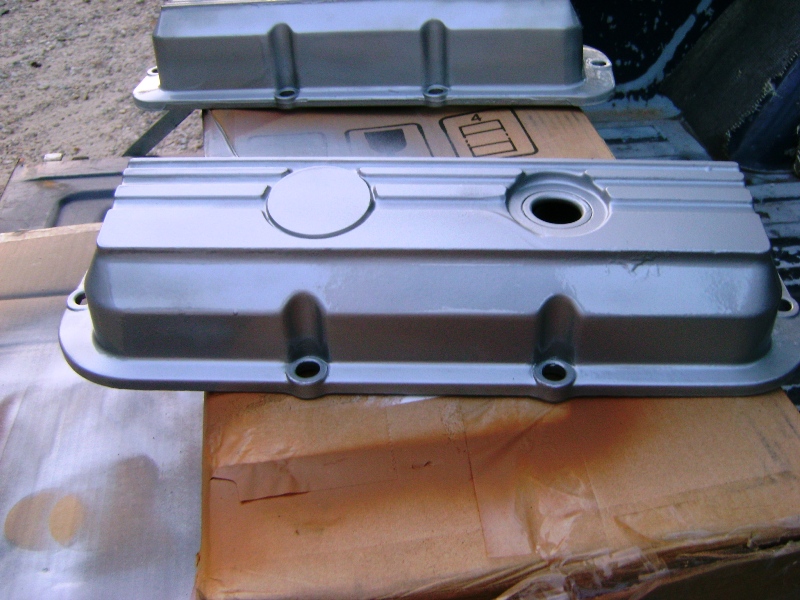

Valve covers painted, and clear coat applied:
and:
[This message has been edited by josef644 (edited 06-11-2011).]
