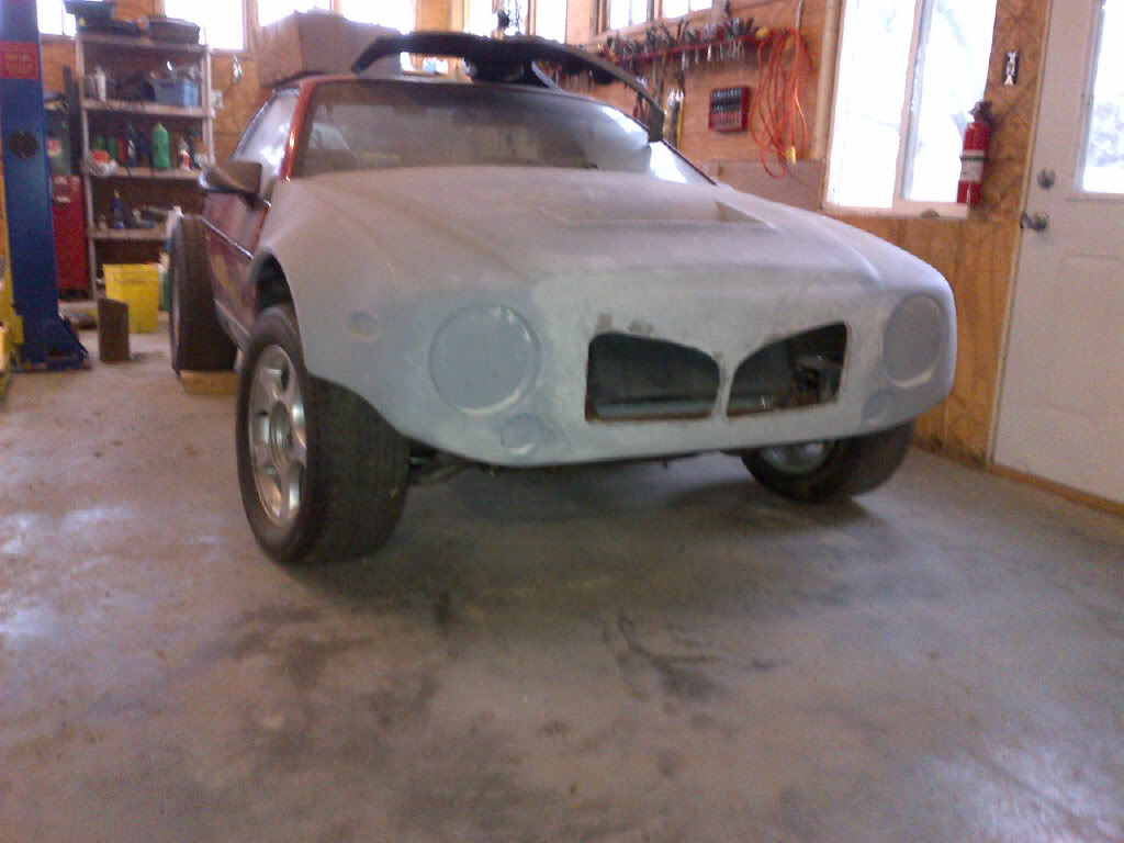

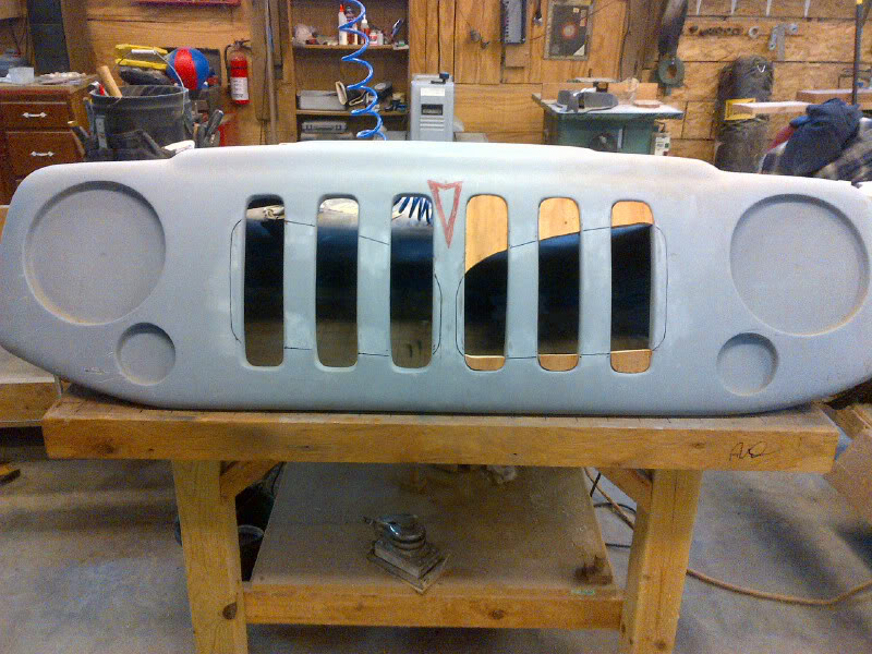

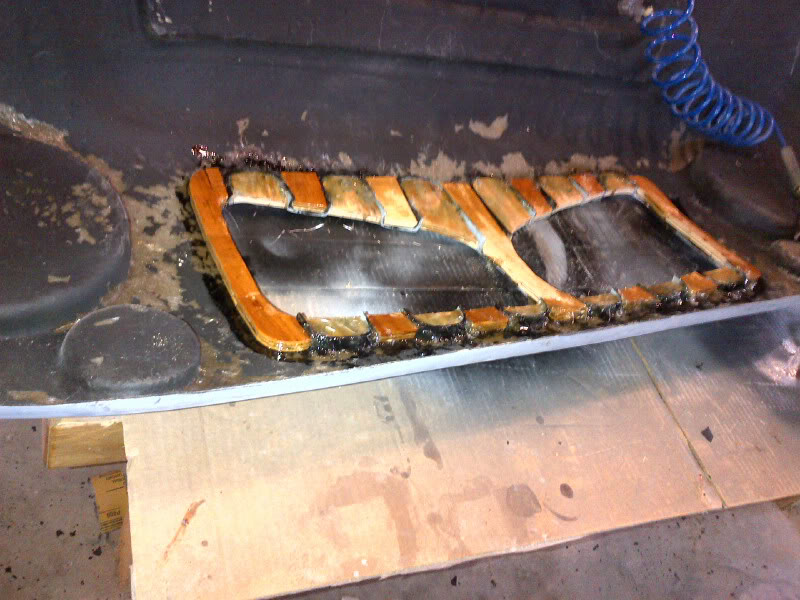

Progress! Did I mention that I don't like doing fiberglass? Since I'm trying to make a "compliment" to the Solstice, I thought a similar grille was proper.
I still have some work to do on the backside, and need to build the grille insert (honeycomb aluminum from Grainger).

Fierostarvin OCT 22, 09:22 PM

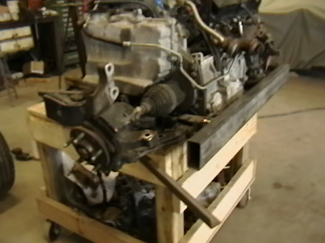

You might not like fiberglassing but it looks like you do a good job. Is that the Caddy cradle? It looks massive. p.s. good sticker in the back window
artworks OCT 23, 08:27 AM
Here's a picture of the Northstar in its cradle. This is the stock Cadillac cradle that's been modified to bolt into the Fiero frame. There are four connection points between the cradle and the frame - leaf spring bushings are used for the connections. My friend Gary is the genius behind the fabrication.

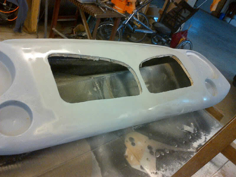

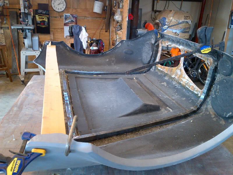

Slow but steady progress. I found headlight buckets and trim bezels on e-bay, and side marker lights. Also, building the steel reinforcements I am glassing into the hood - the plastic is just a little too floppy for my tastes. Pics to follow.
artworks NOV 04, 02:50 PM
Test fitting the hood with the new grille cutout

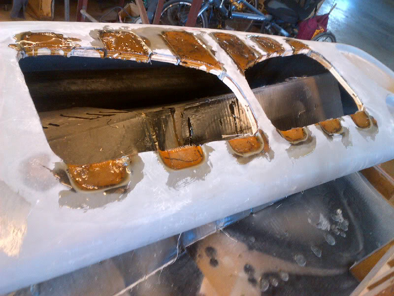

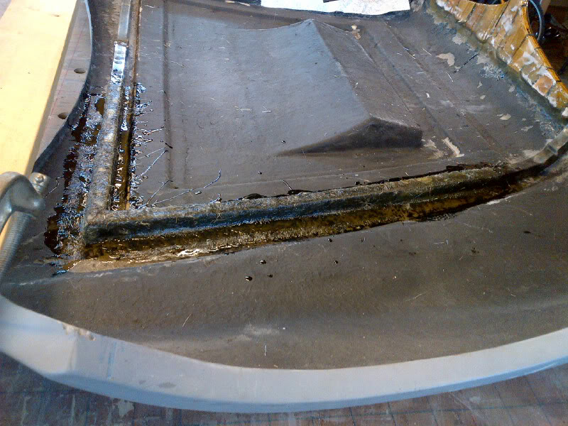

artworks NOV 04, 02:53 PM
The steel reinforcement in place and getting glassed in. It's 1x1 square tube welded together. There's a 1/8" plate in either side of the grille to bolt on the nerf bar.
