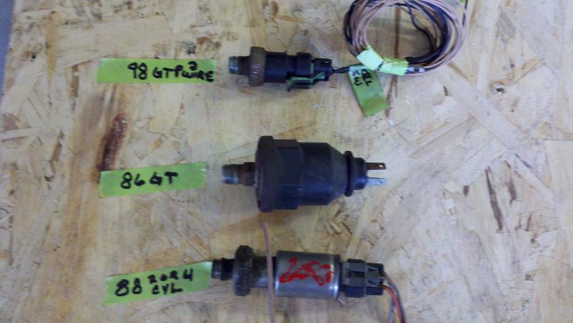

I might be stating this a second time but make sure both your CTS and your oil pressure sender connectors are 3 wire connectors. Middle pin of each goes to the gauge. Also if either the CTS or the oil pressure sending unit are not 3 pin devices they will have to be replaced.[This message has been edited by phonedawgz (edited 07-08-2011).]

I have a three wire CTS. I have a two wire oil pressure switch on the oil filter adapter. What would be the P/N of the correct one?
phonedawgz
JUL 08, 05:34 PM
Look up a replacement for an 88 Fiero 2.8 and that's it.
hercimer01
JUL 08, 06:02 PM
I have the old 2.8 that came out of the car, 86GT. Ill just use that one. Thanks!
Edit; I checked the P/N 86 vs 88, they are different, I will look up the specs to see if it will work. They are both 3 pin. The thread sizes are all the same for all three engines. Yup, Rock Auto shows the 86 one will work on the 88 engine.
88 fiero Thread Size 1/4-18 NPTF Dryseal Switch opens 2-7 PSI 80 PSI - 60-96 Ohms 40 PSI - 48-70 Ohms 8 PSI - 20-35 Ohms Less than 2 PSI - 5 Ohms max
fits BUICK (1987 - 1995) CADILLAC (1998 - 2000) CHEVROLET (1988 - 2001) GMC (1988 - 2001) ISUZU (1996 - 1998) OLDSMOBILE (1987 - 1999) PONTIAC (1987 - 1995)
Re-edit; The 86 one is too big for the low mount alternator but it will clear the axle. I guess i need to buy one, LKQ here I come.[This message has been edited by hercimer01 (edited 07-09-2011).]

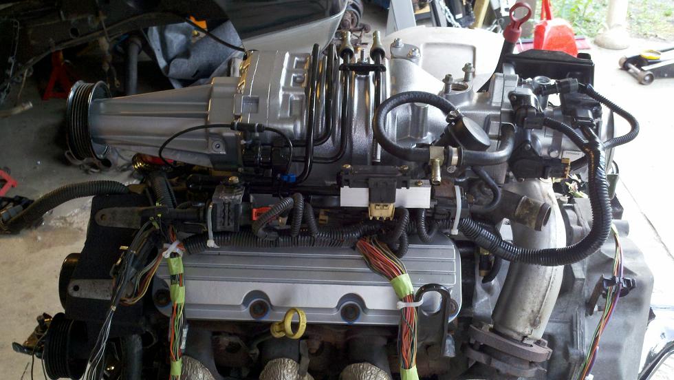

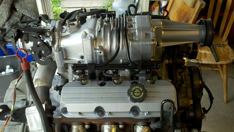

hercimer01
JUL 11, 01:46 AM
Got this much done this weekend.

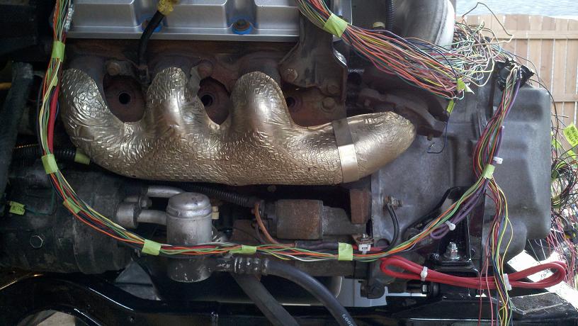

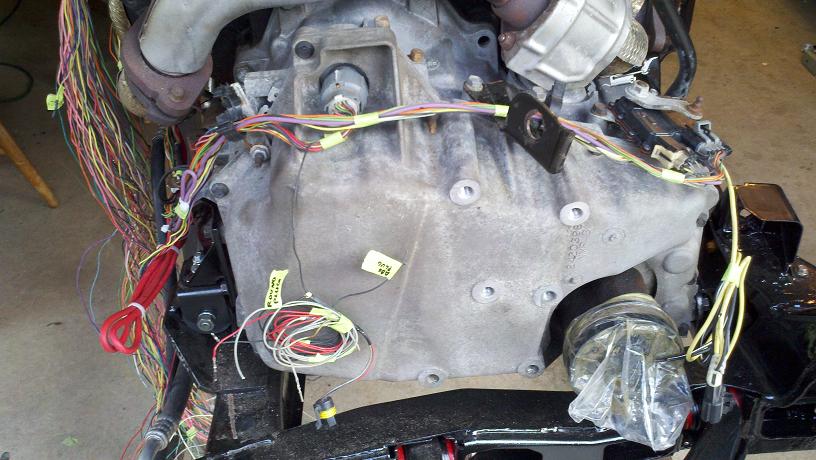

hercimer01
JUL 11, 02:00 AM
What is up with this mystery connector (small round spliced into tranny connector with a gray wire? It does go to the PCM.
phonedawgz
JUL 11, 02:06 AM
It looks like the AC Pressure Sensor. If so it connects gray to +5v, black to sensor ground and the red/black wire goes to the PCM.
The boost bypass valve usually gets deleted. I see yours is still on.
Many builders decide to locate the MAP and EVAP Purge valves on the transmission instead on top of the valve cover to keep the top of the engine cleaner. Where you locate them is personal choice of course.[This message has been edited by phonedawgz (edited 07-11-2011).]
