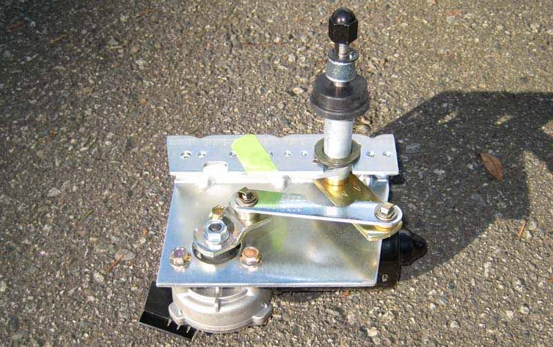

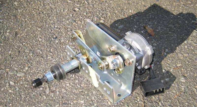

lou_dias OCT 07, 11:13 AM
Windshield wiper solution?
Car-Lo OCT 07, 11:26 PM
Thanks for asking...
Madcurl using the Lotus wiper ( he's got class)
Car-Lo using the Sterling wiper ( He's got Budget)
[This message has been edited by Car-Lo (edited 10-07-2011).]
