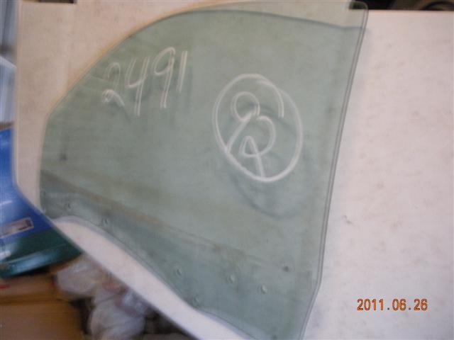

I finally got to try the 1992 Toyota Celica side window. Good news and bad. It will fit a chop but you would have to gut the door and make a new window track. I will just use my windows.

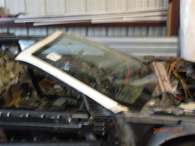

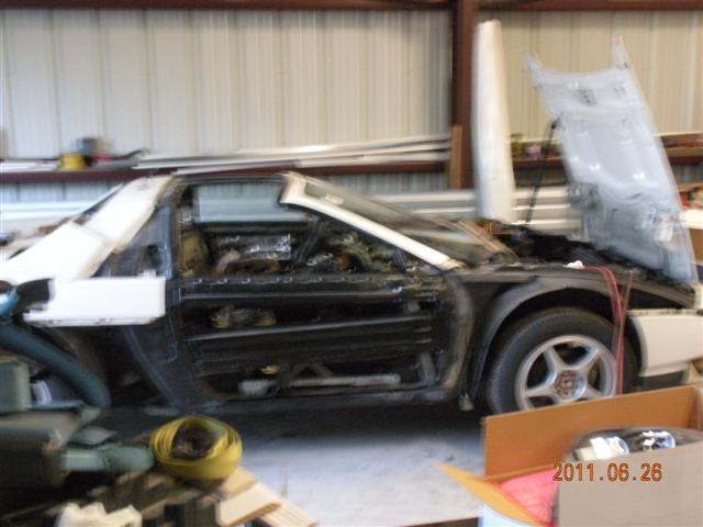

.jpg) If some one wants to make it work go for it but it will be a lot of work. Here are a couple of pictures of the Sebring windshield sitting in the hole. I hope to get to work on the tray this week. I still need to make a template for the back window.
