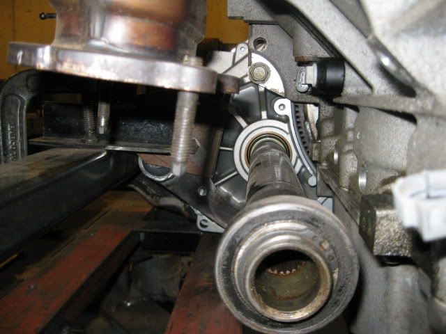

FieroGuru, I have a question about exhaust manifolds, and spacing. The LS4 rear manifold angles way from the engine block, and gives plenty of room for the trans and passenger side axle. Using the LS7 manifold that hugs the block more, is there an issue with interference between the down pipe from the manifold and the passenger axle? I am thinking of using some LS2 manifolds, which would be similar in style, but I have concerns about the down pipe. If you could, please post a picture from the from the passenger side wheel well with the axle installed. Thanks a lot. Mike

The LS7 manifolds are similar to most corvette manifolds, they typically do not hug the block at all, just exit straight down from the heads. I do not have any LS2 manifolds to compare them too, but probably the next best would be the 97+ formed stainless manifolds from the Vette and cut the collector bend off of them. They are a formed stainless manifold with integraded heat shields/insulation and are quite compact. Just cut the collector bend off of them and install some band clamps.
There is about 2" of clearance between the exhaust and the intermediate shaft with the LS7 manifolds. It isn't the easiest to see in this picture, but you can make out the closest edge of the manifold to the intermediate shaft.

Here is a better picture of the clearance:
