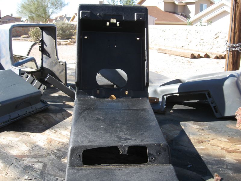

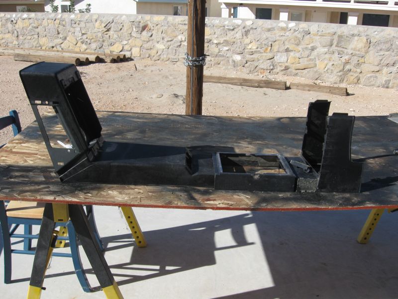

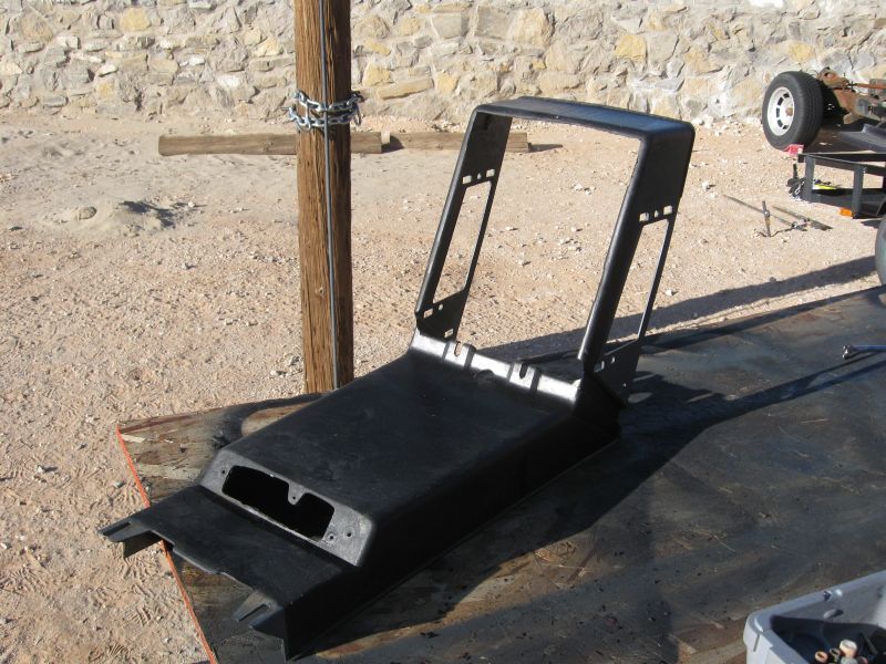

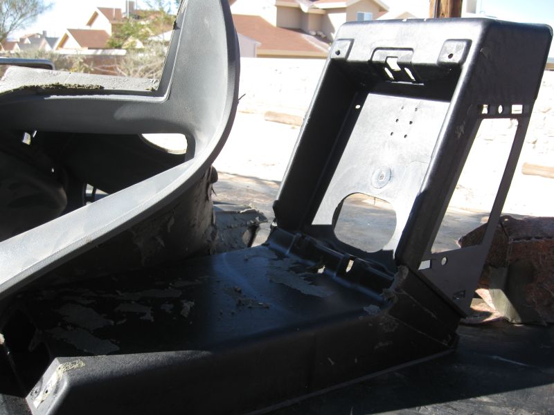

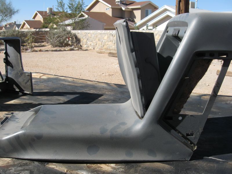

Started working on the Console project this evening. The pieces I have are a little broke up so I will have to do some repair work first, First things first was to strip the covers off and clean off all the glue and foam. Then I epoxy'd a few of the broken pieces. I cut the original glove box out of the rear piece and will fill this hole with a thin piece of wood. Once the glass work is done, I will fit an 8"sub in this space.
The donor:
Taking off the Cover:
Stripped:
The line up:
Cleaned up and trimmed:

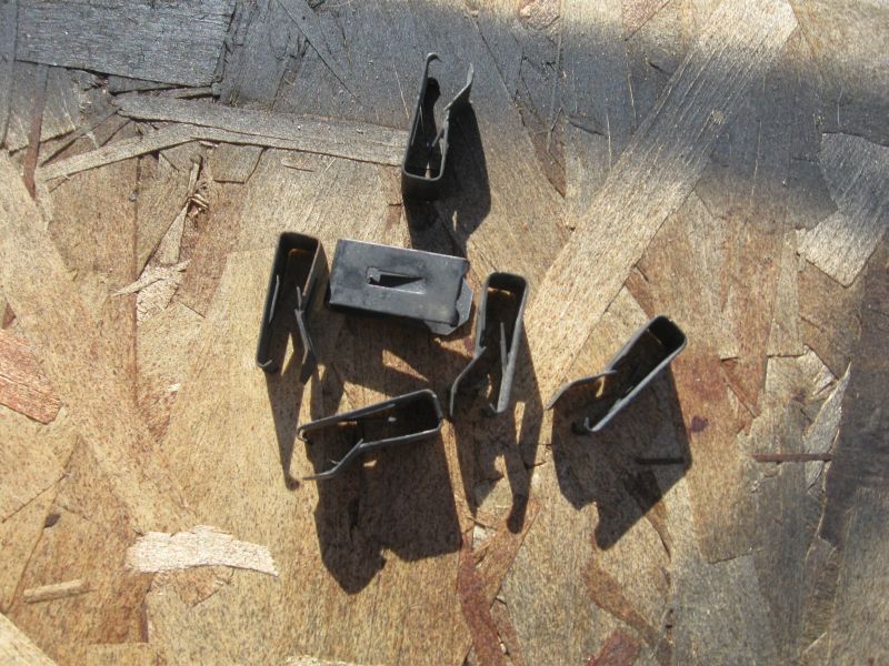

I was looking for some carpet clips that hold the carpet to the skeleton. I posted over in the Mall looking for some and had one guy say that he had them and I never heard back from him. While I was rummaging through my shed this afternoon, Yahtzee! I found about 20 of them. I really need to go through this stuff and make a list of what I have. I could probably build a complete car if I had a frame.
Here's the little buggers:
