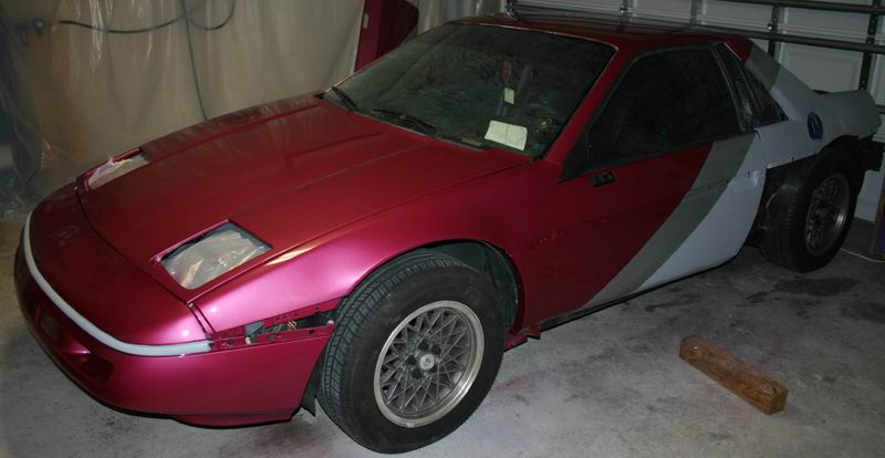

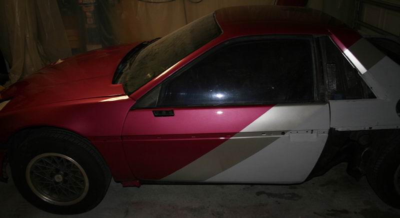

JimmyS
MAR 03, 09:39 PM
Couple of teaser pics...
Keep in mind that the panels are all just laying on the car. Nothing is bolted back on yet.
I unmasked quite a bit of it but tomorrow I plan to install the whole front end back on the car.
Carver1
MAR 03, 10:14 PM
That looks SHARP! I've always wanted to be able to paint a car.
Newbfiero
MAR 03, 10:40 PM
Man thats coming real good I love evrything about it
