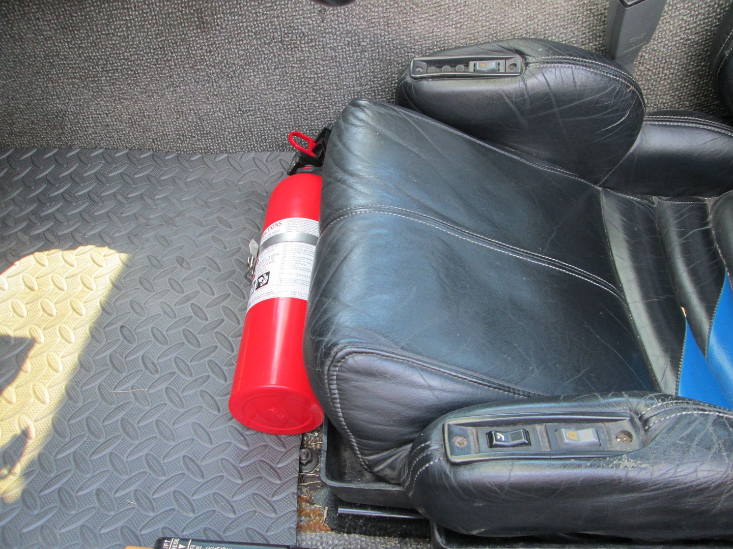

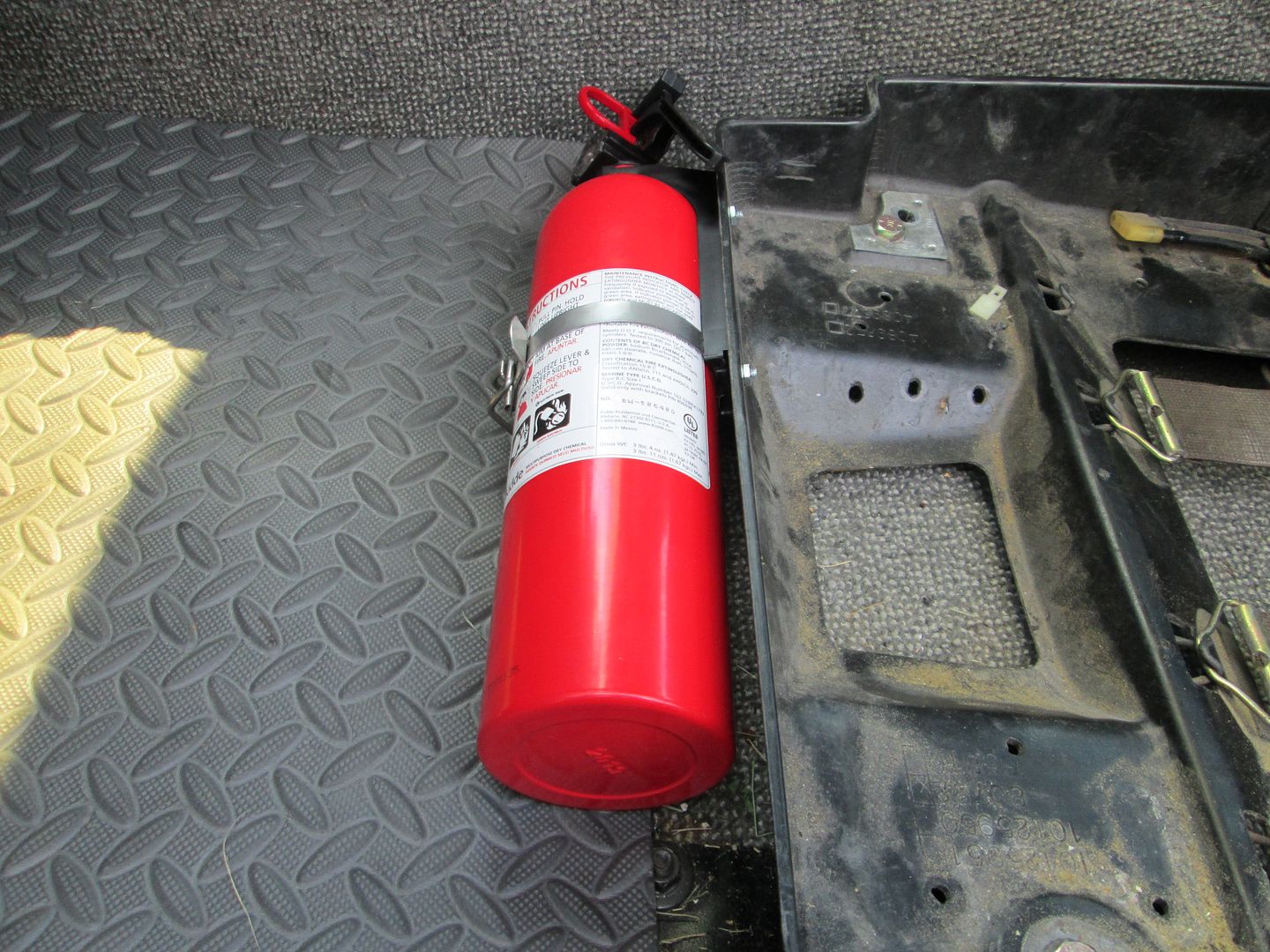

Also, fixed the horn, checked all the brake lights/tune signals and installed the fire extinguisher. Per the rules:
"On board fire extinguisher - A 2.5lb minimum, automotive BC fire extinguisher, with a quick release mounting bracket. The extinguisher must be within easy reach of the driver."
I think this will work, it is mounted to the seat frame of the C4 Corvette seats:
