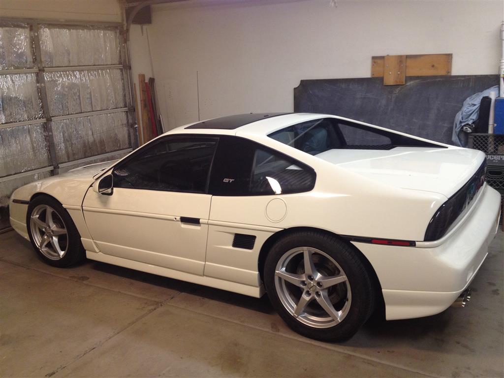

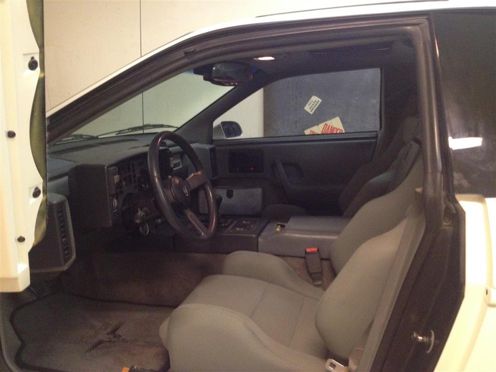

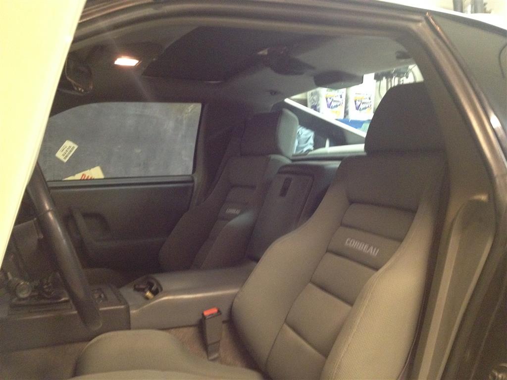

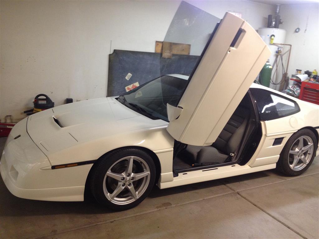

Got the rockers and mirrors installed but there were casualties with one each of both items... The driver's side rocker installed easily and with no issues. The passenger rocker front clip ducked under the slot it was supposed to slide into and when I massaged it back up into the slot, the paint cracked. One more item for the paint touch-up list. Otherwise, both rockers are installed and look ok. I knew before hand that the power mirrors I borrowed from the 86SE parts car did not work but they were in good physical shape. I found out during troubleshooting that both the mirror motors and the mirror switch were not working. It was kind of a pita to get the motors apart but luckily they were not damaged too bad during the process and all I needed to do was spin the motors by hand a bit and then they worked fine. The mirror switch was another pita but after very carefully getting it apart, I used 600 grit to remove the corrosion on each of the contact points and now the system works pretty well. The only real casualty was in breaking the passenger side mirror glass when trying to push the glass backplate pivot into the motor clips. I have a new replacement mirror glass on the way and should have it installed on Monday. Now I am working on the ride height and a rough alignment so I don't wear out the new tires getting to an alignment shop. Not sure if anyone is willing to work with me on this car because I cannot let them open or shut the doors. I may end up doing the full alignment on my own... Latest pics of the completed interior (except the armrest lighter cover) and the outside.
