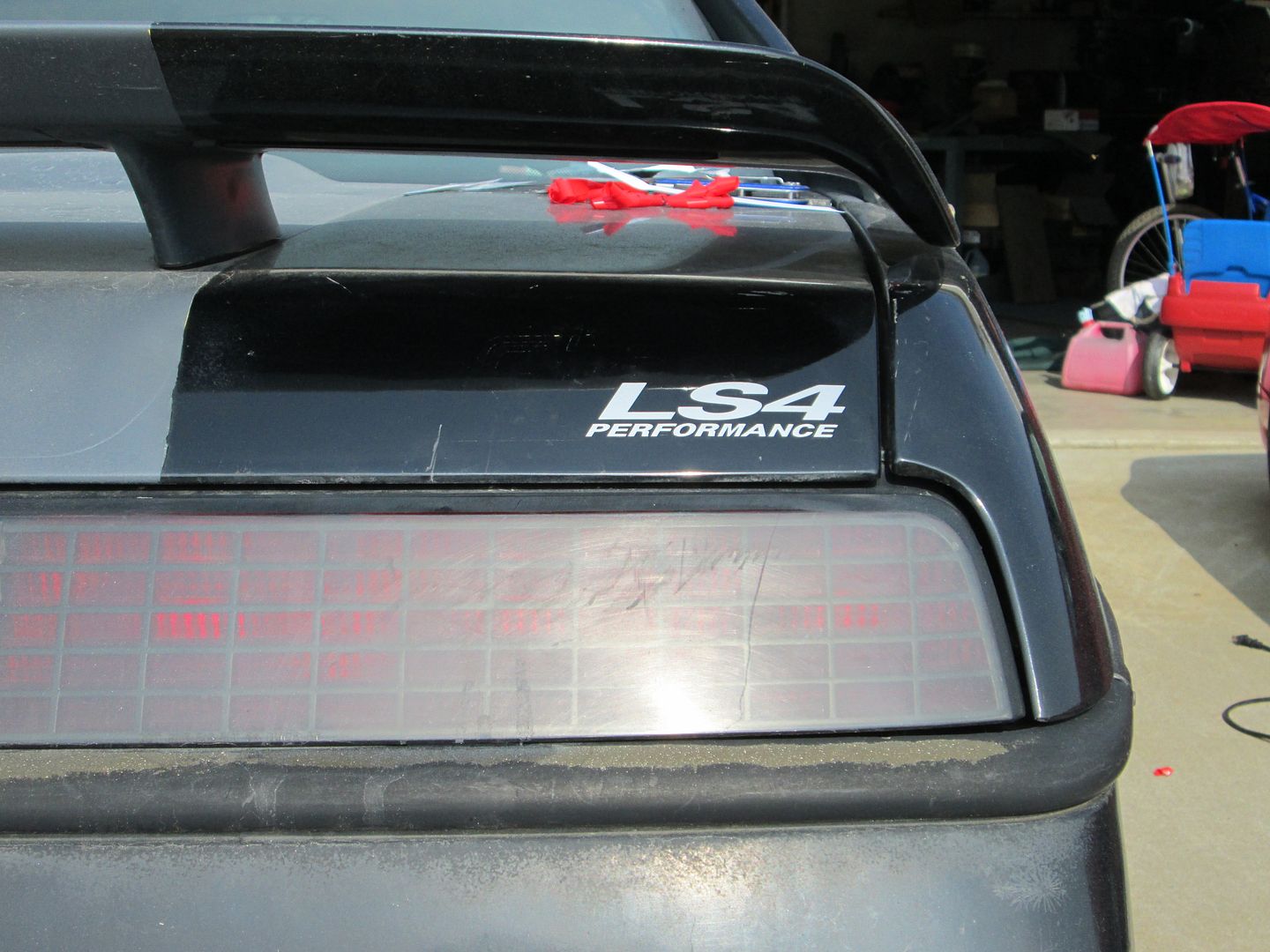

While working on the side windows, I also installed the decal for the rear decklid:
I have 2 more of these and thought about placing them on the sail windows, but for now I am going to leave them off. The car's exhaust gives it enough "presence" and I don't want the badging to be too "look at me". Understated looks with overstated exhaust note...

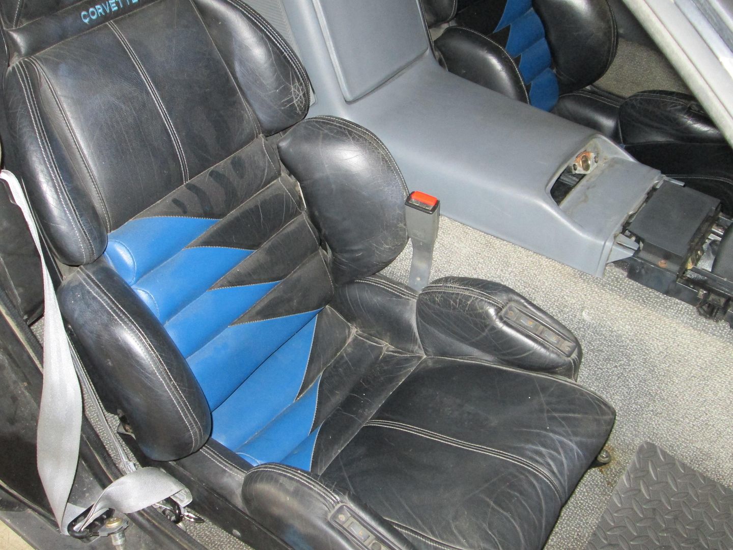

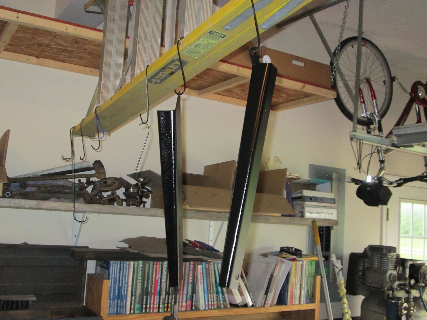

I also fabbed up the passenger side seat mounts. Like the driver side, they are 16ga sheet metal bent into a tapered "C" shape so I could pickup the stock fiero seat studs and mount the C4 vette seats to the top side of the "C". The lower seat cushion comes out for mounting, so that makes it easy, especially since the seats are mounted in a fixed position vs. on sliders. Notice how dusty the PS seat is vs. the DS... I need to clean it or take some buddies for a ride.

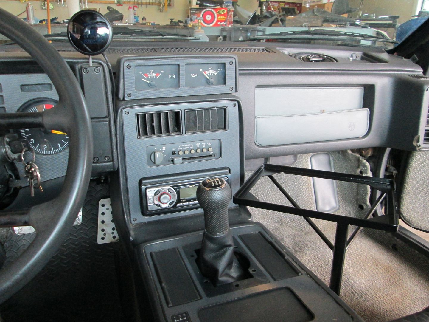

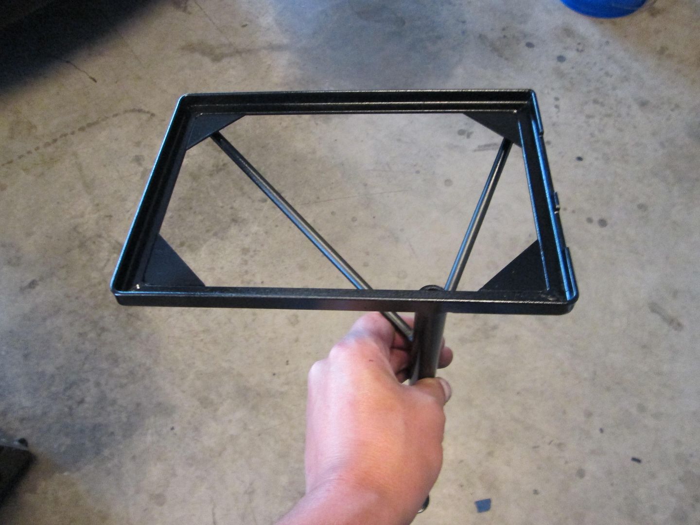

While I was painting, I went ahead and painted the Laptop stand, once it was dry installed it as well as the rest of the console interior stuff:

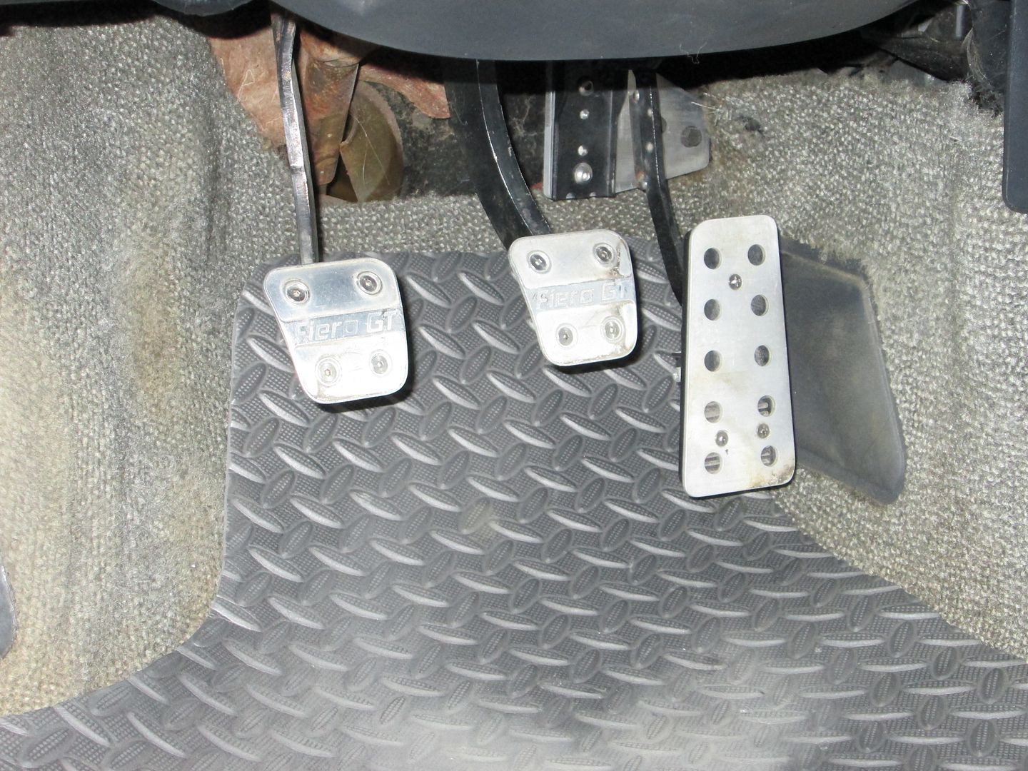

Also went ahead and installed the aluminum faces for the pedals. These were originally installed on the Blue SBC car (so they say Fiero GT). They need a cleaning as well, but when you drive the car daily stuff will get dirty.

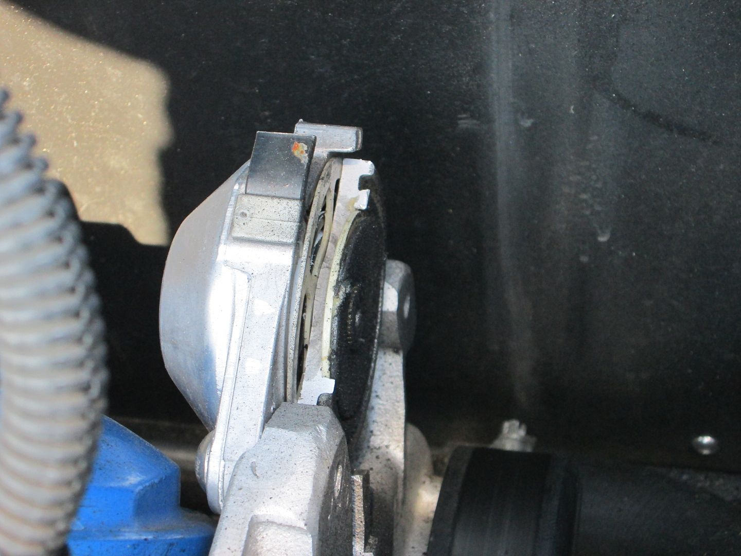

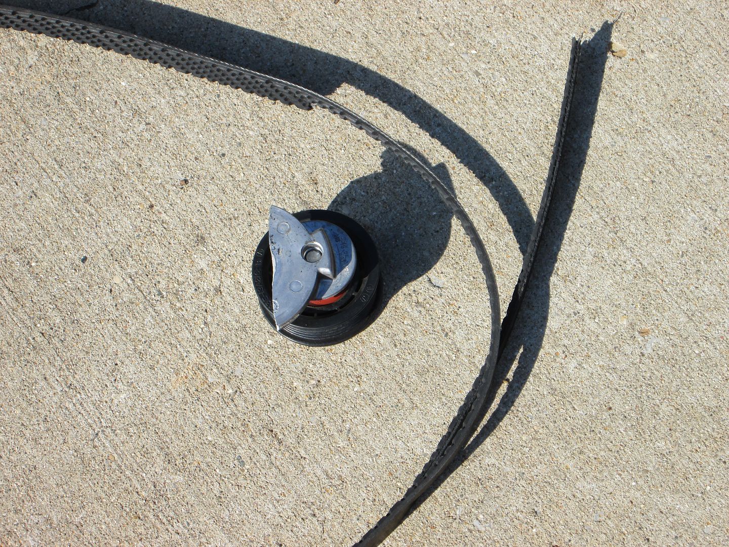

Snapped the belt tensioner today... been pretty easy on the car the last several days and was just starting/idling/stopping the engine doing some more idle refinement on the tune when I hear a snap/crash/cling type sound when I turned the key... This was the cause:
Already have a new tensioner installed... I will watch it a little closer for the next month of two to see if it shows any signs of a similar type failure.

fieroguru JUN 13, 06:22 AM
Originally posted by Trinten:
Ouch - glad it didn't bust up anything else when it all broke loose!
Yeah it probably would have been ugly if it had let loose at 7K RPM and 110 MPH...
Originally posted by Jefrysuko:
Did it cut the belt too?
No modifications to the tensioner correct, just the front housing it mounts to? Gotta love using stock parts from other applications with high availability in the parts stores.
The belt got slit, but I suspect it happened after the tension broke and the belt wrapped around something.
Yes, the tensioner is bone stock from a V6 camaro and the parts stores keep them in stock, so I just needed to make a trip to town and drop $35 on a new one.
