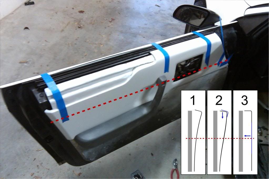

The pain was great... I found another "self inflicted" warping problem. It wasn't just the top that warped. The entire panel warped. The worst area is right where the top of the grab handle bolts to the door itself.
From this basic diagram you can see how the panel warped
1) Shows how badly the panel warped - the red line represents where the top of the grab handle bolts to the door.
2) Shows how I had to push the top part down - as you can see, when I heated the fiberglass and manipulated the glass to fit into place, I created a bowing effect at the red line where the grab handle is mounted.
3) Shows the area (in blue) where I have to heat the panel and try to manipulate back into its original position.
UGH... It's not getting me down. Just a few steps back... I'll catch up. Mostly...
The good news, the new 89 Concept radio bezel is coming along and almost ready for its debute |
the problem you are having is caused by fiberglass resin shrinkage to avoid this bowm the pannel in the oposit direction when appling the fiber glass then as it shrinks it will straighten it self out to level ps dont use resin by its self to do repaires as it will srink even faster causing mor problems and with pin holes in the surface use gell coat to repair these areas as filler will not always penitrate the pin holes as gell coat does

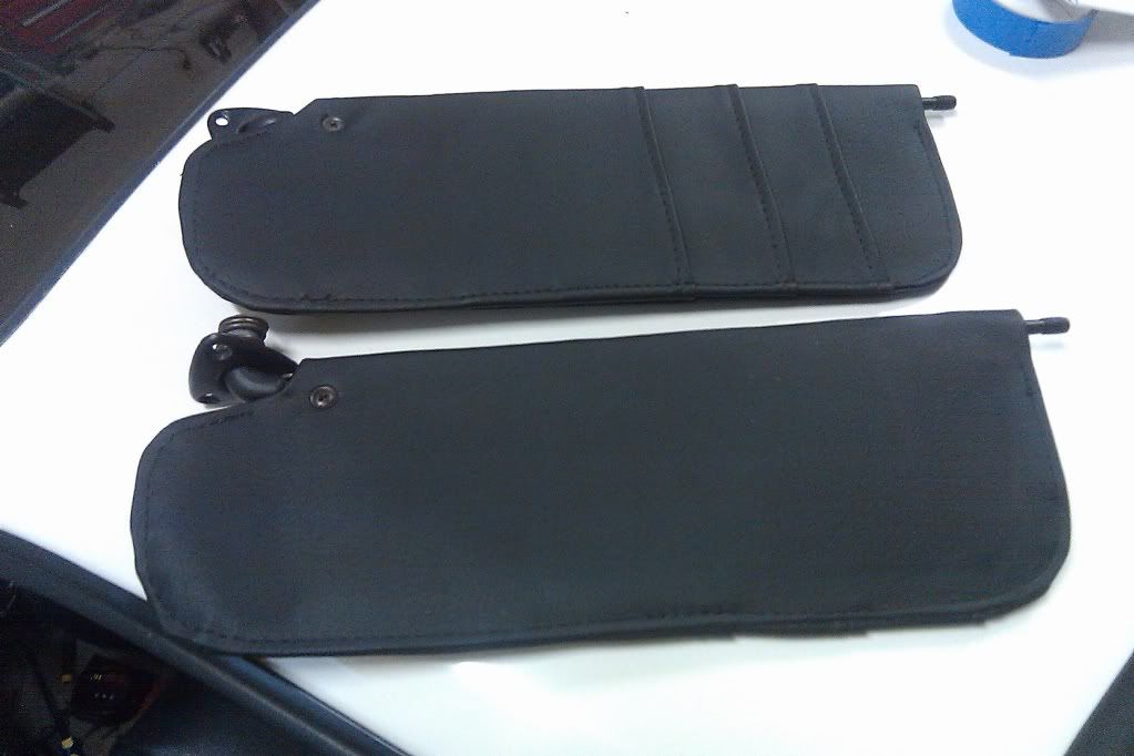

Hi ALL!

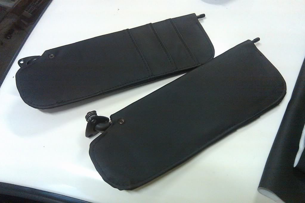

I completely forgot to post these pics of the newly upholstered sunvisors! I had 3 pockets stitched on each - you know me... you can have never enough places to store stuff! I think they turned out real sharp. The same shop will also upholster the door pulls.
Enjoy
OK... back to the pile!

I also want to thank everybody for all the kind words and the encouragement. I'm still plugging away. It always seems the closer you get to finishing a certain or step to a project all those tiny details just kill ya and slow up the work. I spent a few hours sanding down the radio cover - it's about 90%. I rolled the edges where the bevels used to be and it's looking really good so far. I still need to add a little bid of filler. I'm also working on a latch system to keep the cover in place - more on that later. The door panel is almost fixed. That was another 2 hours of heating and reshaping with the heat gun. A lot of cracking happened so I'll have to sand and remove material around those areas and then build everything back up with resin, glue and filler. I could finish the passenger panel but Id rather do everything and then install it all at once.

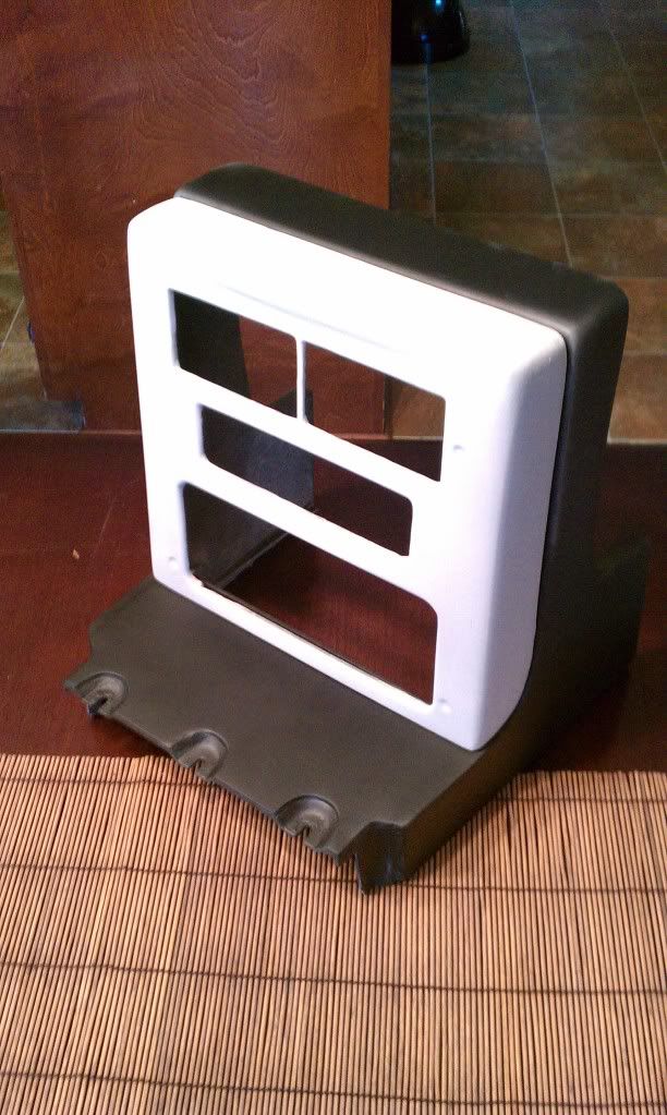

Here are a few updated pics that show the curvature of the openings in the radio cover...
Overview
You can how curved the edges are - still lots of work to do - especially on the back side

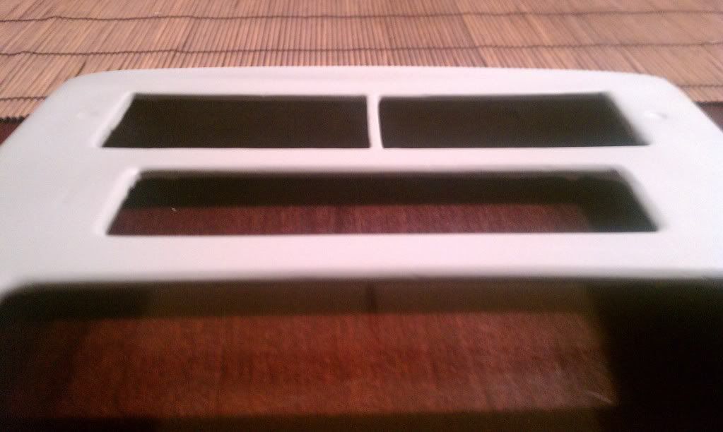

In this shot you can see the small lip over the top of the vents

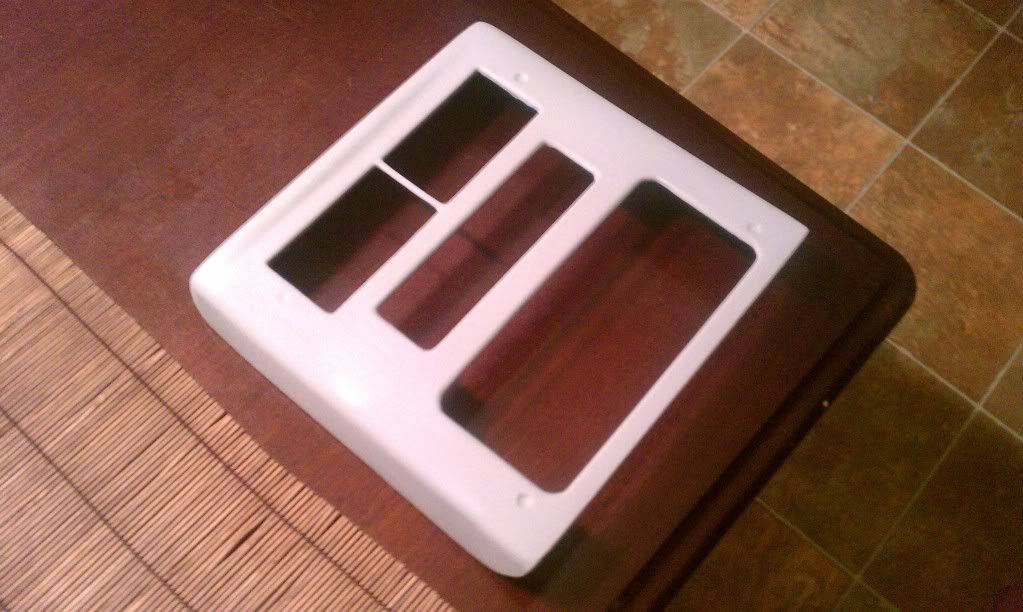

I tossed on a quick layer of flat black just this morning before work
Another
Still a ways to go before I can declare this piece finished. While the bulk of the work in finished, it's the fine sanding and filling (as I always say) that get ya in the end...

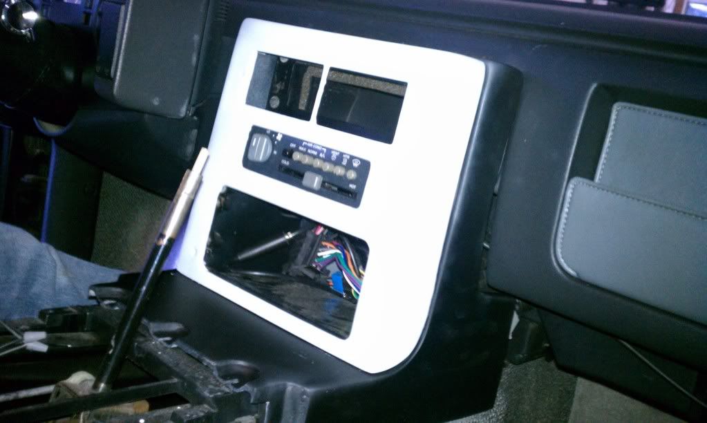

JAN 03, 08:48 AM
Happy New Year to All!

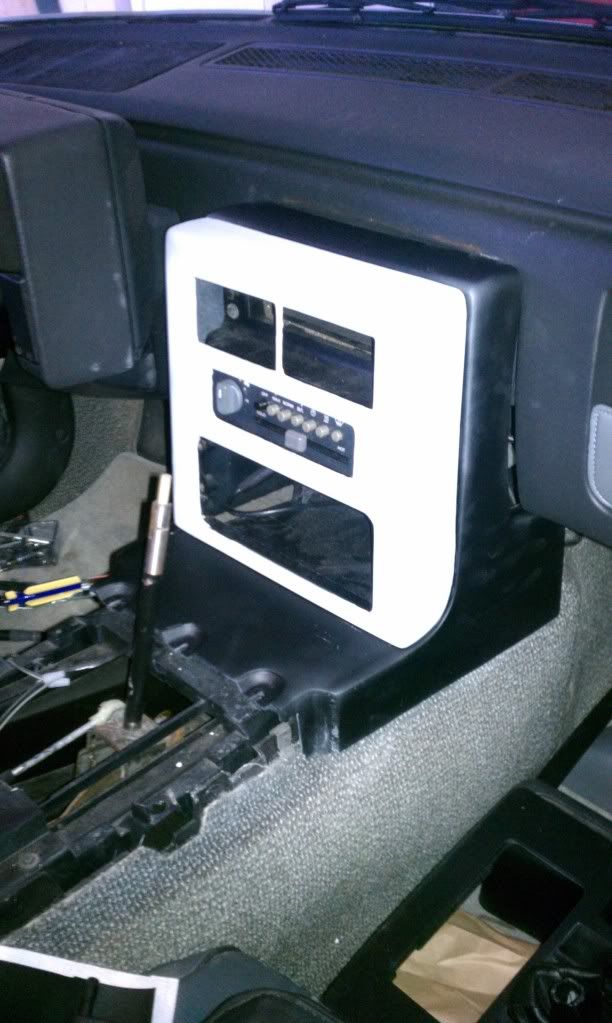

Here are a few updated images of the radio console. I have some tweaking to do on the back part that meets with the dash. Not a huge undertaking. But it's coming along!
In the car
More to come!
