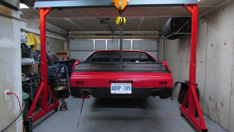

So there comes a point in many Fiero owners' lives when they have to drop the engine.... I just moved into a new house and I have more garage space now. I recently built a nice gantry crane and I wanted to put it to use.
Here is the unsuspecting victim:
And then it just happened:
The picture that everyone HAS to get when they drop the cradle:

Neils88 FEB 06, 11:30 PM
Please tell me you aren't using the trunk latch to lift the rear end! It is not designed for the load.
doublec4 FEB 07, 01:10 AM
Most definitely not.
I drilled two holes into the wall that divides the engine bay / trunk and used two M12 fasteners to bolt a piece of 1/8" wall 2"x2" square tube to that wall. There is a large lifting eye bolted to the square tube. I can get a picture tomorrow.
