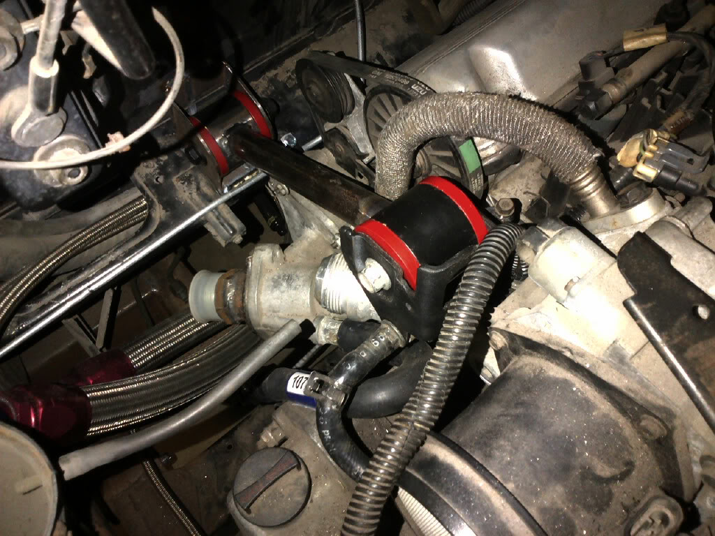

The second dogbone was installed last night - first the motor needed to be pulled so the firewall bracket could be installed. Then back in the car to fit the dogbone. Unfortunately, the water pump shroud will need to be modified to miss the new pa

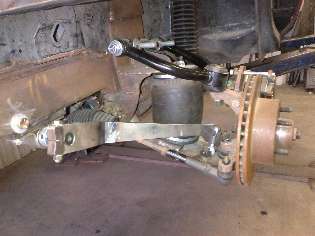

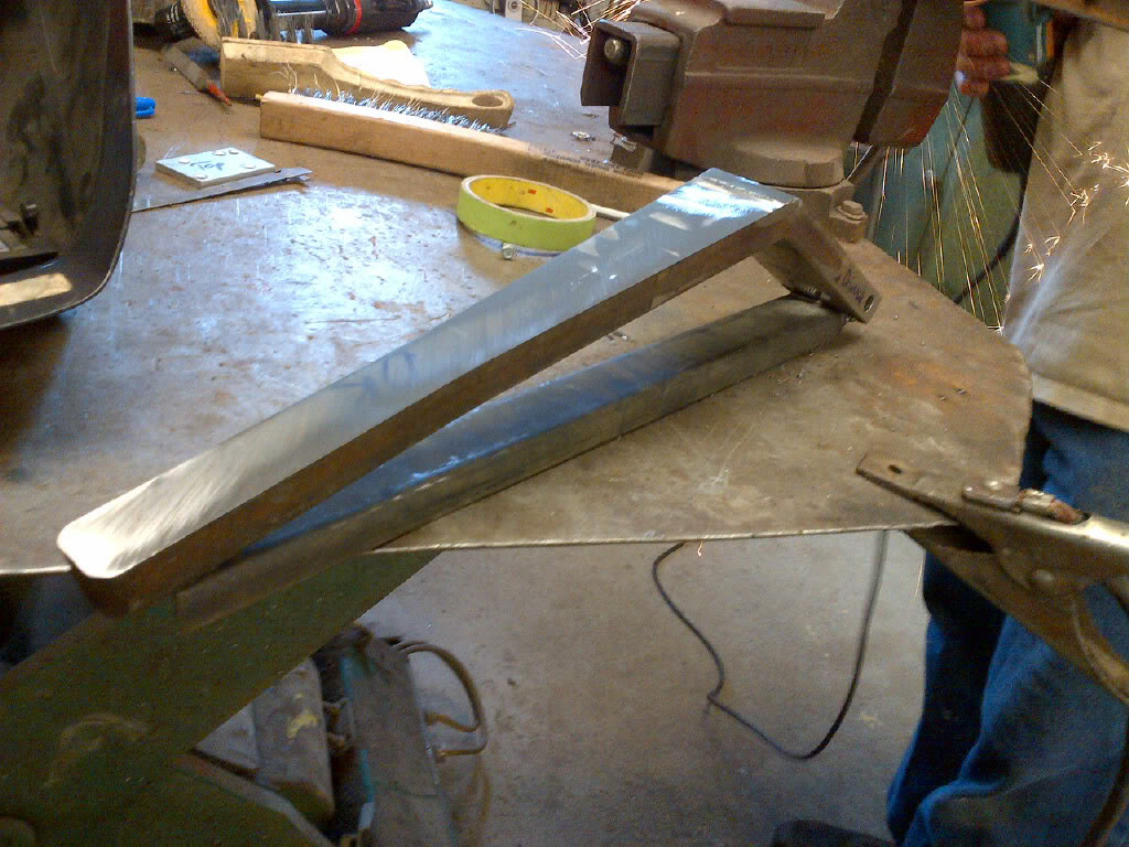

Finally some forward motion! We got the sway bars finished last night. These are stock car type arms with a 1" torsion bar. The hard part was bending the 3/4" arms to the right shape.
