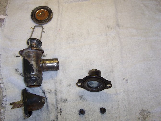

Since we are all answering questions and don't seem to mind ( I hope)
Can someone explain what exactly is used to make the radiator fill tube? It looks like Stock Fiero, but I figure that is too good to hope for.

They are using a Duke thermostat housing, cut off the end and weld it to the 4.9 thermo housing.

Thanks, I never thought the 4.9 was a good looking engine. So I had to do a lot of custom work to make it a little more palatable (for my style). Some of the custom work is obvious, but most is subtle. In my opinion the Valve covers are the best looking thing the 4.9 has going for it. So I had to uncover it from the fuel lines and coolant lines. What is not in that pic is the power steering pump. I like power steering so I had to reroute the belt system to accommodate a new pump location.
falcon_ca
SEP 18, 04:58 PM
How I did mine.
Not welded yet
