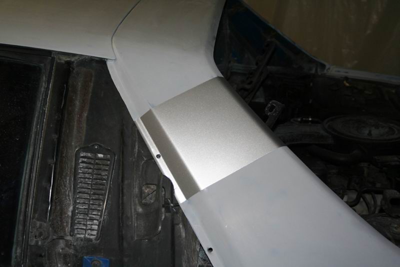

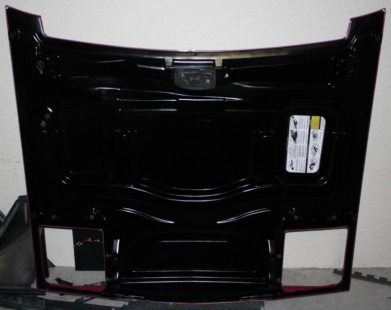

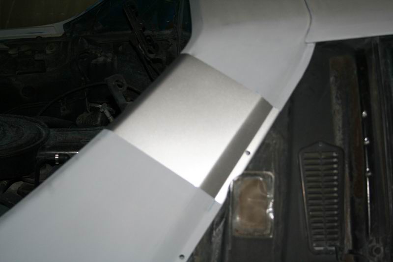

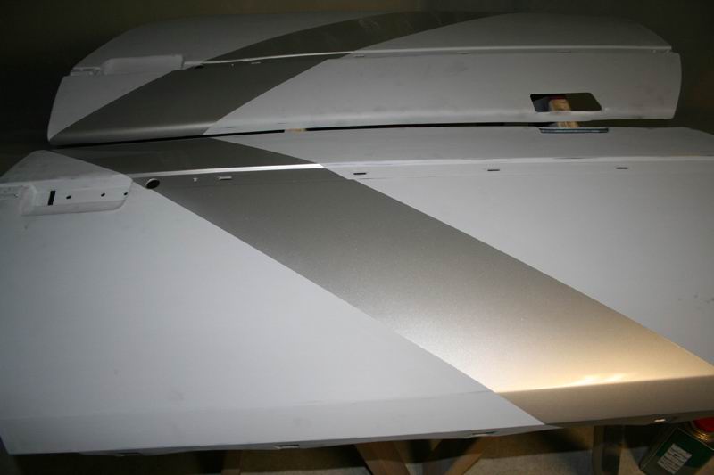

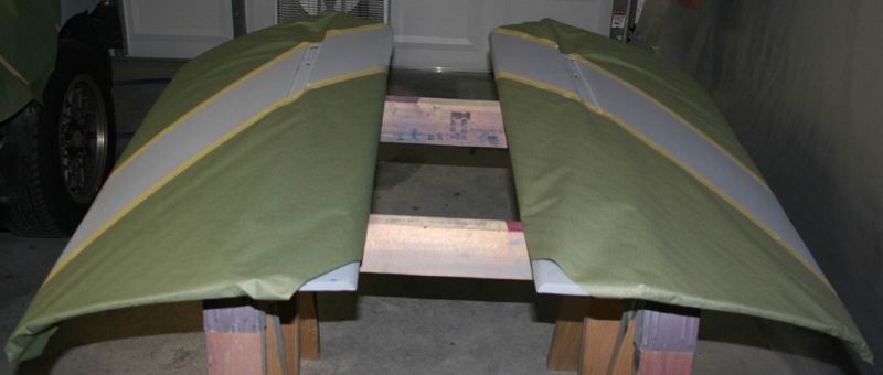

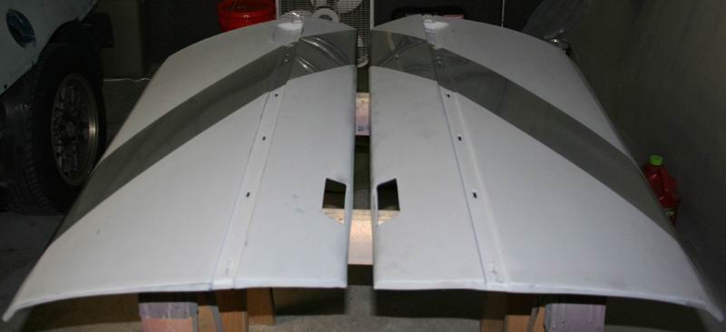

I promised pics so here are pics.
Underside of hood...
Silver stripe masked off...
Silver stripe painted and cleared...
If all goes well, I plan to paint the whole front portion (Raspberry) tomorrow. Look for more pics tomorrow night.

JPW
MAR 02, 10:15 PM
| quote | Originally posted by JimmyS:
Why did you clear the stripe? Also if there will be different colors on either side would you not want to put the stripe on last, to avoid having to tape exactly right?
Not knocking, just asking. Look really good so far.
JimmyS
MAR 02, 11:36 PM
| quote | Originally posted by JPW:
Not knocking, just asking. Look really good so far. |
Since this is my first time painting, I wanted to paint the color that is the lessor of the 3 just in case I messed up spraying. I figured it would be easier to fix the sivler than it would be to fix a huge amount of the other colors. The reason I cleared it is because I am spreading the painting out over several days. According to the spec sheets on the paint, it must be cleared within an hour of painting. I fully understand that I may not be doing this the most efficient way there is but the end result should be the same. As I get more experienced I hope to be more efficient.[This message has been edited by JimmyS (edited 03-02-2009).]

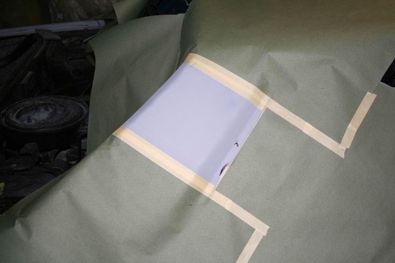

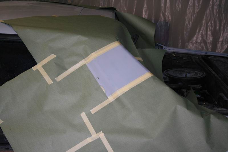

JimmyS
MAR 02, 11:41 PM
Have you ever had one of those days where even the simplest of tasks don't go right? Things you dont even think about doing like picking up a glass or walking. Seems like everything I did today turned into a chore or just didn't go right. In light of todays events, I decided that it may not be the best day to spray a car. So I decided to spray it tomorrow. I did however get it all masked off and ready.
It is supposed to drop down into the 30's tonight so I may not spray till later in the day when it warms up.
