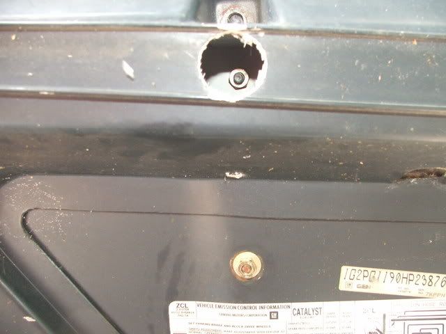

Ouch! Guess you didn't know that you could just have relocated the wingstand stud to the GT hole and not cut up the decklid. For those doing this in the future late model wing stands have three holes, the outer set is for the GT and inner set for the Coupe.

Problem is, I was unable to relocate the studs without the very real possibility of ruining the stand, so I deemed it easier to just drill the new holes.

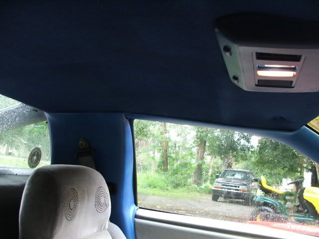

Anyways, I managed to finish painting the interior parts that are going to be staying throughout the interior swap.

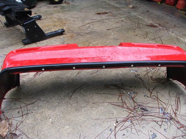

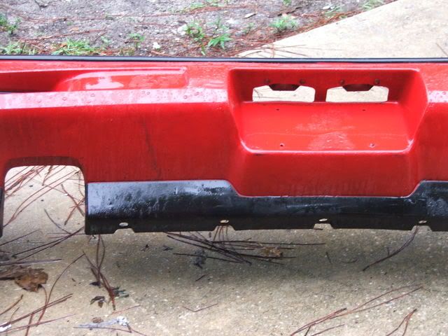

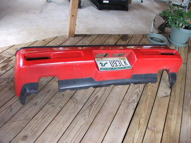

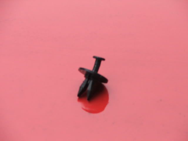

As there are a couple of people who are interested in my original bumper, I took the time to pull it.
As I did not detail the process when I pulled the one from my GT, I shal endeavor to do so now.
You can actually start pulling in any of 3 places. I started with the boottom and worked up. The rear bumper is held on at the bottom, top, and both sides. The top and bottom use the same fasteners. I do recommend that you go to your local autostore and get some extra, as I doubt that all will be salvageable.
The bottom is held on by 7 fasteners.
The top is held on by another 7 fasteners. To get to these, you will have to pull the tail lights.
Then, take out the 3 screws holding the wheelwell liner to the inside of the bumper, and the 2 that hold it to the fastback/notchback section. Repeat for the other side and you are almost done.
The last part is rather simple, unplug the license plate lights. The bumper is now able to be pulled off.

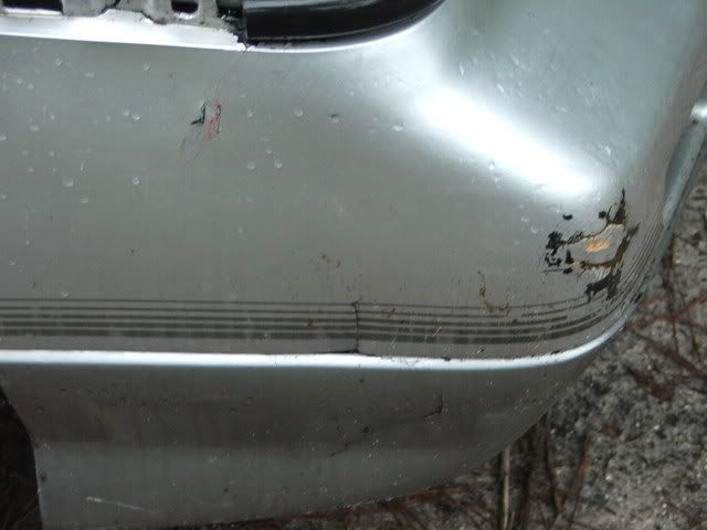

I have now also installed my GT bumper which has a few issues.

love this thread ill be doing the conversion shortly i too changed my interior im glad im not the only one to do it. i used the same paint i can give you tips donw the road when or if you paint the center console and dash. i also redid the speedo cover and the map lights up by the sunroof. i used a black vinyl paint with a light overcast of metal flakes.

Glad to see someone else has had good results with the color change Stealth. I have everything that shall be kept a nice electric blue. I have to find a good condition lower door trim piece for my passenger side, as mine is cracked rather horribly. As to the dash ,center console, and computer cover, I shall be installing the PISA Wraparound dash conversion. It shall be covered in the same electric blue that MrMike offers for his seats. I also have to decide on wether I want to go with the Euro Door panels with same color, or go the MrMikes route with those as well. For that I hope to see if people can send me some pictures to help decide. Hopefully I shall be able to start on this again once I find out about a promotion at work. This is where I wish I had some massive inheritance or won the lottery . Well if wishes were fishes I'd still go hungry.
