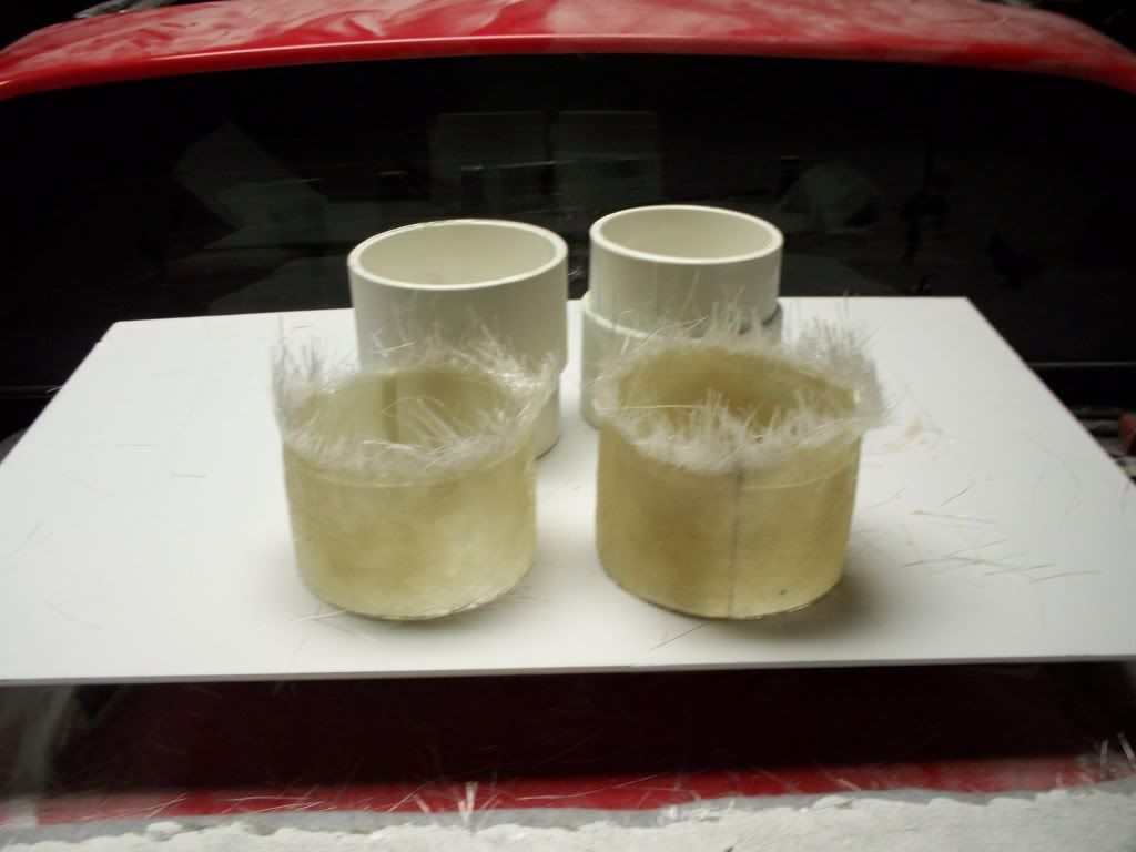

OK here is an update on the rear Facia. last night I work on it for a little I was able to layout some of it.
today I am going to go get more fiberglass for this weekend.
I made the light buckets using pluming copplings as a mold and I used a strip of pvc to use as a buck for part of the rear.
here is a stereo trick that also works on fiberglass for car parts also I used fleese as a backer to get the shape I need to glass in
just use spray adhesive and lay it out to get the main shape then glass over it you can remove it later or use ressin on it to give it more body
for the part. it just helps to keep the glass in the shape it needs and will not let it fall off.

Hey...I thought of using the fleece stretching for body panels/contours just a week or so back and have been scratching my head ever since, wondering why no one did it. It's going to be a lot easier than making a big foam mockup, IMO. I definetely have to see the results of this!
