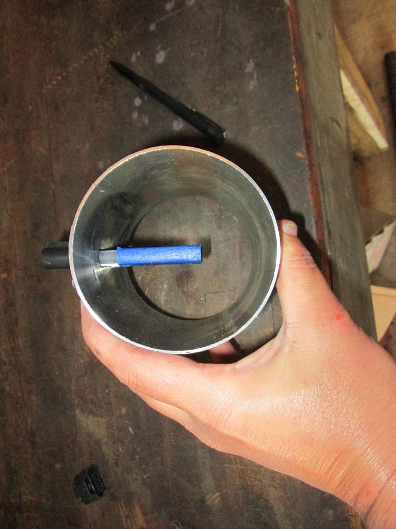

I started off with a section of 4" tubing and made a shelf so the MAF would have a flat space to mount:
Here is the inside of the tube with the MAF sensor installed:

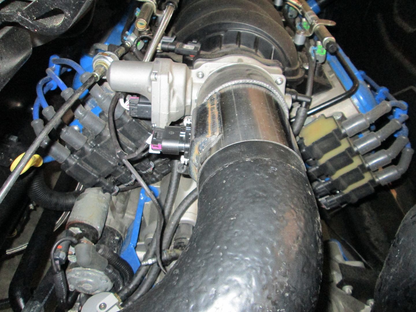

I welded to the tube section to the original air intake tube (fewer silicone couplers and clamps). Once the welds were smoothed, I sanded the tube and applied some more truck bed coating to it:

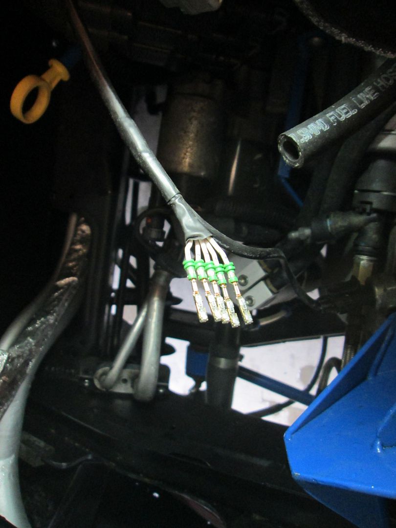

While letting the tube dry, it was time to swap out the connector end since they were different. The good news is it literally is just swapping out the connector end. Here are the two connector ends (LS2 on the left, LS7 on the right). Each one was opened up, the terminals released and pulled out of the housing:
Here are the terminals from the harness:
The terminals are flipped between the two MAF sensors, so I just had to install the new connector flipped over. The really nice part is the terminal retaining latches are flipped as well between the two housings, so I didn't even need to rotate each wire 180 degrees. Just slide off the old connector, flip the new connector and slide it onto the terminals in the harness... doesn't get much easier.

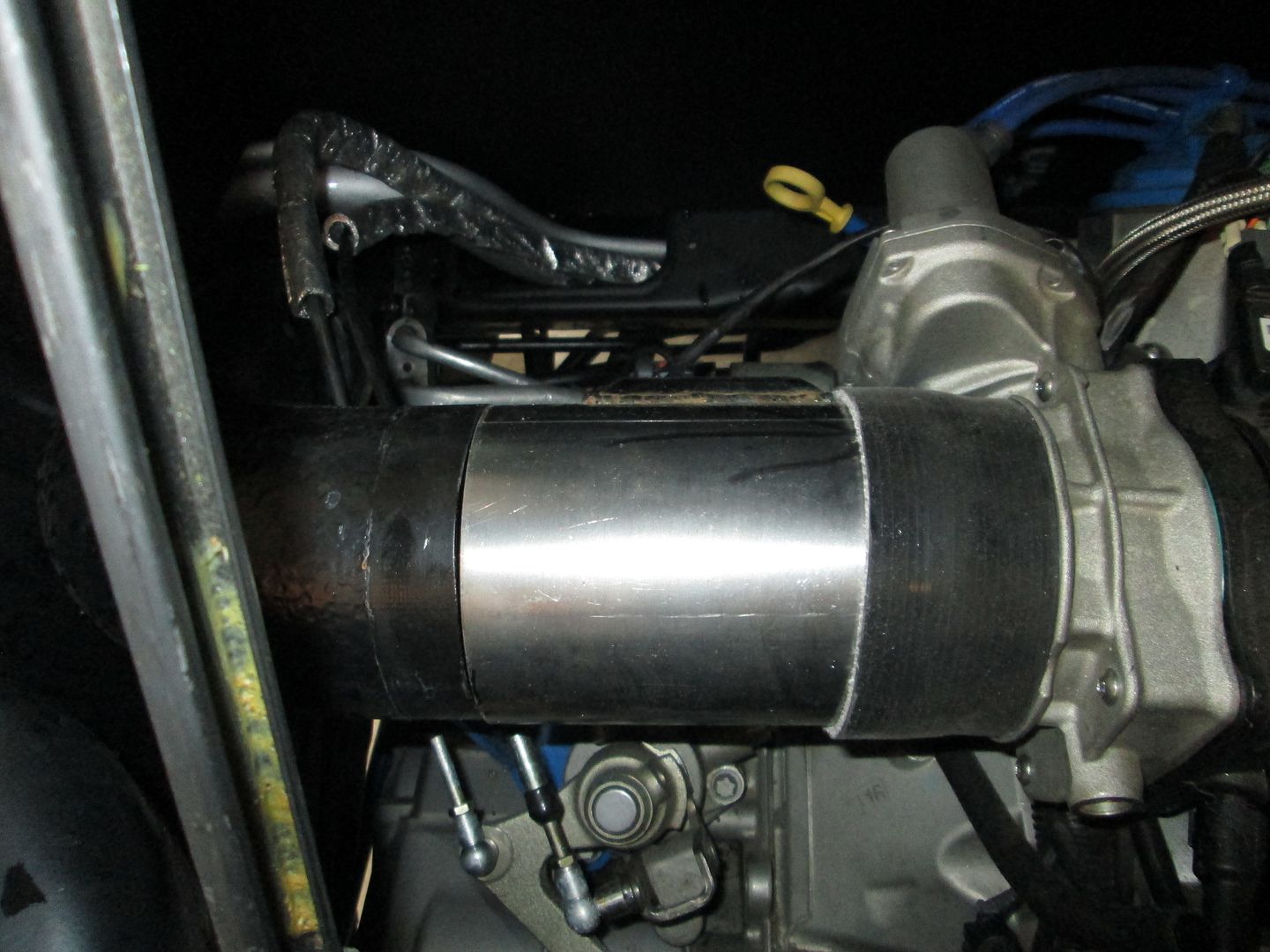

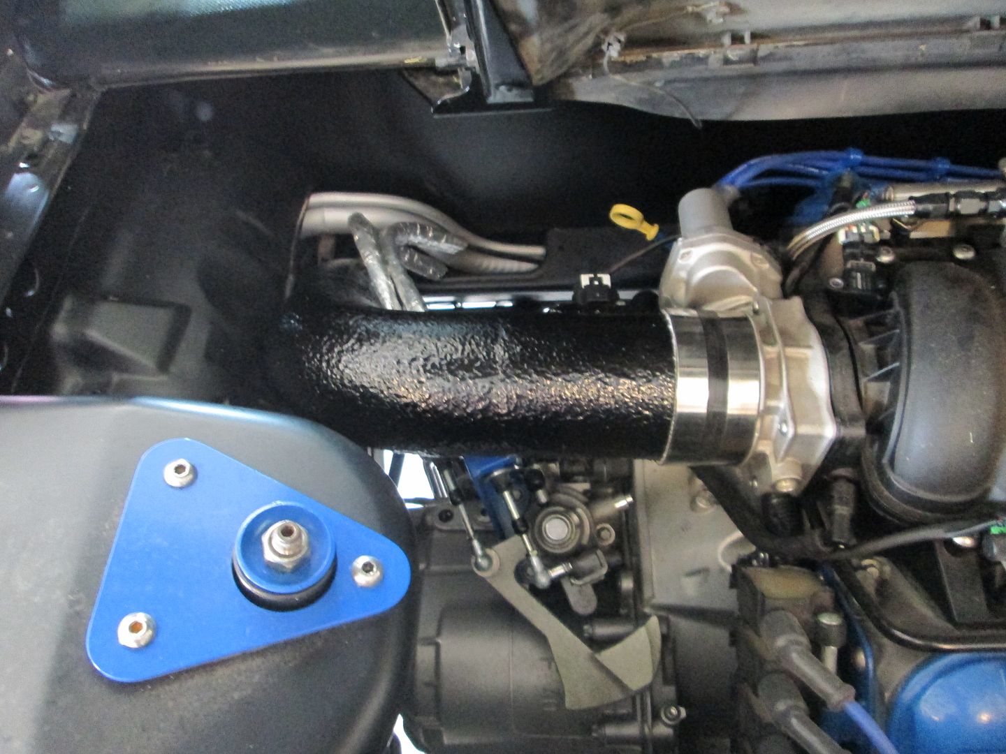

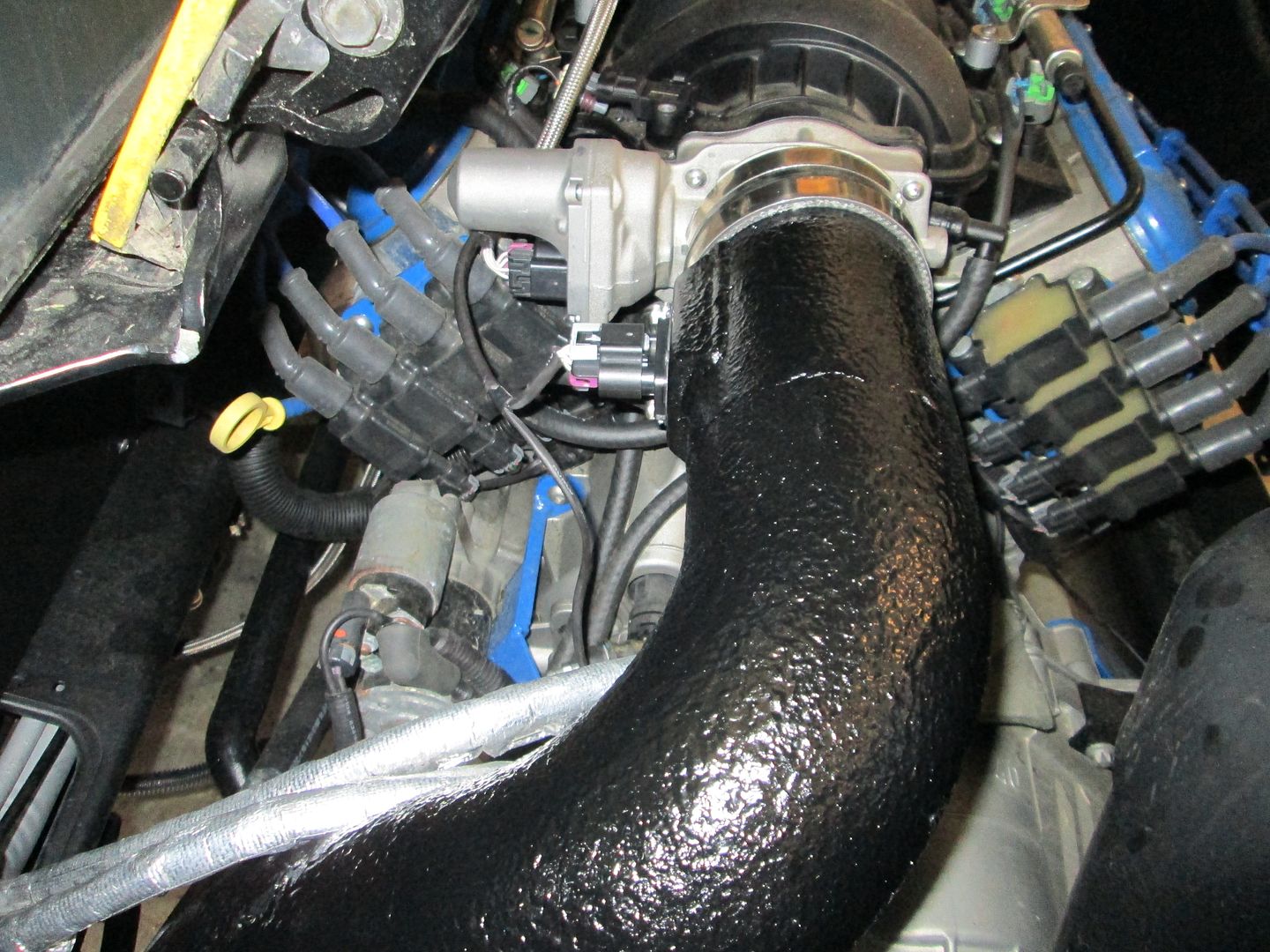

New MAF sensor and modified intake tube are now installed:

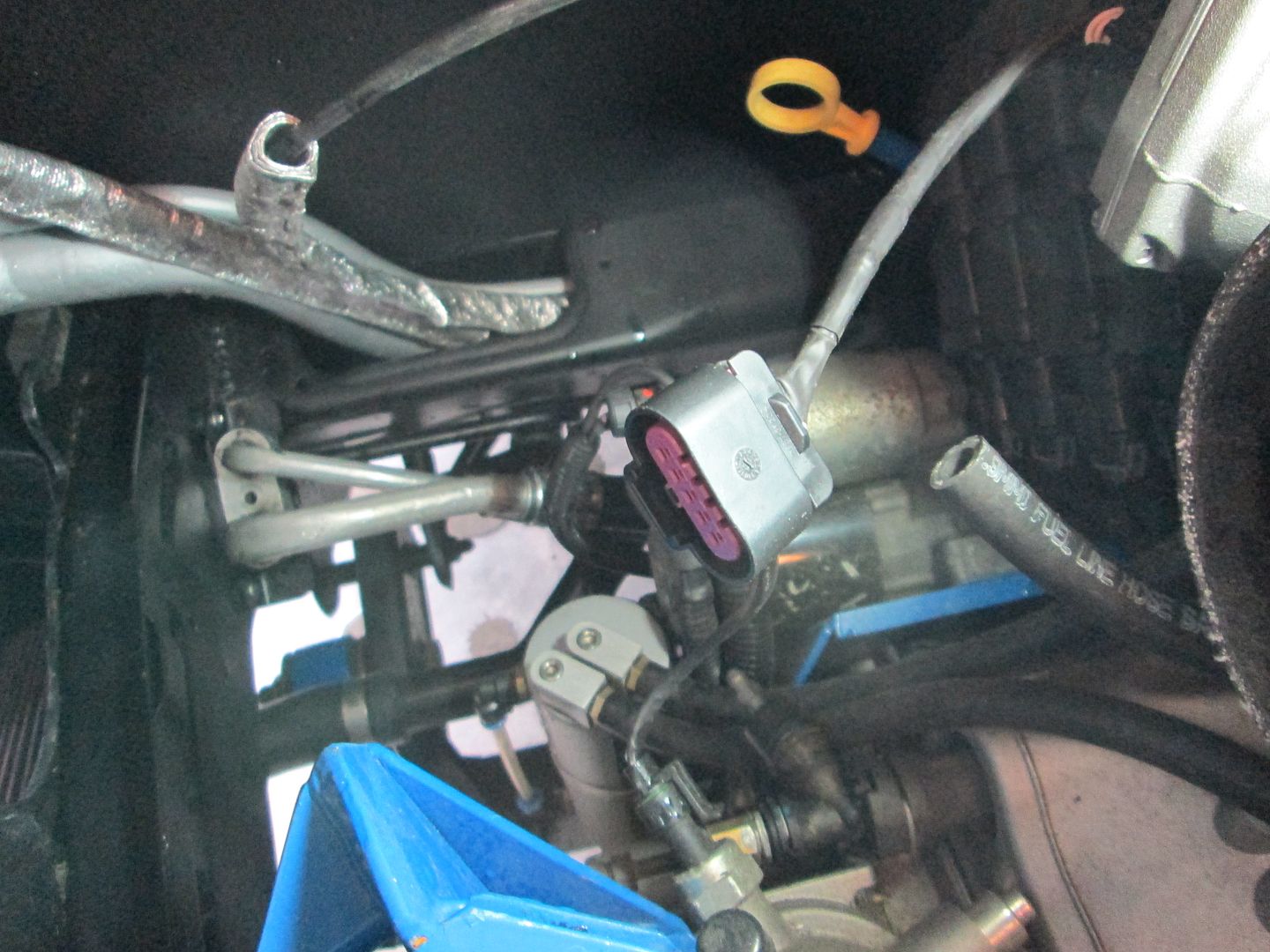

While the TB was off, I drilled the MAP sensor hole over sized so I could switch back to the LS4 MAP sensor. I ordered the adapter harness, but got an email that it was back ordered. So I ordered just the LS2 MAP female connector end and I can make my own adapter harness with the LS4 MAP pigtail that I removed when I did the harness. Here is a picture of the LS4 MAP sensor installed:

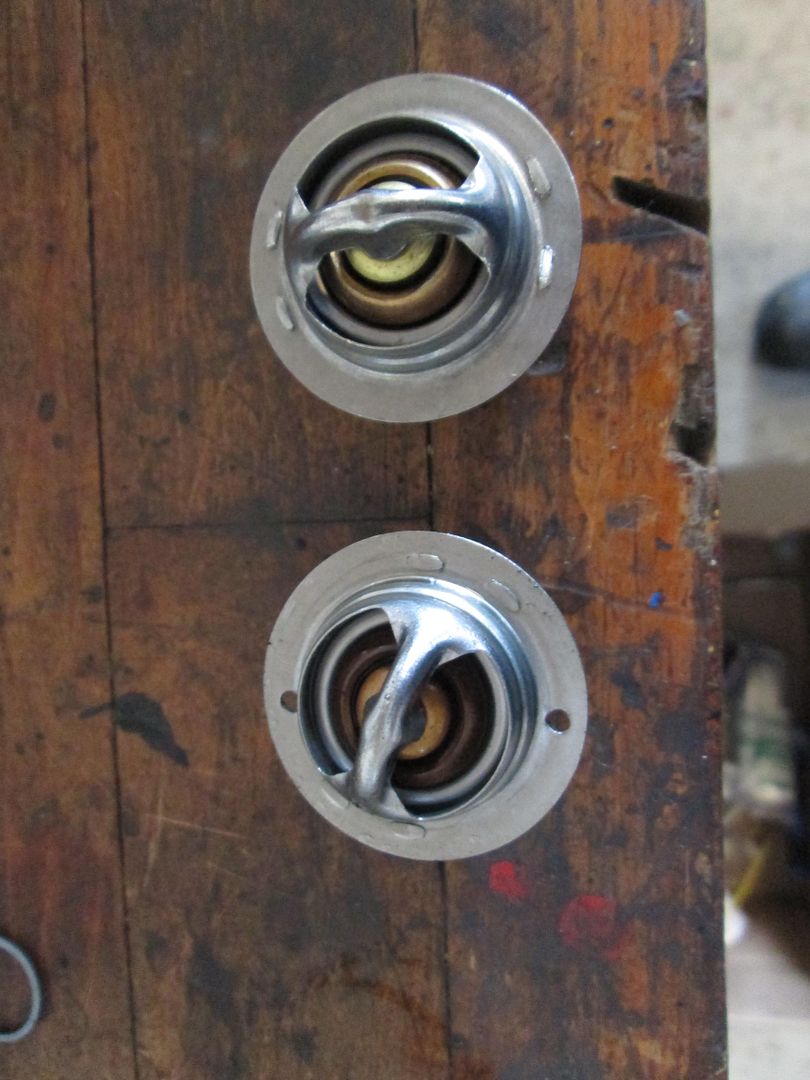

While still working in the engine bay, I removed the thermostat that I had previously drilled a couple of holes in. It was taking the car too long to get up to temp and on cool mornings it wouldn't get much above 165 degrees.

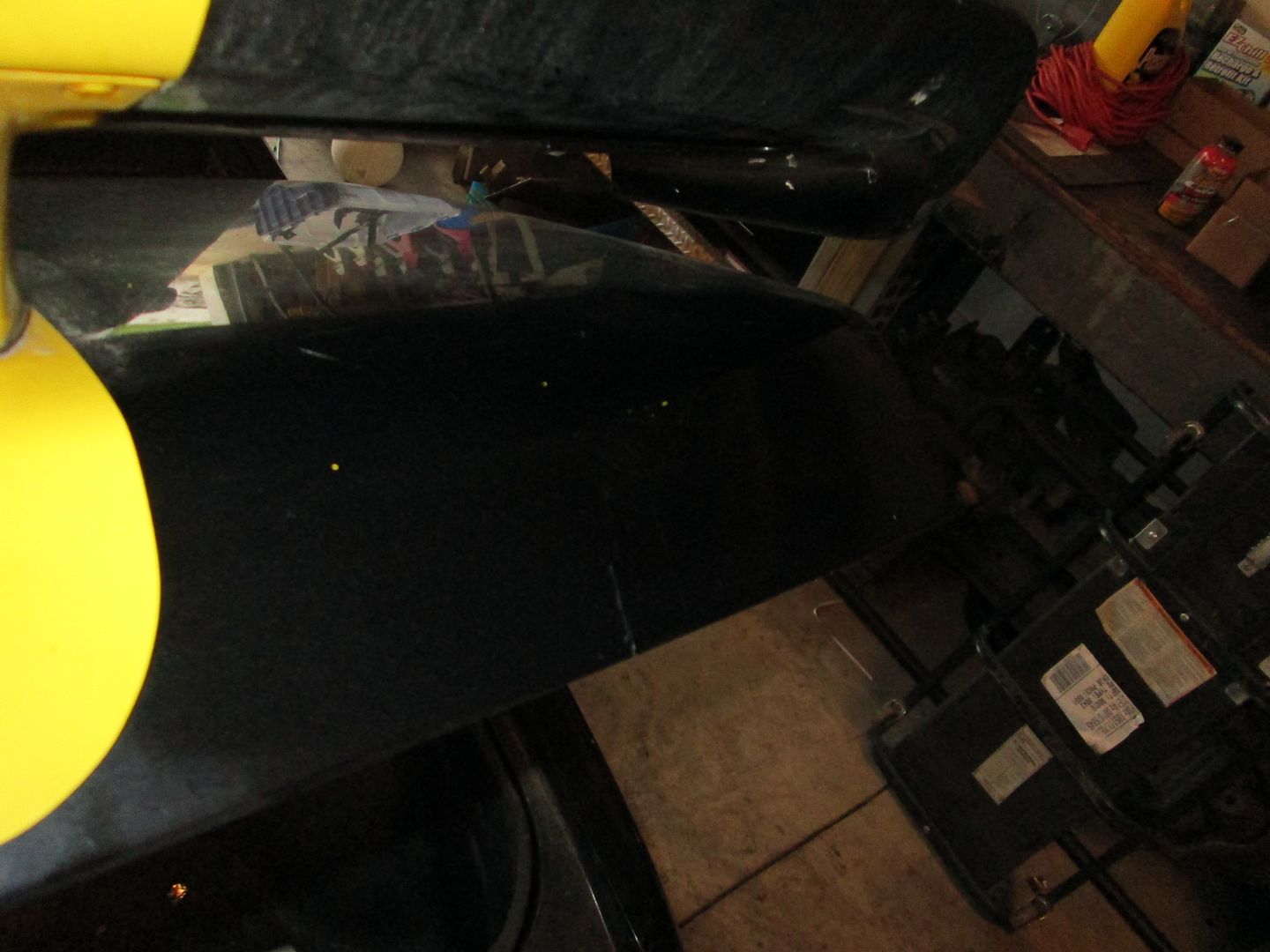

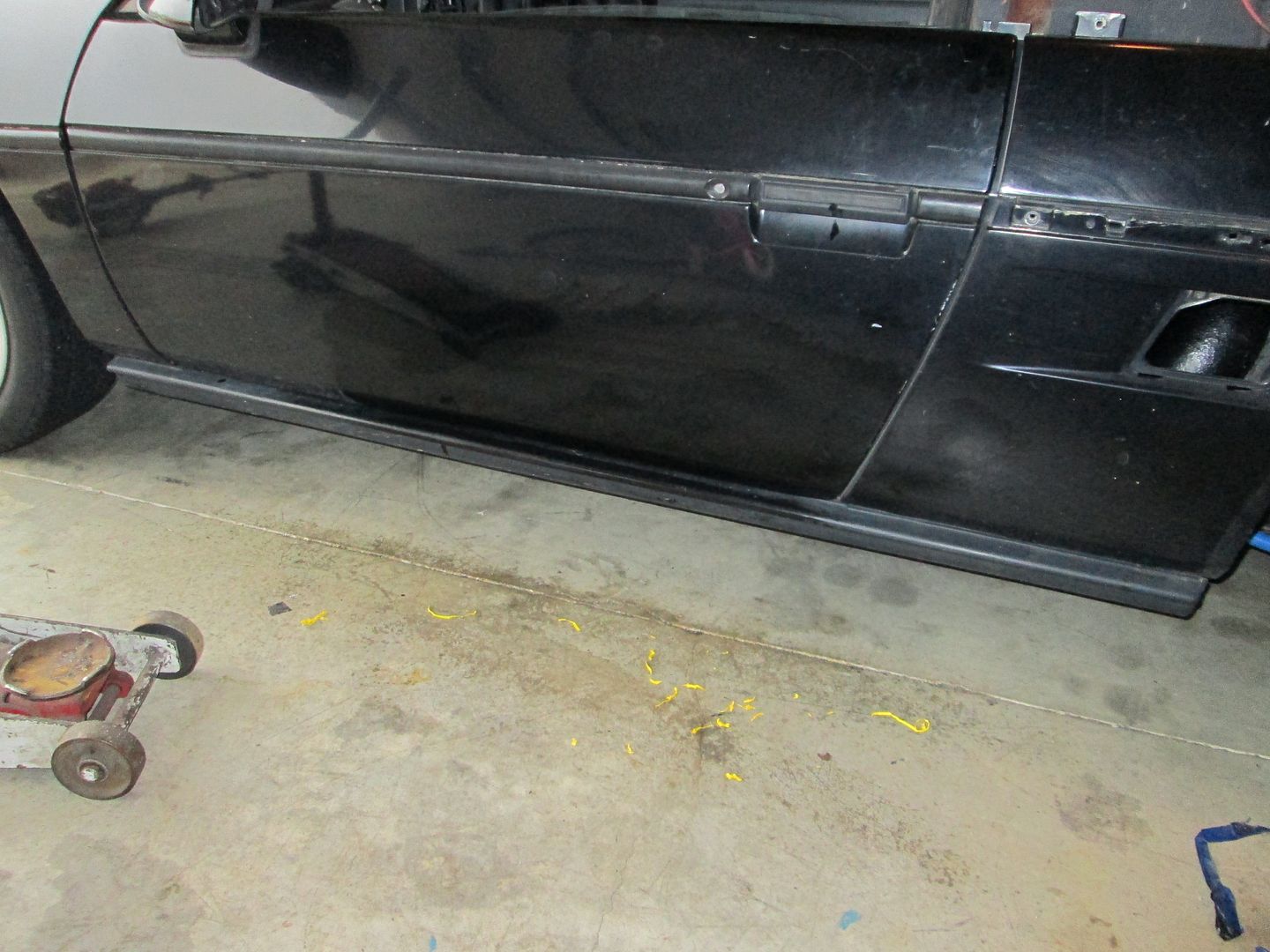

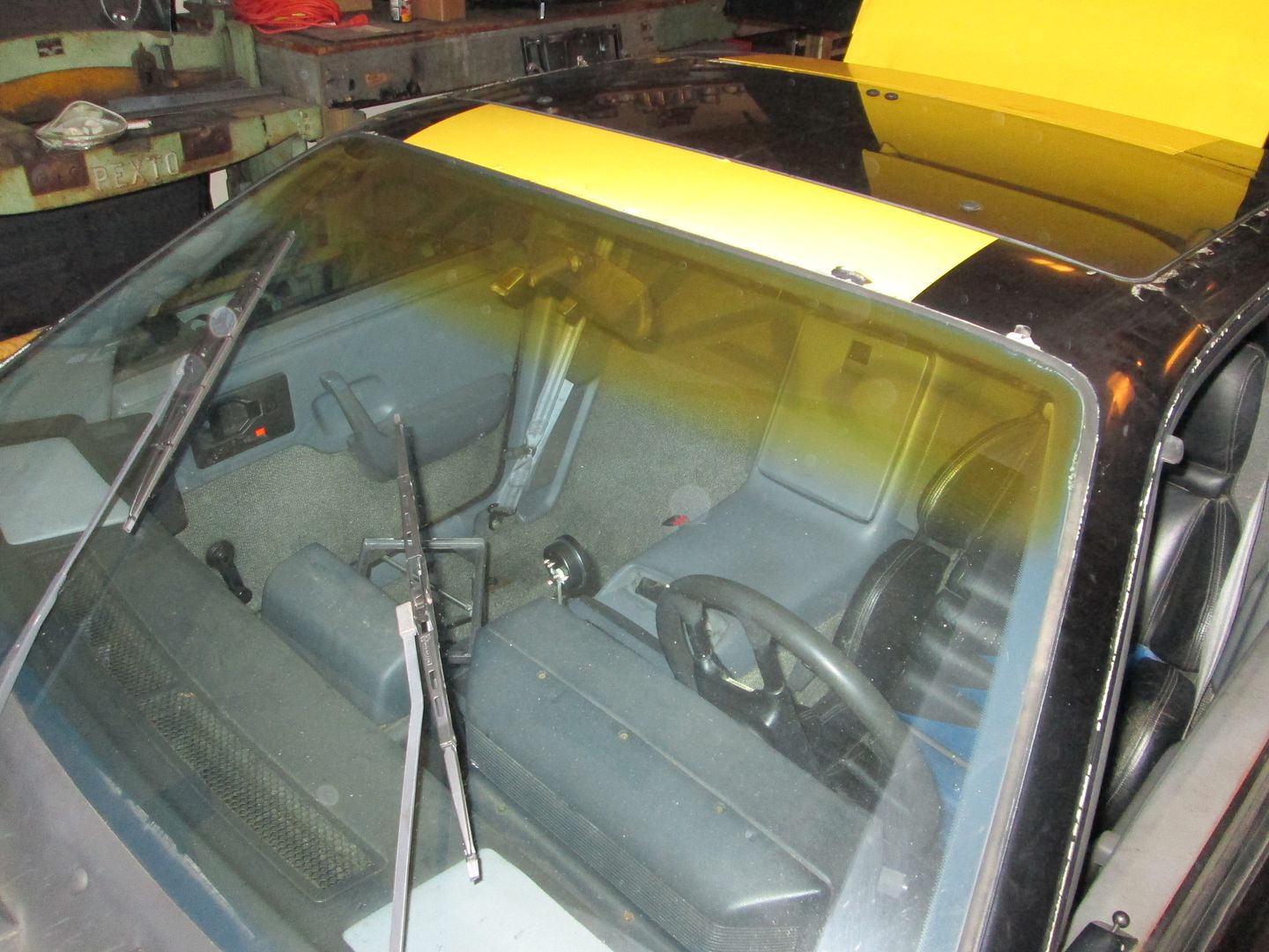

Another key project for this week is to make all the yellow disappear... not a fan of it at all. Makes the car look too "ricky racer" and draws too much attention. Time and $$$ are just not in the cards right now to get the car painted vodoo blue, but I can make the yellow disappear. First step was to remove all the stickers (Pontiac, Formula, Fiero):
Later this week, some Gunmetal Grey Plasti-dip will arrive and I will use it to cover the yellow painted surfaces. So the car will still have the wide stripe (not really a fan of it either), but at least it will be in a more subtle color and when it is time to paint, the plasti-dip will just peel off.
