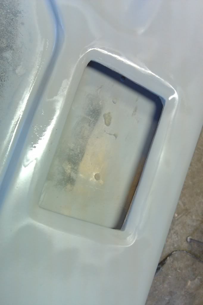

The door panels are 95% complete. A few more areas to sand then prime & paint! And... a nice little surprise...

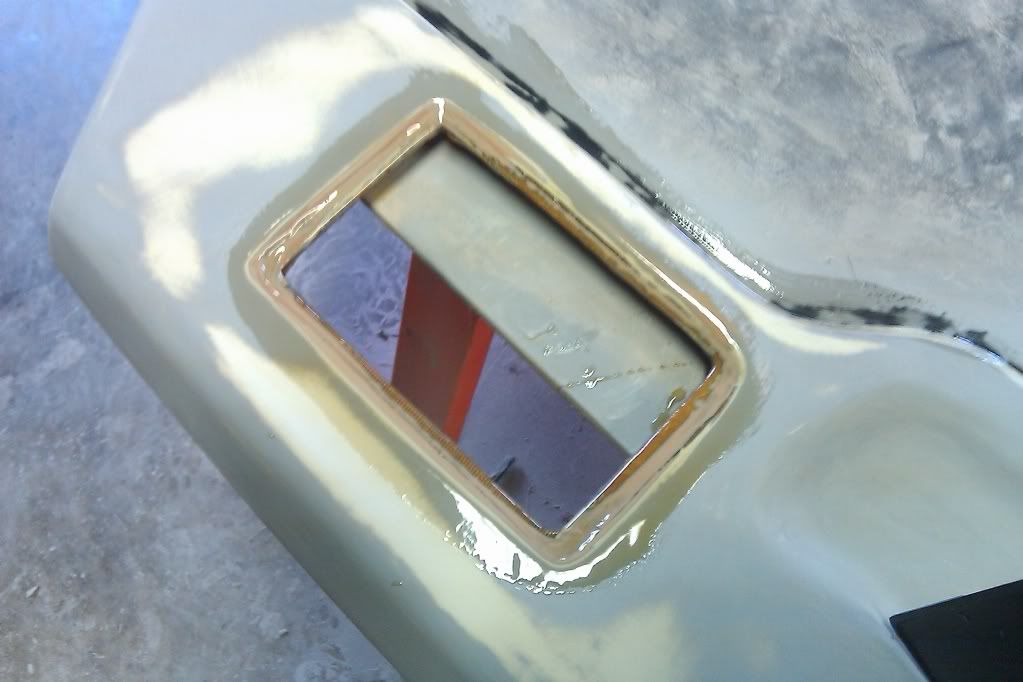

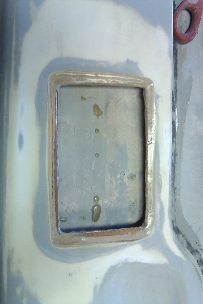

This was the last areas of the drivers side door panel that needed work. WHAT A PAIN this has been! After all the snading was finished I found a few little holes and uneven areas. I mised some resin together and lightly spread over the working area. The nice thing about the resin is that it smooths out and creates a rock hard surface to work with. A few passes with the resin and I'm almost done!
With a shot of primer / filler. Just a quick addition of body filler, sanding and primer and she's all ready for paint

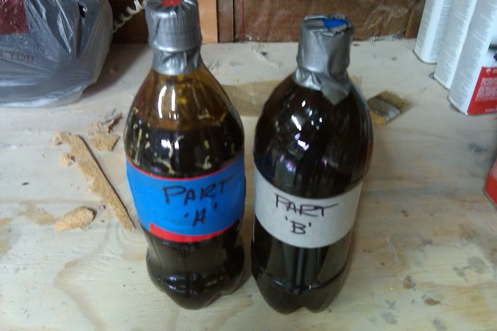

What's the surprise? Check this out! SourMug (aka Nolan) was kind enough to send me this...
No... it's not booze... Although I should definately send him some for his kindness and generosity. What is it? It's expanding foam The same stuff he used on his door panels and interior redesign!

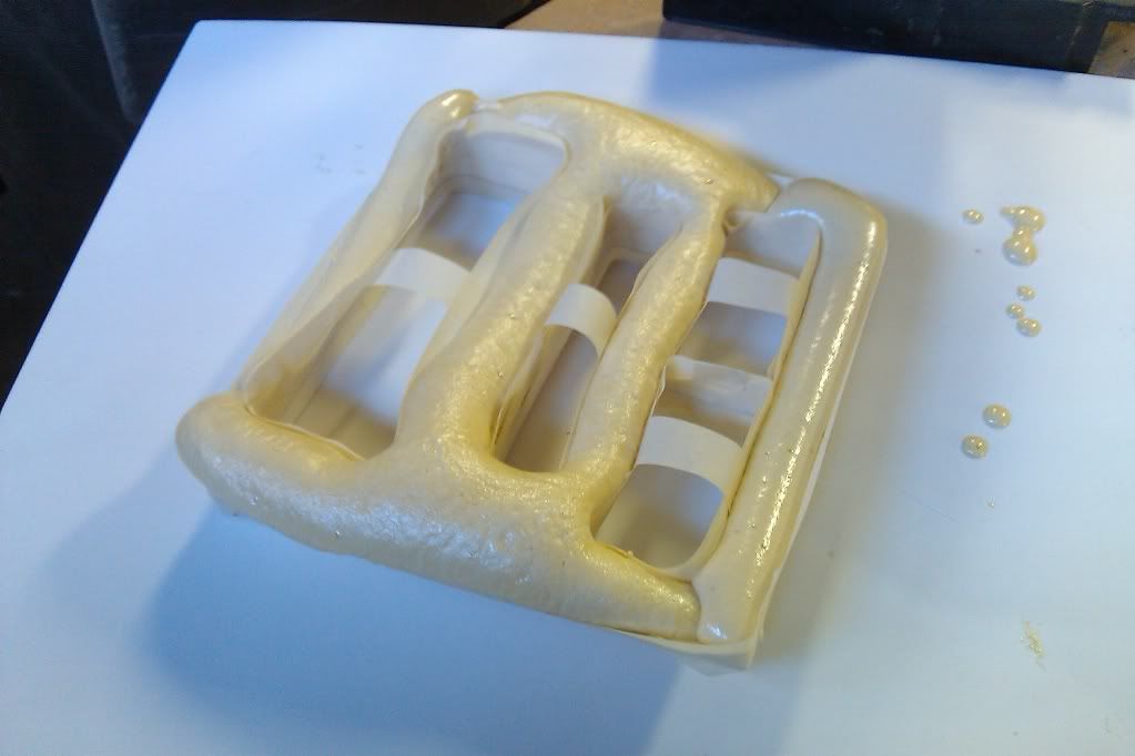

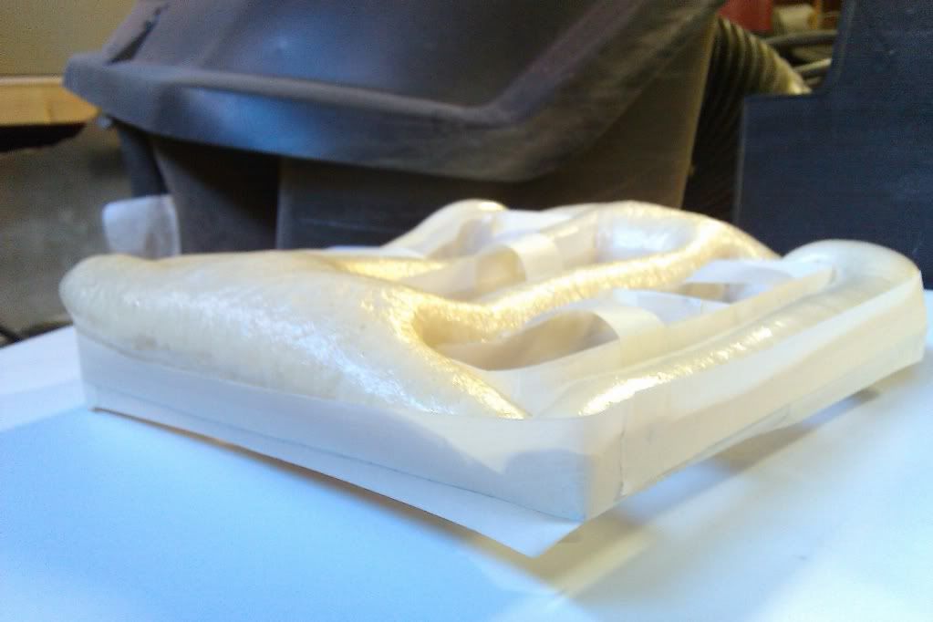

I decided to give it a go and start testing with it. I was very frugal. I remeber Nolan using it on his door panels and how the foam expanded and just kept on going and going and going...

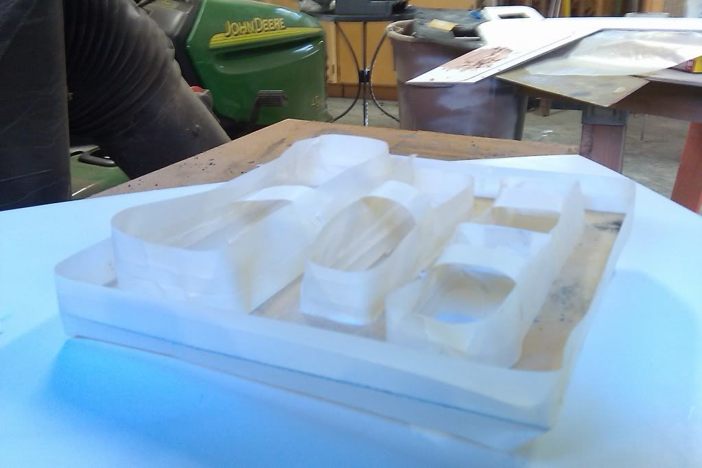

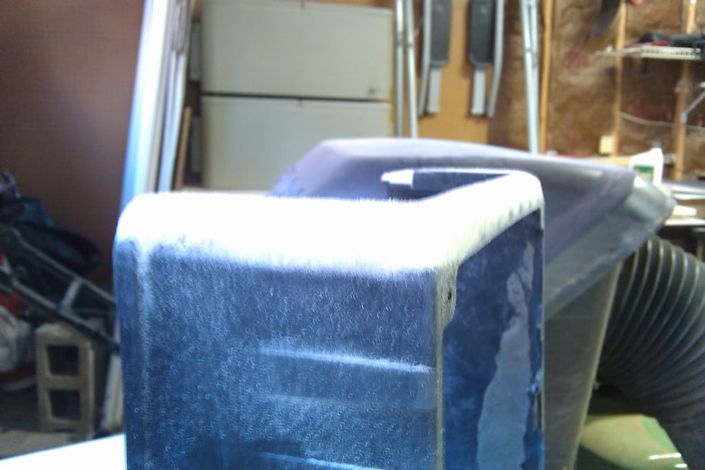

Using a piece of fiberglass I precut and sanded down... I masked off the edges with tape

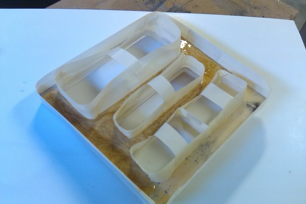

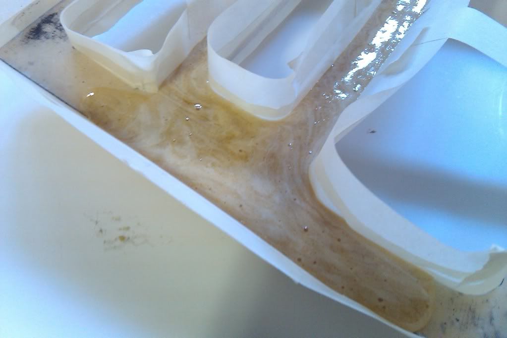

I then poured the foaming agent

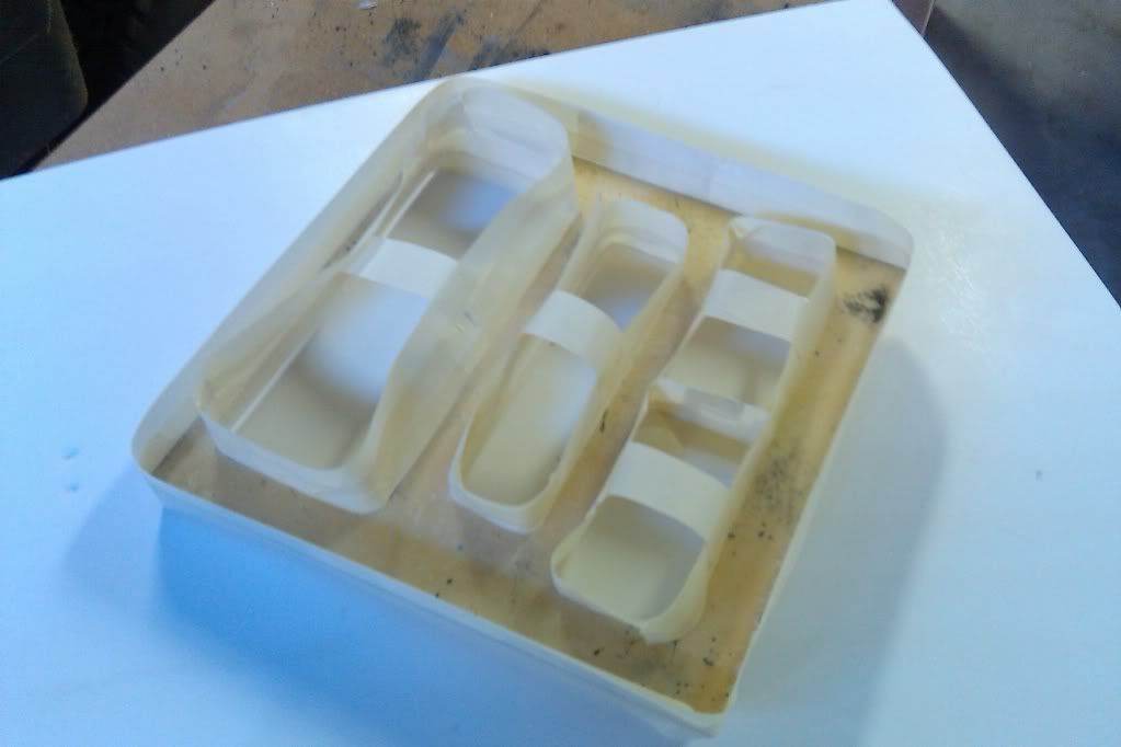

Then sat back and watched the magic...

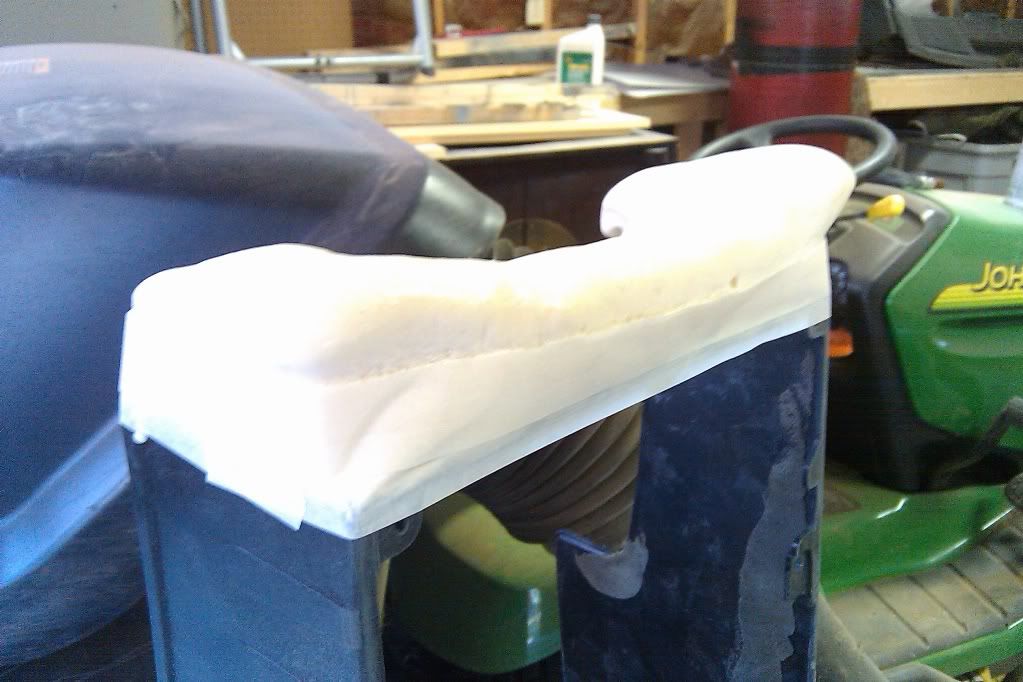

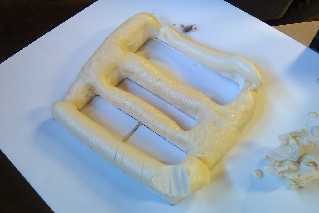

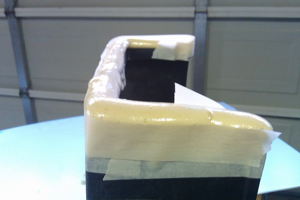

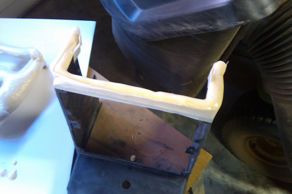

I did the same thing to the console skeleton(?)

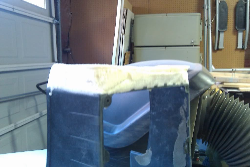

I then started forming the foam with a little saw and sandpaper - this was only a practice run. The foam is very easy to cut and sand. The best part (what Nolan told me) you can fiberglass over the foam and the resin will not eat away at the foam
