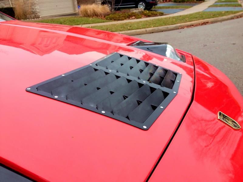

can you weld fasteners to the underside of the grill so they are concealed?
doublec4 NOV 16, 09:57 AM
They would have to be aluminum fasteners. Also, the radius of the weld around the stud would have to be tightly controlled so that you could counter-sink the holes in the hood. Otherwise the vent will not sit flush with the hood because the weld would interfere.
It could be done but I don't think it would be ideal for this situation. I understand that exposed fasteners are not for everyone, however, I do feel that it gives it that more of that race look. You can always paint the heads of the fasteners, get black ones, or even get your fasteners anodized if you're using aluminum rivets. It would help hide them.

Well you would still have to cut the holes or else the vent won't sit in the hood. The louvers sit below the mounting flange, but you could use the double sided tape under the flange I guess. It would just stick up too much in my opinion.

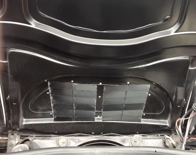

Just a few more pictures for the records:
As you can see, it looks pretty good from the underside in my opinion. It also sits nice and flat to the hood, no lifting edges.
