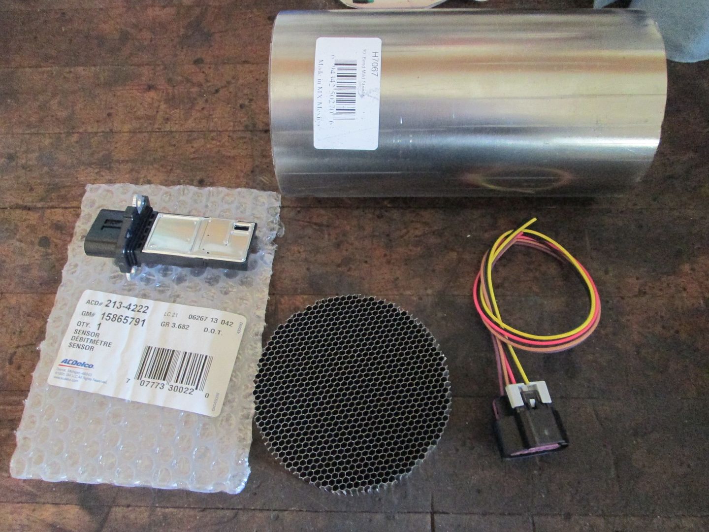

The car is still pulling vacuum at WOT with the MAP sensor dropping from 98 kpa (ambient pressure) to 94.5 at 6800 RPM. First step was to swap out the filter for a larger 8" cone one:
Unfortunately, the filter change didn't do much to remove the WOT restriction... so the next smallest item is the 85mm MAF. The 4" air intake necks down to 85mm at the MAF then enlarges back to 90 for the throttle body. Since I already have the 4" intake tube, I can remove the current MAF, extend the 4" tube and install a LS7 card MAF. Once that is done, if it still pulls vacuum, then I will live with it. Here are the parts for the MAF conversion (I will have to fabricate the mounting flange for the card MAF):

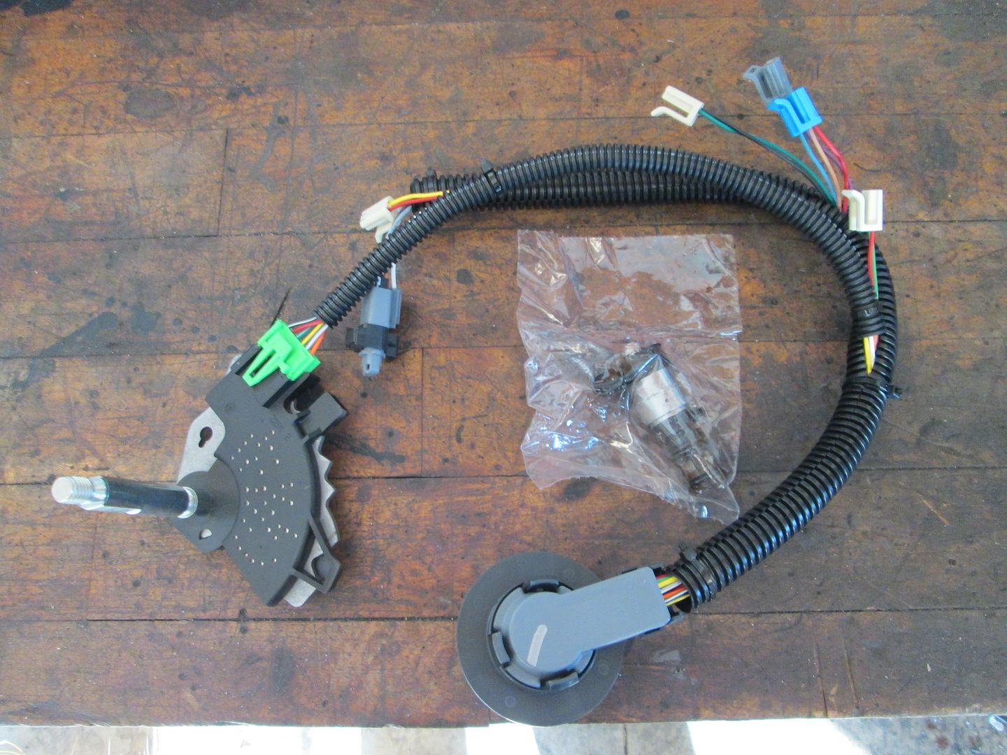

Another issue I have been messing with is the TCM range switch. I found a wiring oversight in that I didn't wire up the P/N wire to the ECM and just did the 4 wires to the TCM. Added it and it still didn't like it switching from D4 to N via the clutch pedal. Either the DBW throttle would shut off (pushing the pedal did nothing) or it would put the car in low power mode which limits throttle input to about 5%... not much fun to drive. If I keep it wired for D4 all the time, it works great, but sets a check engine code that I can't turn off with HP tuners. So my last plan of attack is to wire up the actual range switch in the 4T65e-hd and manually switch it between D4 and N (or P) in the console area (where the power mirror switch normally goes). Then I will manually put it in P or N when I start the car, then put it in D4 for the actual drive. I think it will also work for a Valet mode if left in N or P as it will likely be in reduced power mode... not that I let a lot of people drive my toys.
So far DoD is still unresponsive. I suspect it is the transmission pressure solenoid doing it. I have tried a couple of resistor setups and it still sets the code. With the code present it puts the transmission in max pressure mode which might keep DoD from kicking in. So I purchased an actual transmission pressure solenoid and will wire it up in the console as well. That should eliminate this code. To address the range and pressure issues, I purchased the range switch, internal harness and pressure switch for a 4t65e-hd:
The only other code is the one for the ISS (transmission Input Shaft Speed). I can't turn it off, but I also don't know how important it is yet. There is no easy fix for this one besides drilling the F40 case and installing a sensor to look at a gear on the input shaft, but the teeth don't match and the manual transmission input shaft doesn't behave like an auto input shaft... so even if I went to all that trouble it still might not be happy and set the code. I am not going to mess with this one until I get past the other ones and see if DoD is happy or not. A sane person would have given up on DoD a long time ago, but I fell off my rocker a long time ago.

I am not very knowledgeable of the 4T65e-HD transmissions and their various differences. What I can share is the pressure control solenoid was 2003+, the range selector covers 4T60E and 4T65e so it should be the same, and the internal harness I used was 2007-2010 but that might just be due to the connector ends.
The input shaft on the auto can see 0 RPMs in every gear if the vehicle is stopped. It will also see 700ish rpm with the car stopped and in neutral. The manual transmission input shaft will see 0 RPM when stopped and the transmission is in a gear, but if you put it in neutral and release the clutch it will see idle RPM. Neither of these are the issue. I had the car wired to show N every time i pressed the clutch and I think the TCM throws a fit when it sees N while the car is in motion and kicks it into low power mode to prevent damage from doing neutral drops or other abusive antics. I suspect for everything to work right, the transition from N to D4 must happen while stopped or at single digit speeds.
Since I am using the 4 speed shifter and it has the reverse lockout lever, I could put the clutch switch on the lockout lever. When in reverse, the lockout lever is pushed down (similar to clutch in) and would break the connection to the switching relay. This would only happen while in reverse and the car doesn't see much speed while in reverse, so it might work. I will try this first since I just need to move the switch from the pedal to the shifter.
