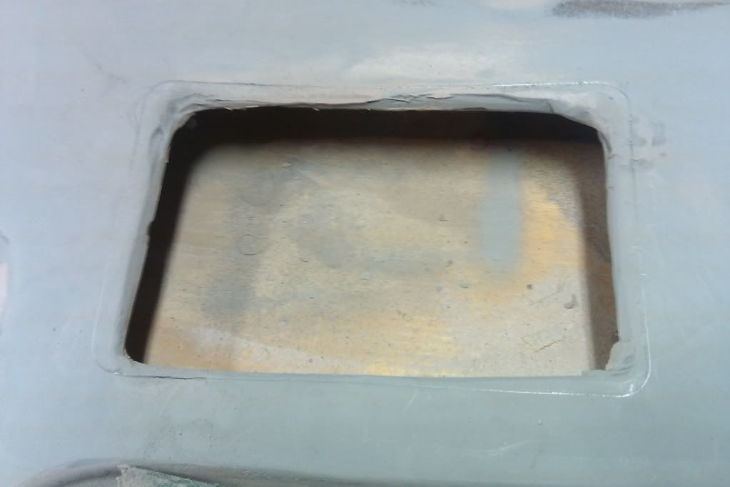

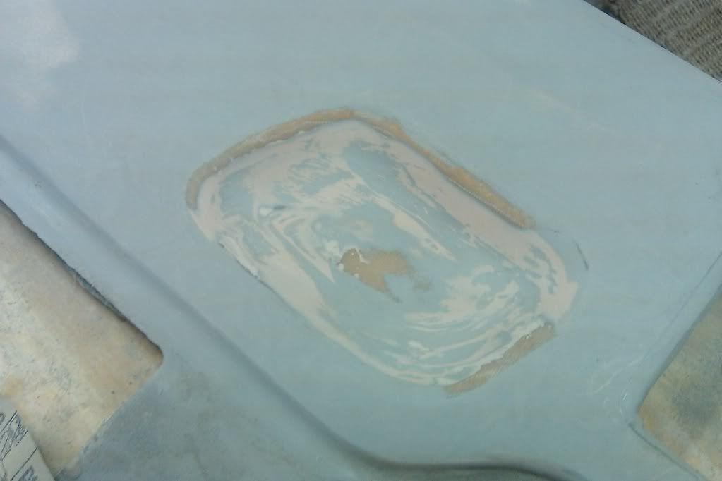

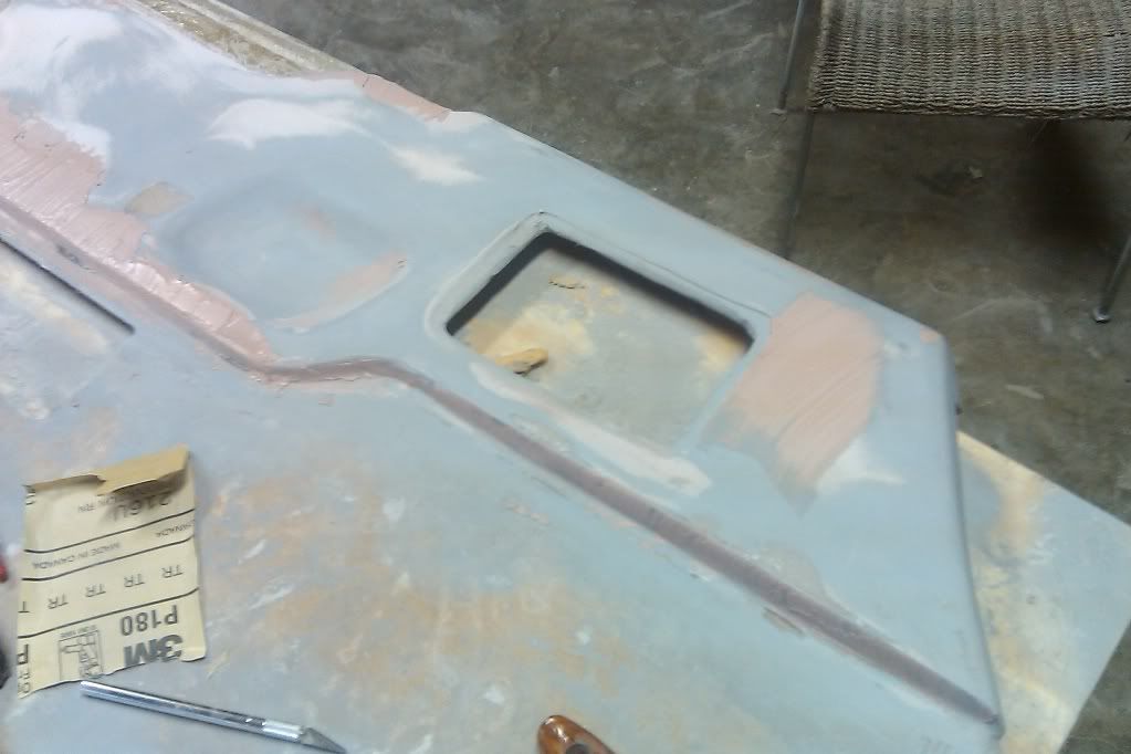

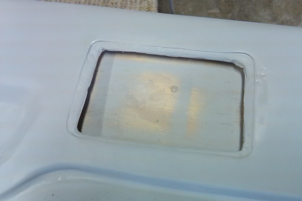

I spent the morning sanding down most of the filler around the door pull recessed area
The door handle plate didn't exactly fit so I had to use the trusted Dremel - Before
After
With primer / filler and awaiting more body filler to smooth and level out
Still more filling and a bit of sanding to do before any paint!
What's next? I need to create the fiberglass backing for the upper part of the door panel, cut / remove said upper part and work a few bad areas on the passenger side panel.

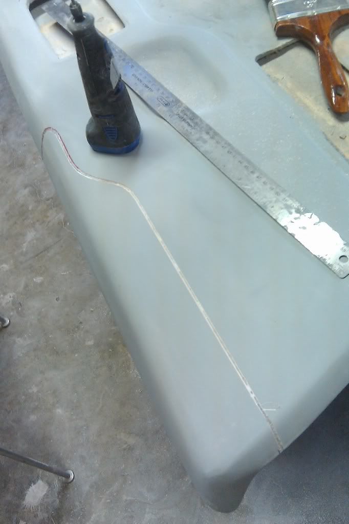

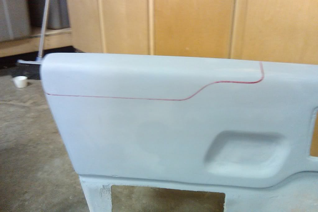

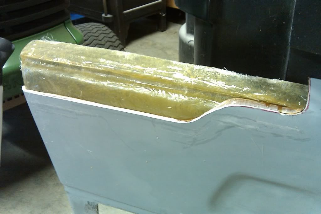

Traced the line for the door panel arm rest
Making sure the lines match up

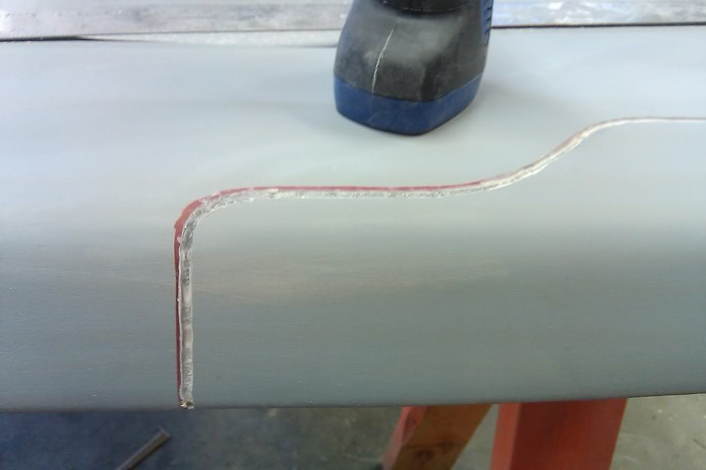

Used the trusty Dremel to cut the beginning line

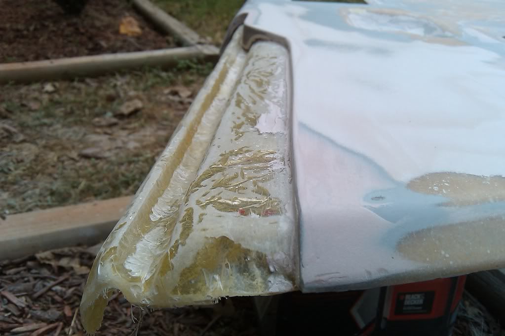

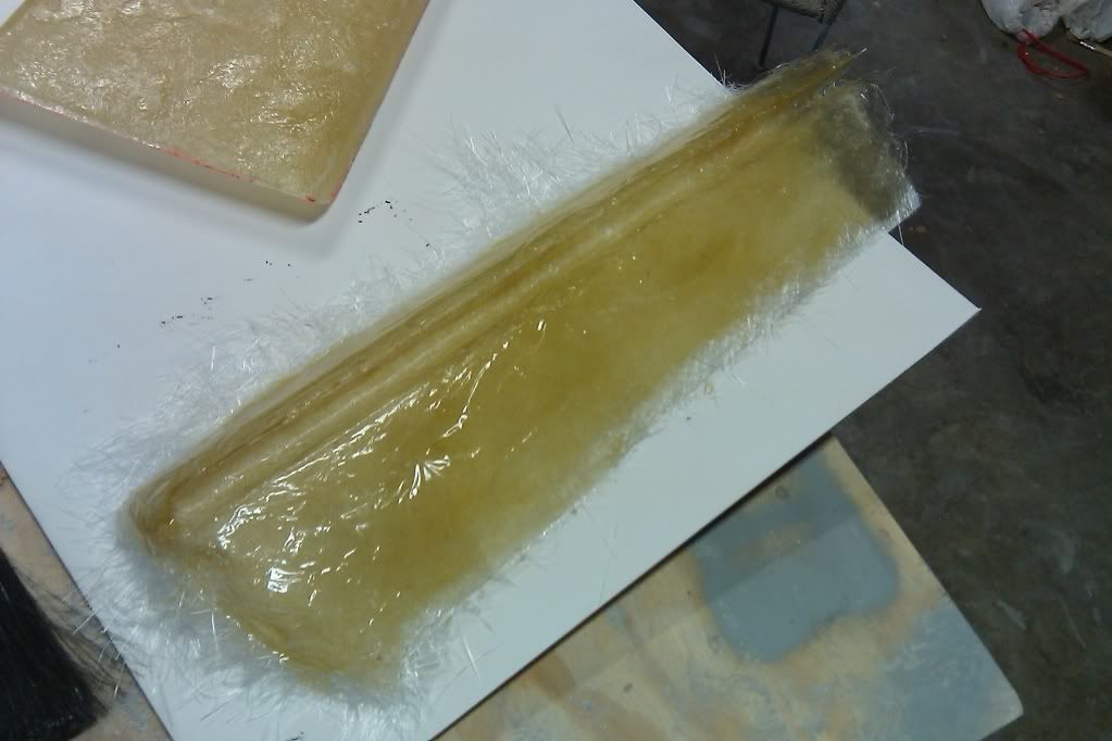

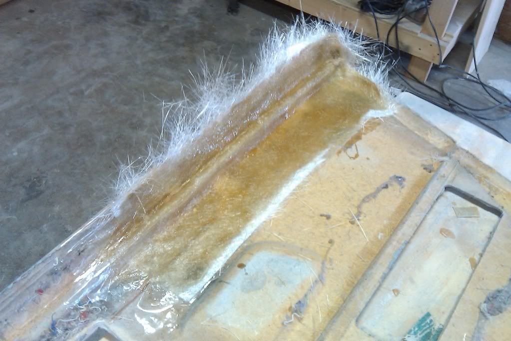

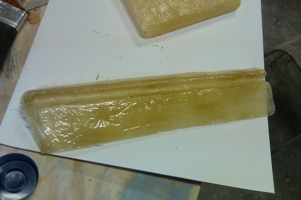

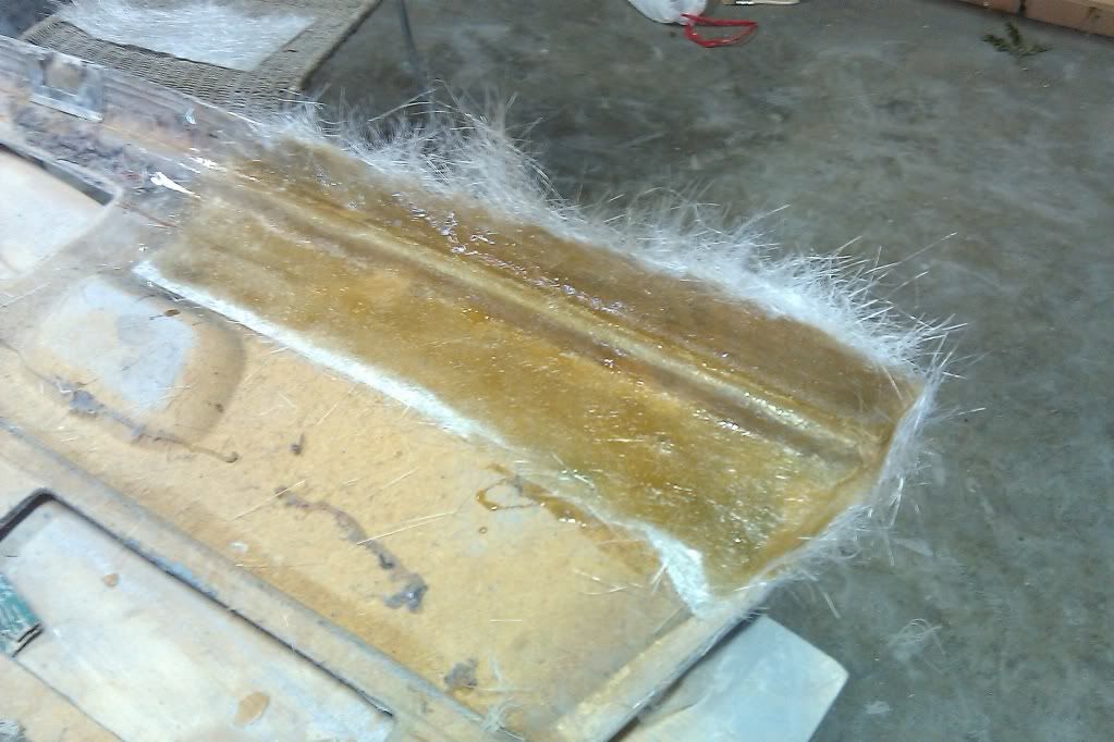

I then created the back panel for the door panel armrest to mount

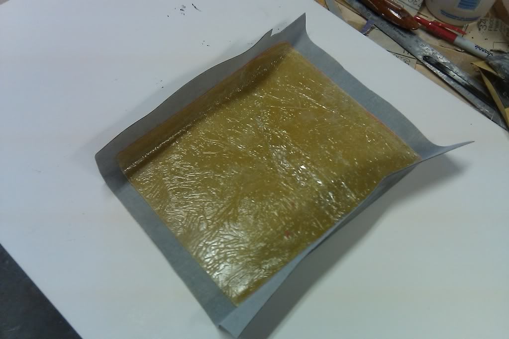

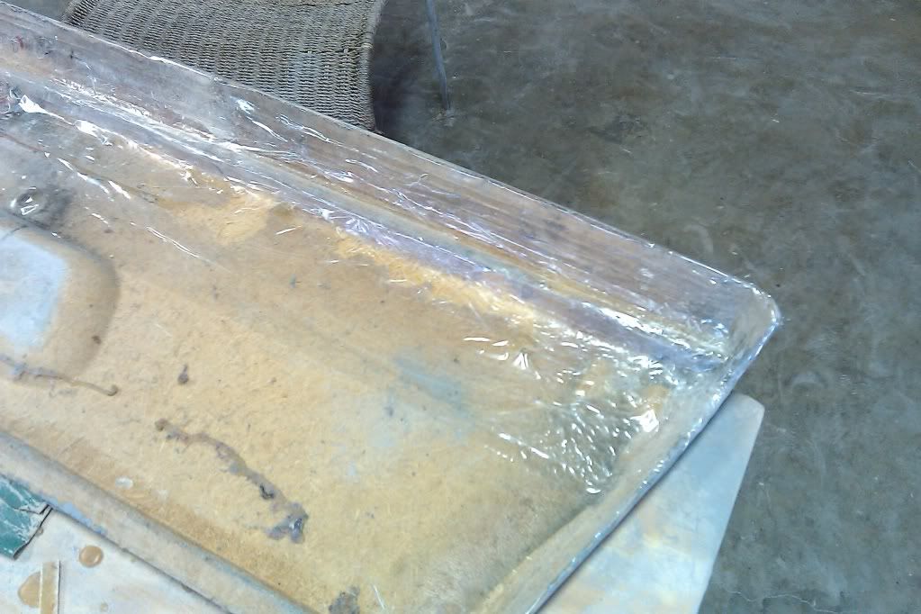

Started by taping off the area to glass
Applying glass
Removed from the "mold" and trimmed to fit
Glassed in placed

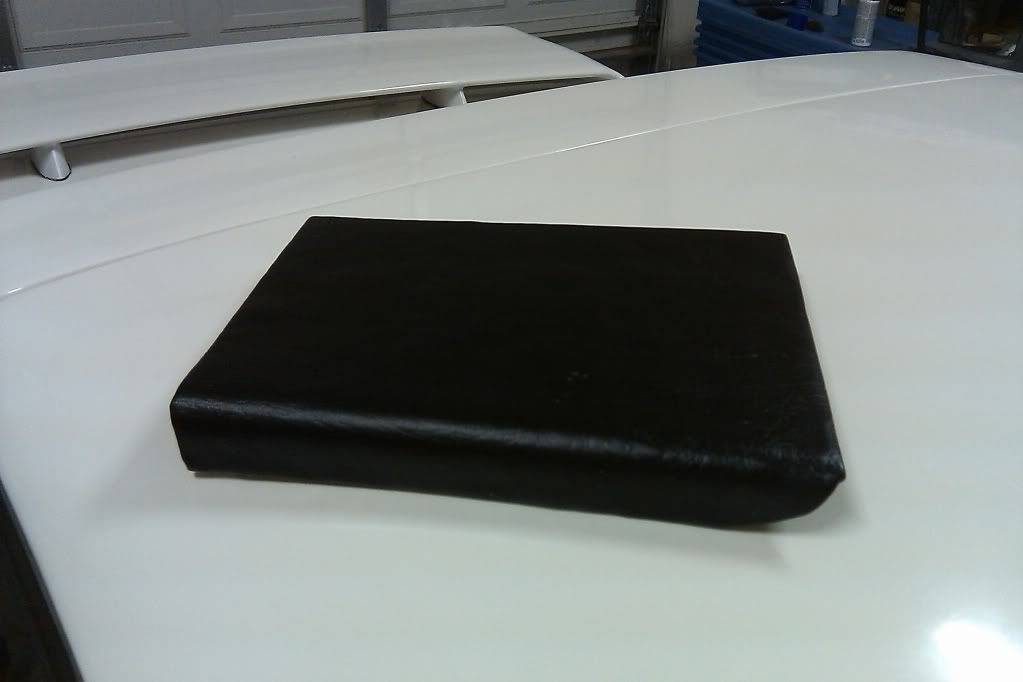

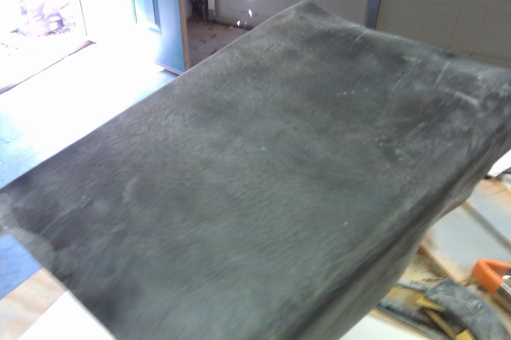

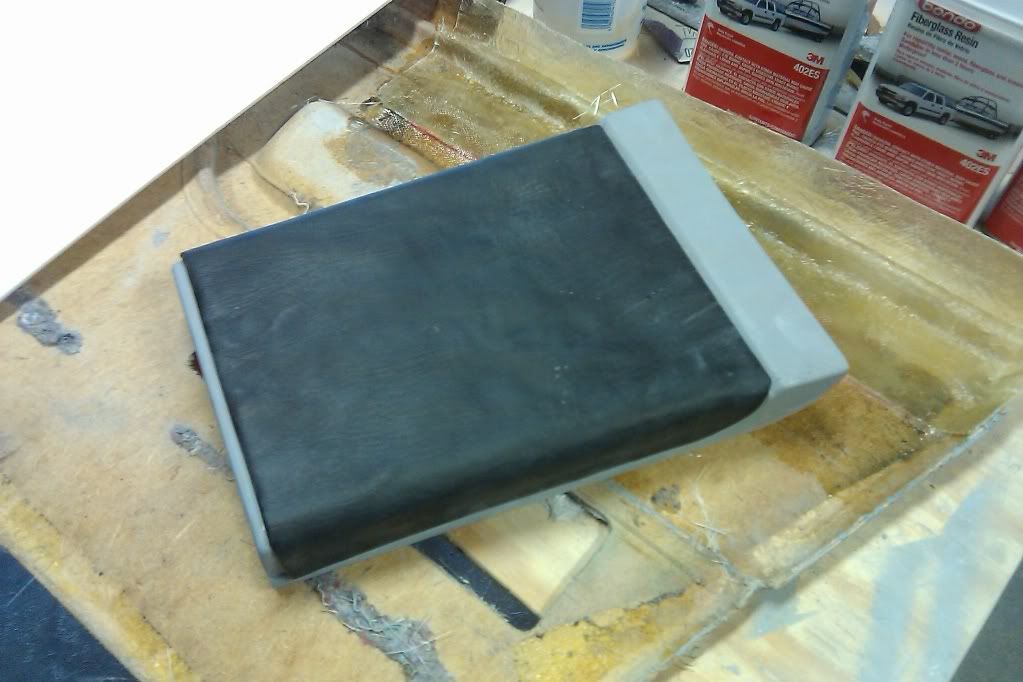

I then removed the arm rest piece and gave it a quick shot of black then put into place

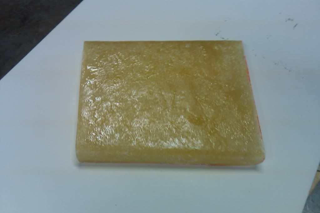

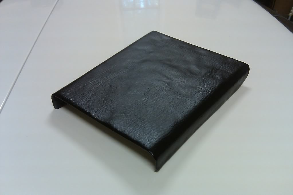

I was able to cover the cupholder cover with some left over vinyl. I didn't have any padding... this is just a practice piece
Hard to tell but I sprayed adhesive on both the glass and the vinyl
After letting the pieces sit for 5-10 minutes the vinyl sticks to the glass
Not quite ready for prime time - needs to be cleaned
All cleaned and ready for installation!

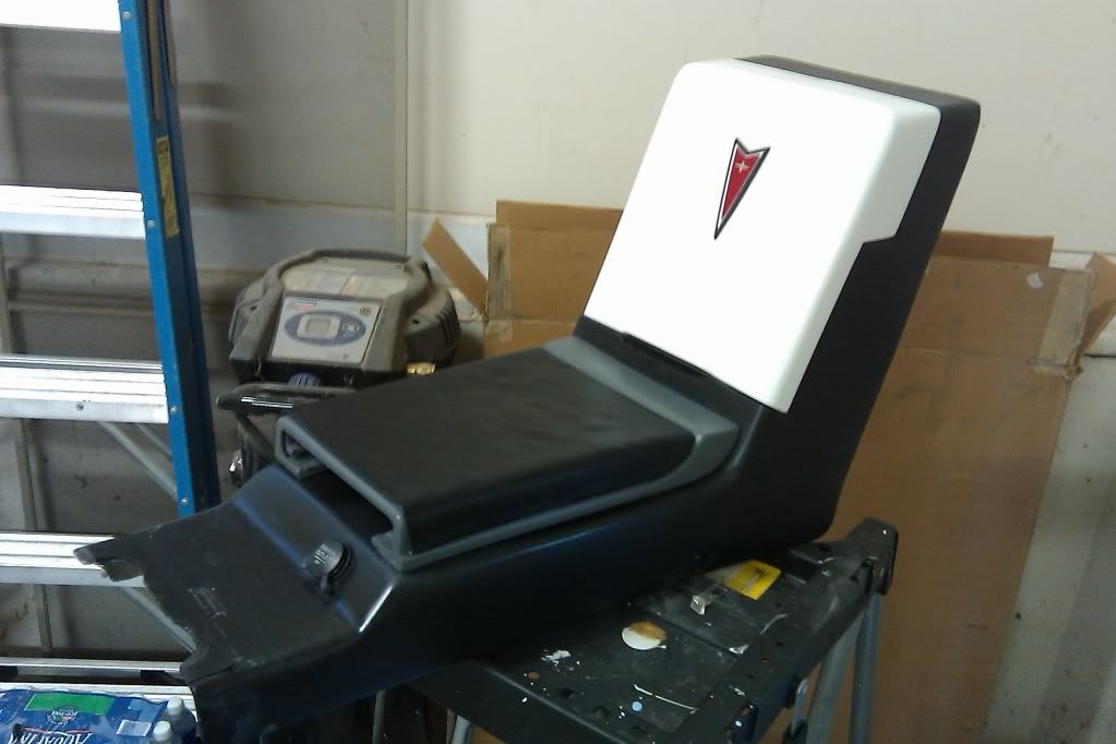

All mocked up

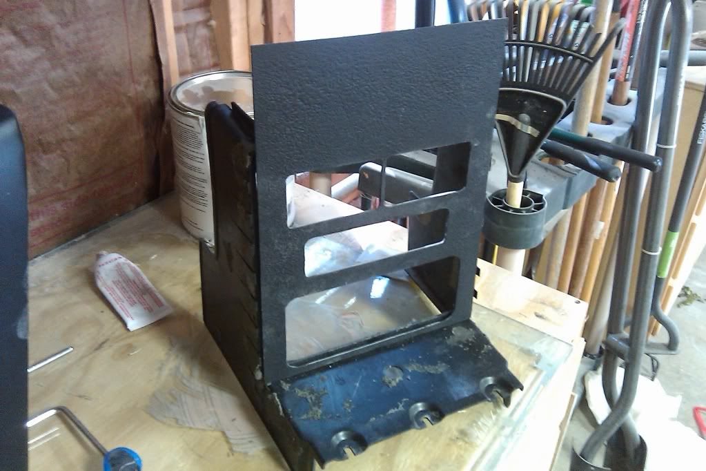

Getting started on the new 89 Concept center cluster

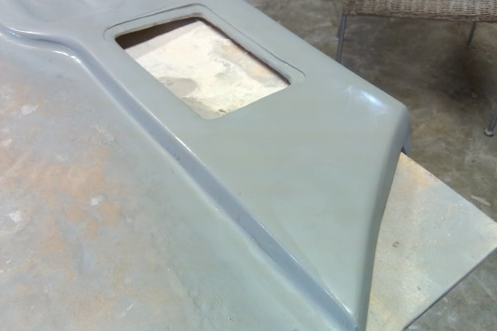

Overview shot - you can see the filler, primer and sanding already done. A lot more to go

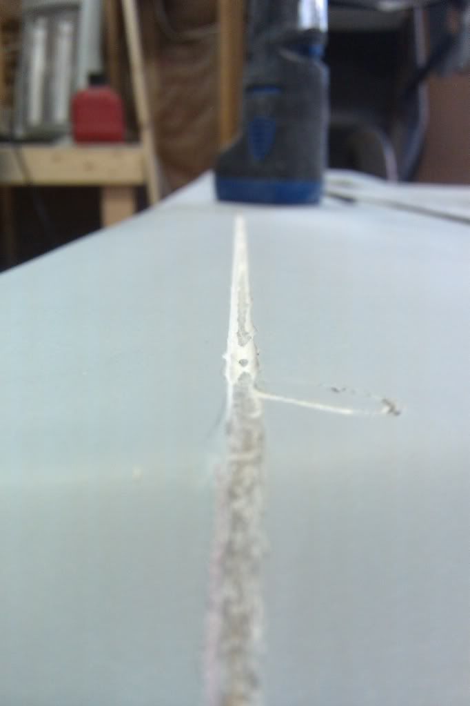

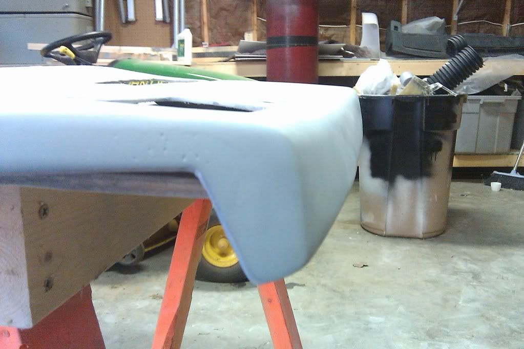

You can see the slight wave in the upper armrest - I am not too happy about this
Nice smooth cut and overall look - this area required a lot of attention

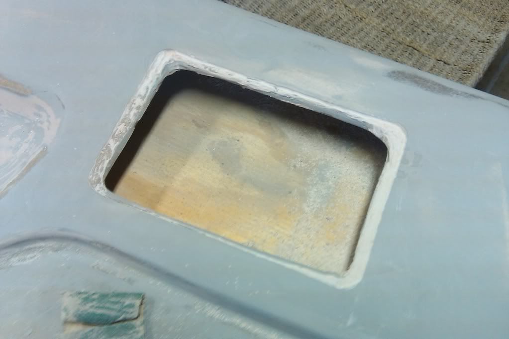

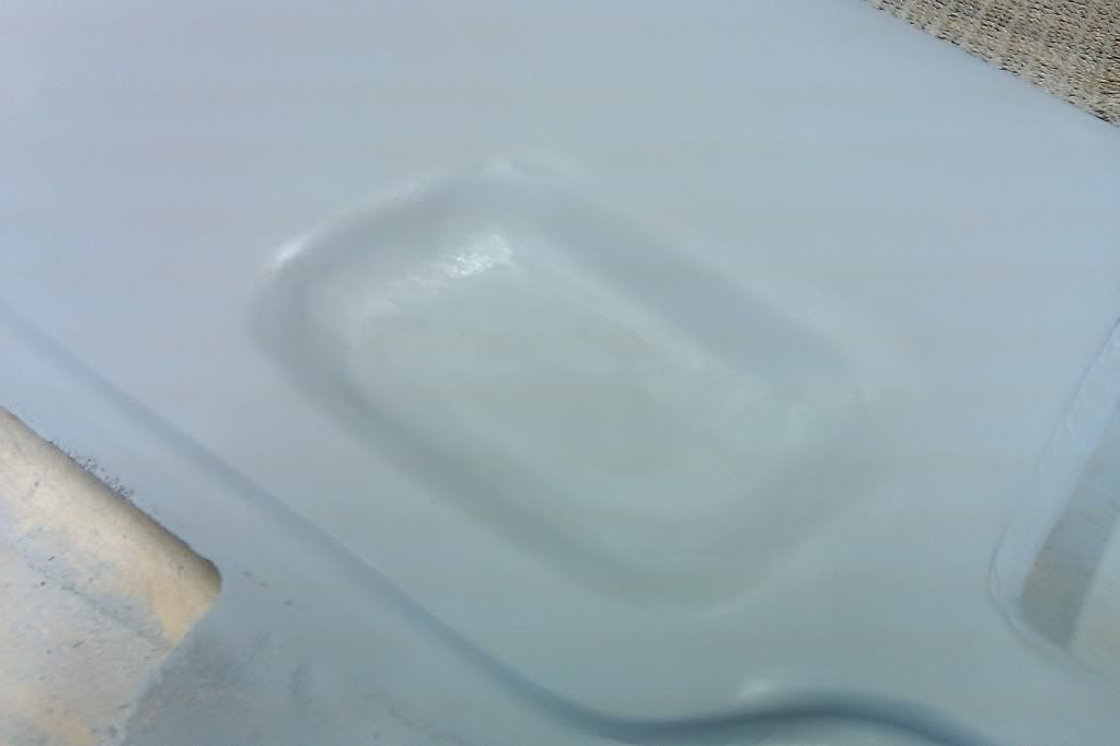

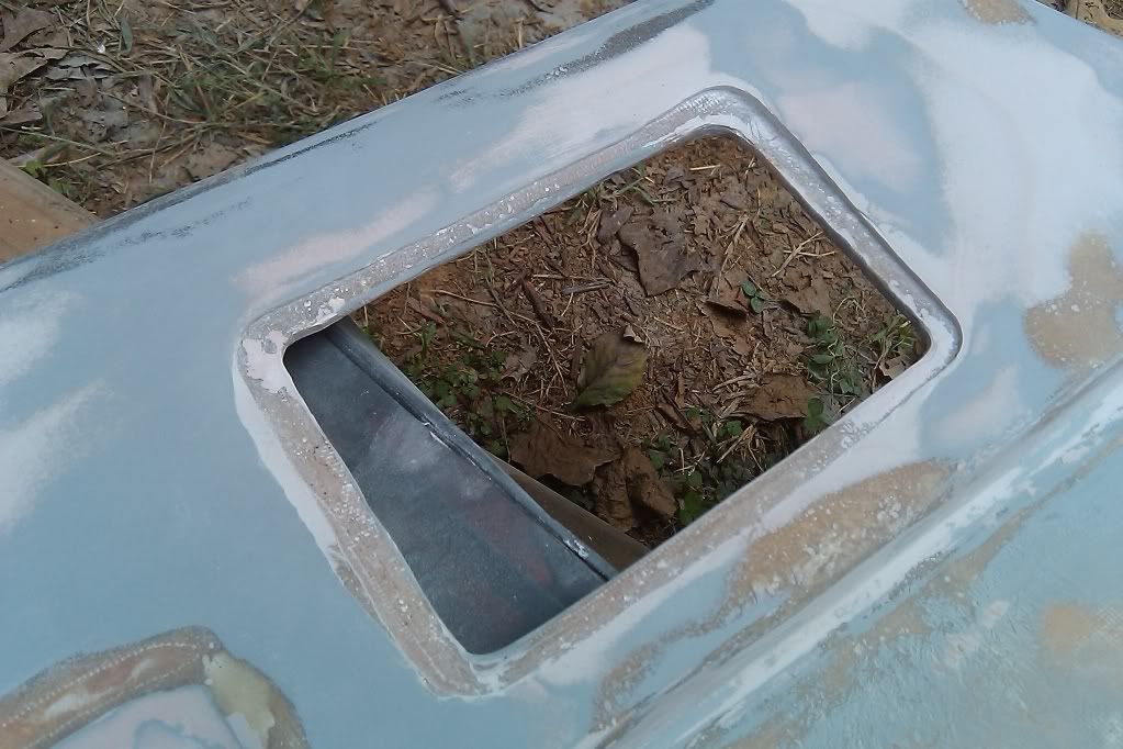

The door handle plate area has been a thorn in my butt - this area has to be near exact so the plate lays flat against the door panel
Again... more filler, primer, sanding, etc... Like I said, I was hoping to be much further along

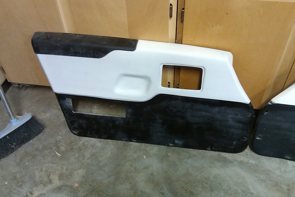

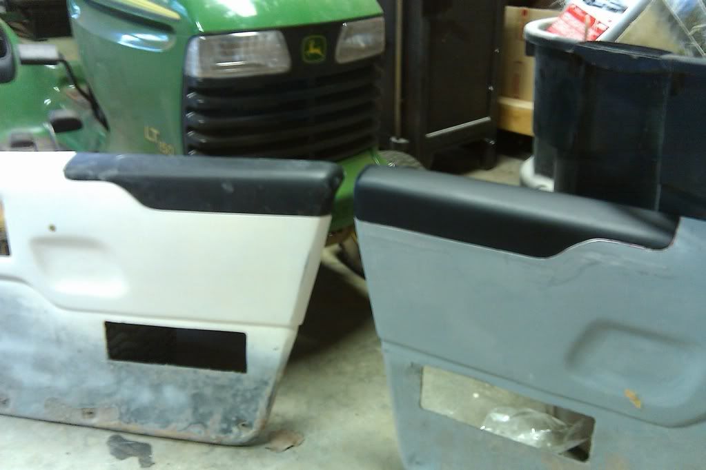

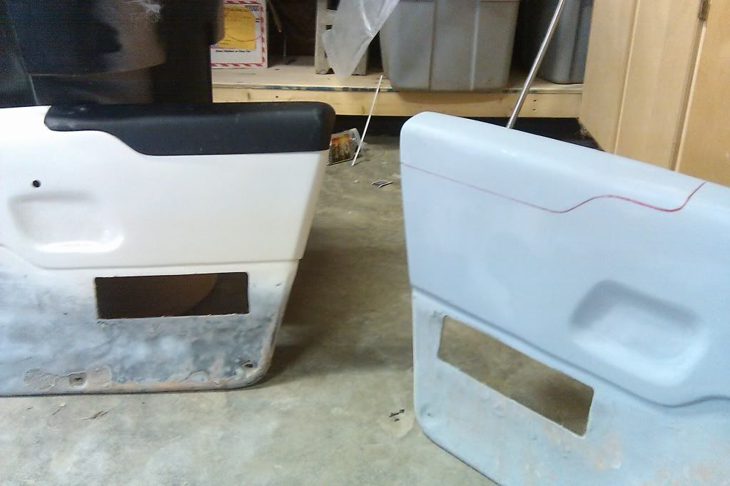

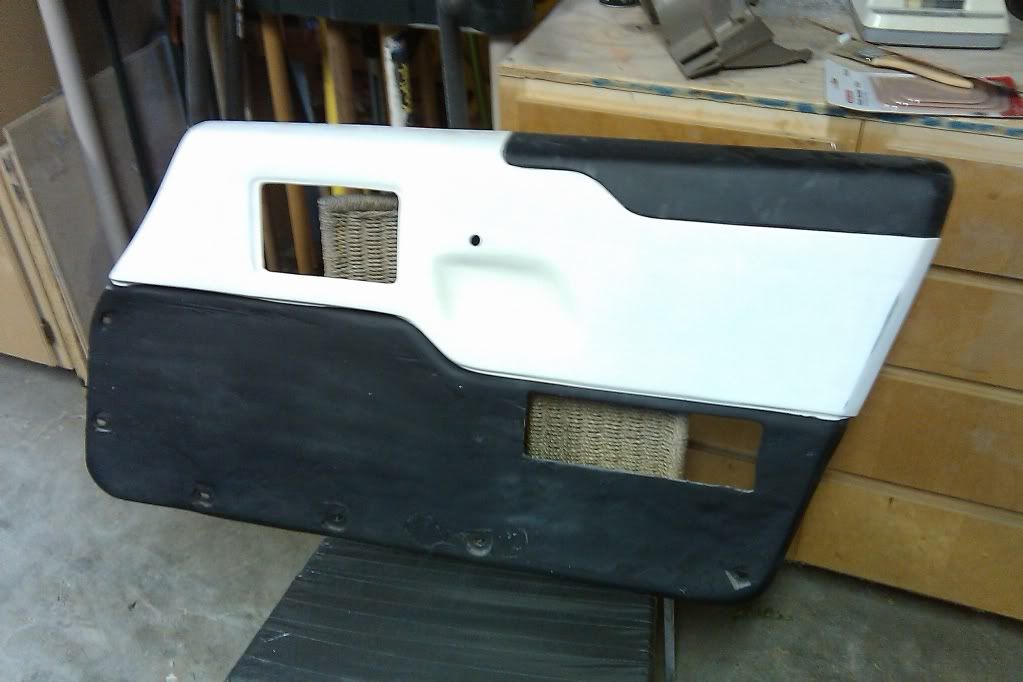

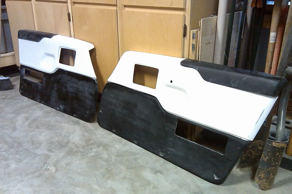

I was able to get a little bit done. I sanded a little bit more and painted both door panels to get an idea of how the panels will look once finished.
Drivers side - still have to fill and sand a bit more
Passenger Side - this one is almost finished
Side by Side
That's it for about a week - grrrr
[This message has been edited by Sofa King (edited 10-18-2010).]
