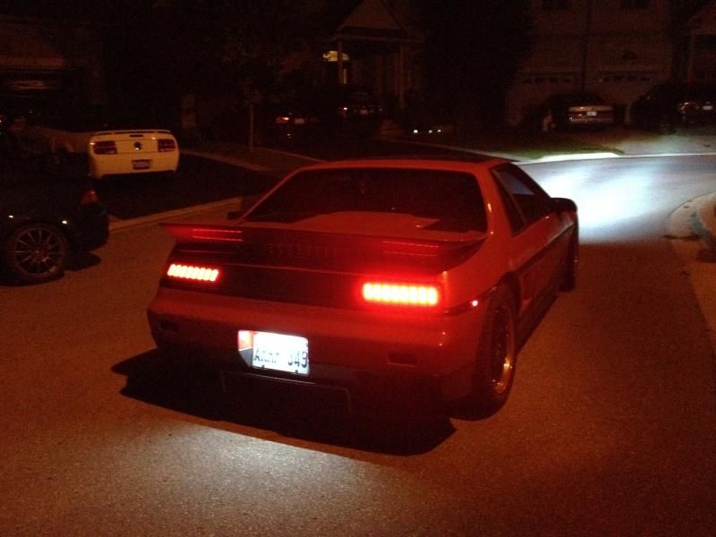

Not too many updates for my car. I finished the LED tail lights a while back and I've been enjoying those:

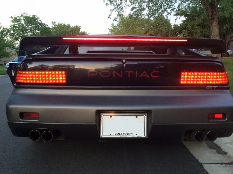

I also finished the GT LED tail lights and have sold a few of them:

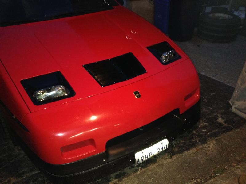

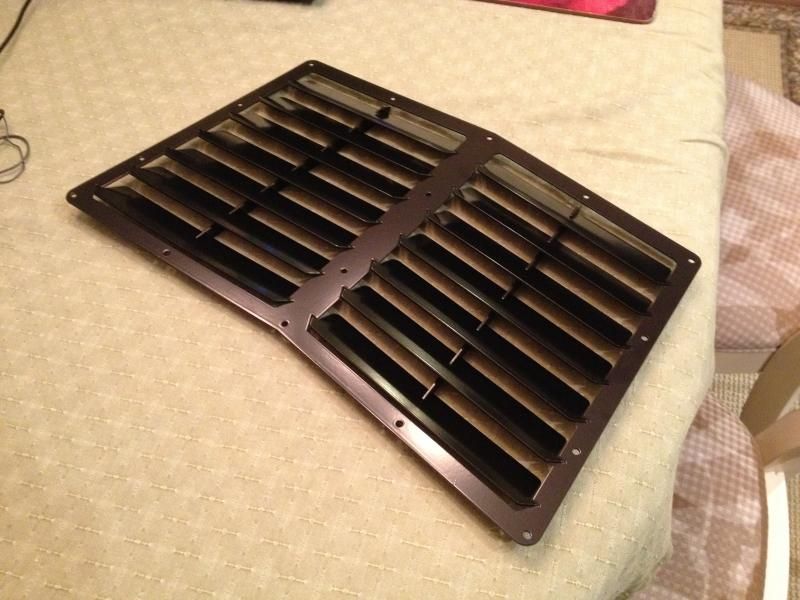

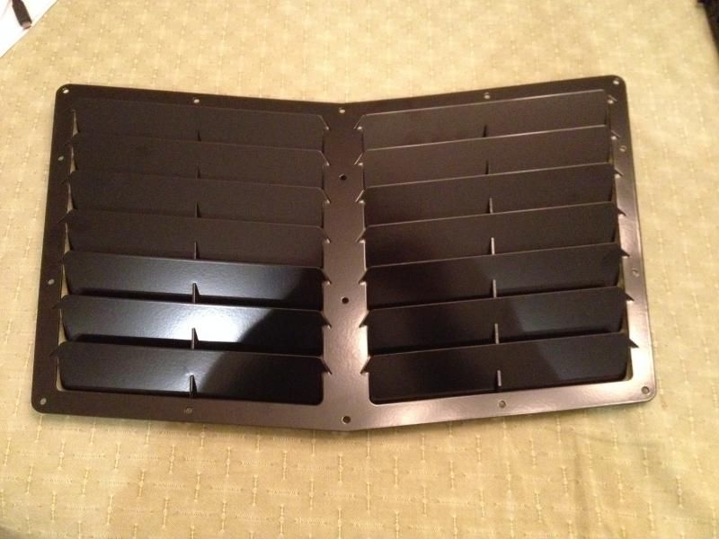

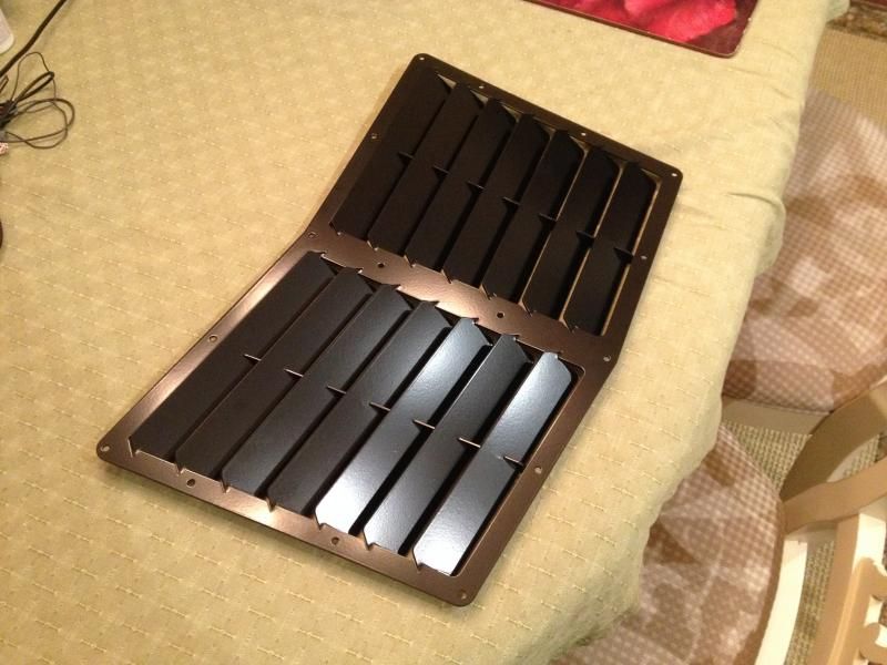

There are quite a few hood vent options for the Fiero, however, most of them require a lot of body work and repaint etc. This can get pretty costly and time consuming so I wanted to come up with a solution with the following requirements:
- Can be installed in an afternoon (fairly easily)
- Entire installation and product cost less than $200
- Looks aggressive but appropriate for the Fiero
- Functional
- Spare tire compartment remains sealed and unmodified.
I ended up making these custom aluminum vents that flow with the lines of the hood, and fit nicely in the front section to relieve pressure build up at high speeds.
They are made entirely from aluminum and then powdercoated black.
You will need to simply cut two holes in your hood, drill the mounting holes, and rivet the vent into place. In this case I used normal aluminum rivets, but you can also find black rivets to make them blend in. The vents actually somewhat match the vents at the back of the car and really do a nice job of letting the pressure out at high speeds.
I will try and get more pictures tomorrow. It gets dark around here pretty early now that it's winter.
They will be for sale shortly on my website. Feel free to post any questions you might have!
