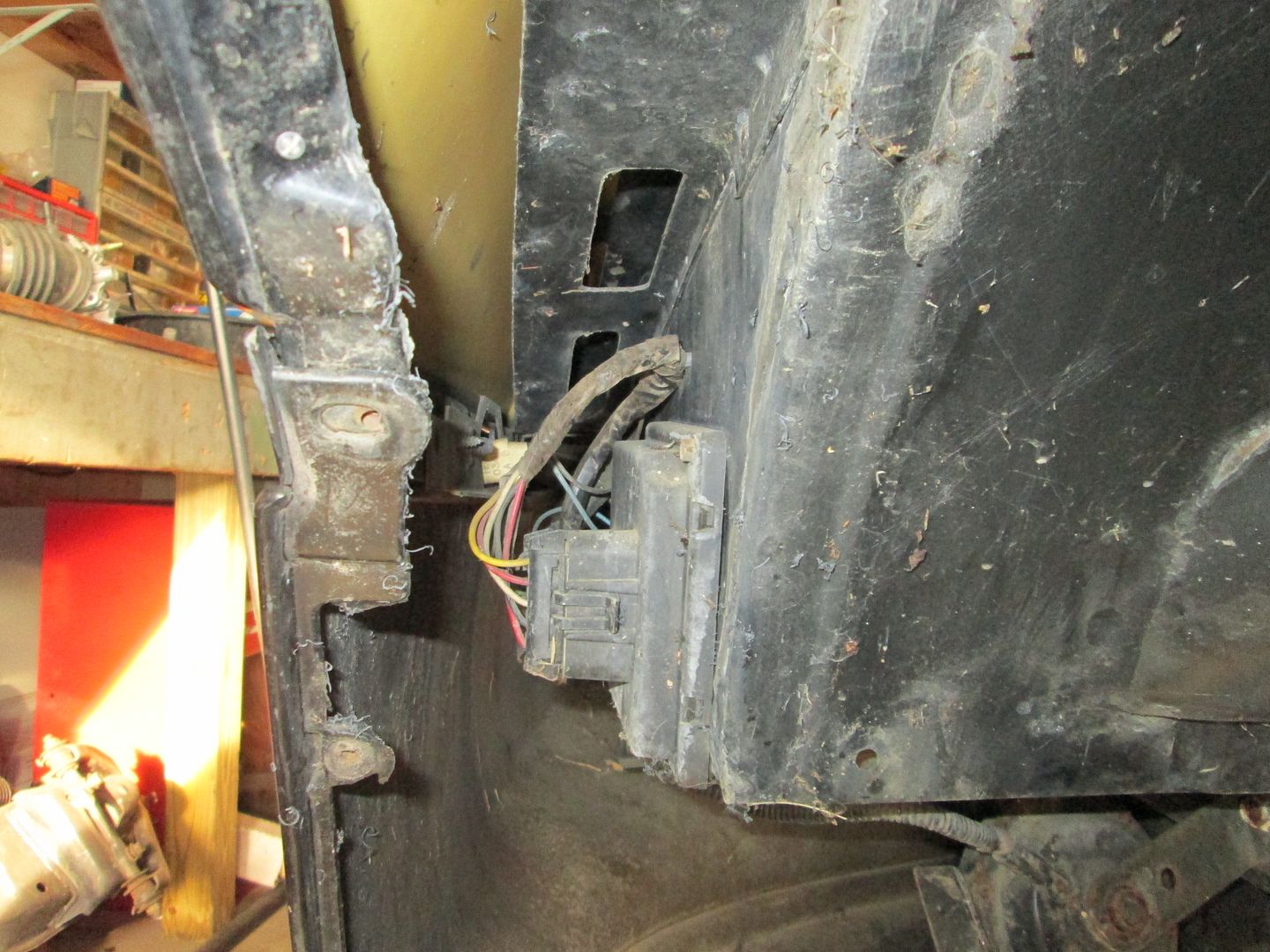

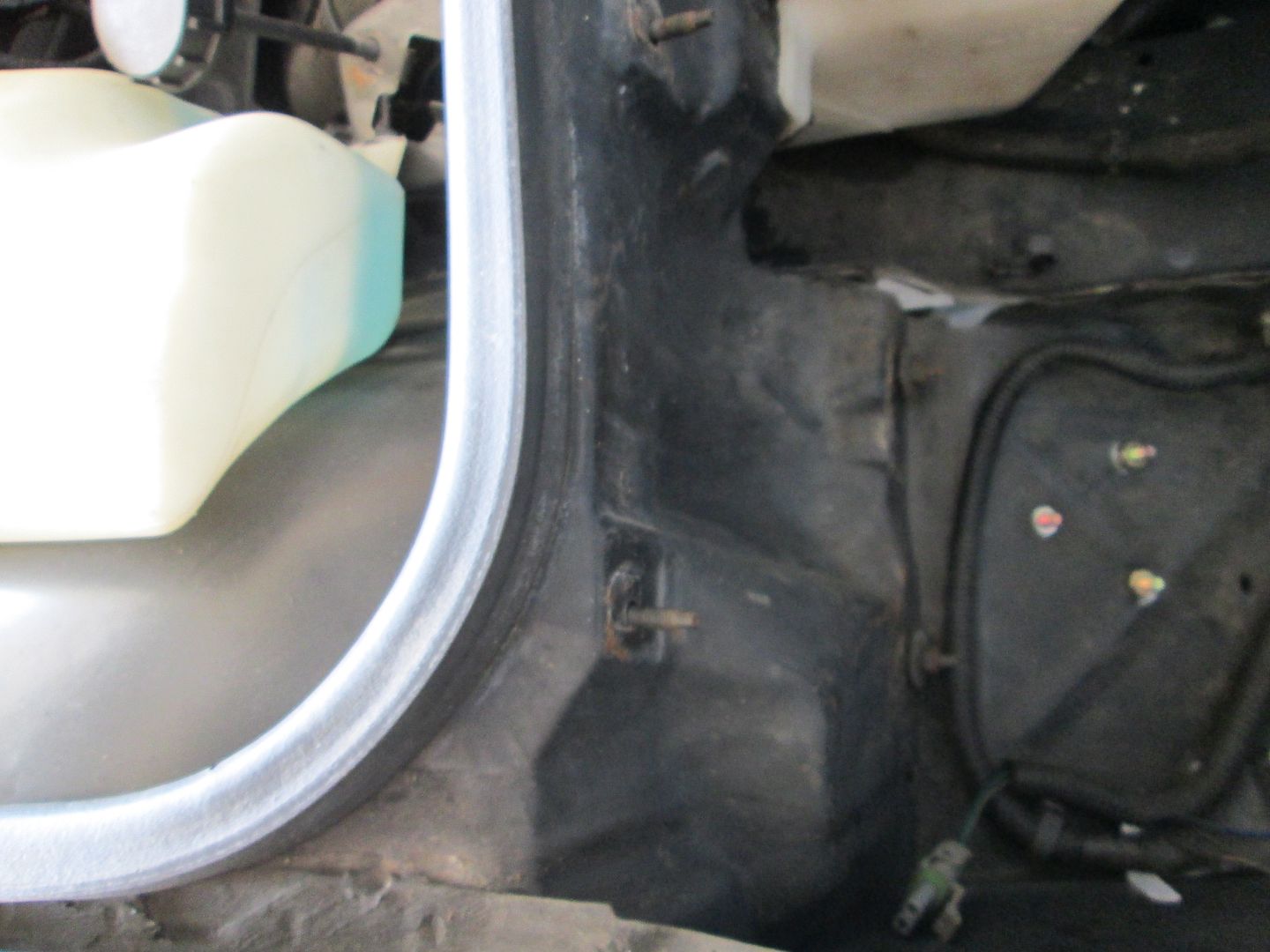

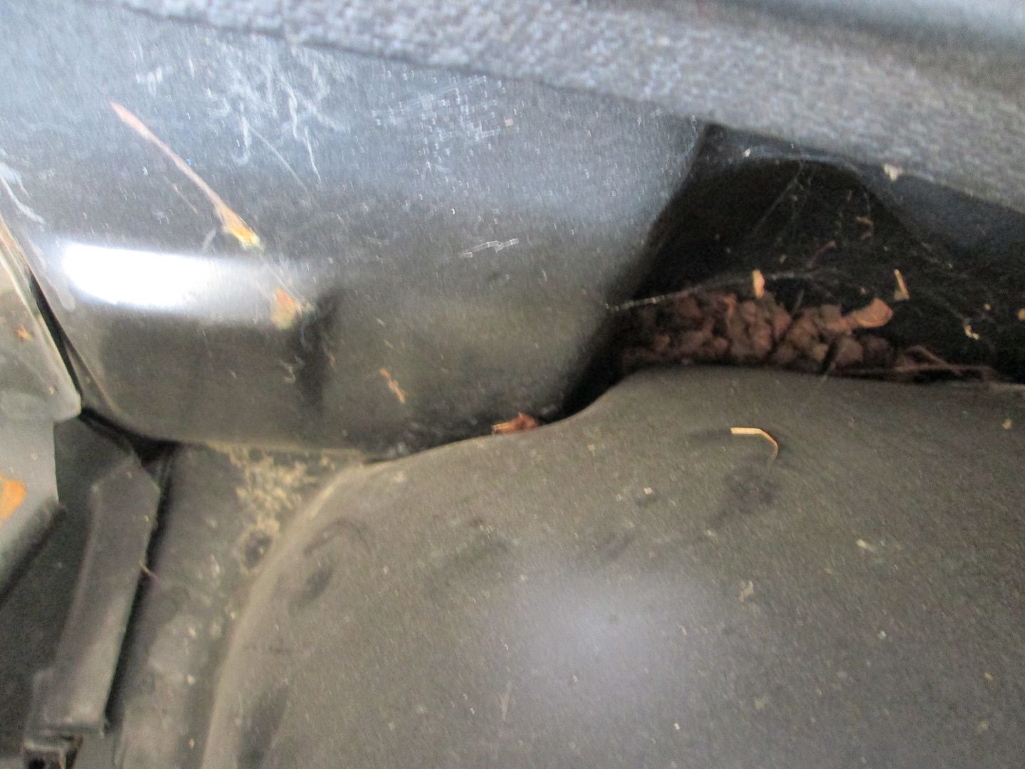

Over the years there has been quite a bit of discussion around venting the radiator compartment via the head light area. Most of those discussions focus on drilling a large hole to the wall the headlights mount on and vent the air into the wheel well. Upon quick review, there isn't a single wall to pass through and in fact that area is open to the spare tire compartment. Here are a couple pics of that area:
As you can see in the 2nd picture the wheel well is seperate from the front firewall and has a gap all they way down to where they are welded together. So any hole in this firewall panel will vent to the spare tire area. If I wanted to do that, I would just cut the holes in the wall right behind the radiator.

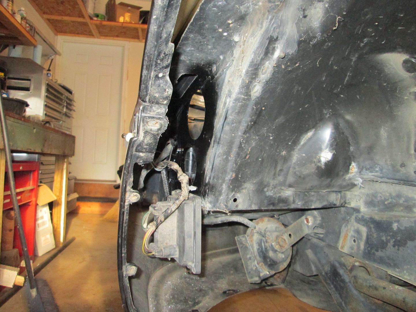

So I started looking for other places to vent the air and settled on the outer side of the head light pocket. It is light gauge sheet metal and easily accessed for drilling. You will notice that there is already a hole there for the turn marker light wires to pass through.
Here is how much space is between the panel and the fender:
So I decided to drill two 3" holes in the side panel as shown:
On the Driver's side, the headlight module was in the way, so I relocated it down to make clearance for the holes:
