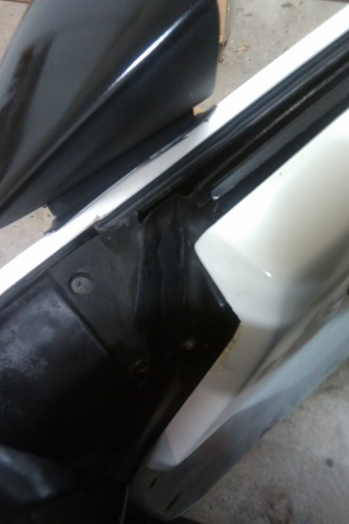

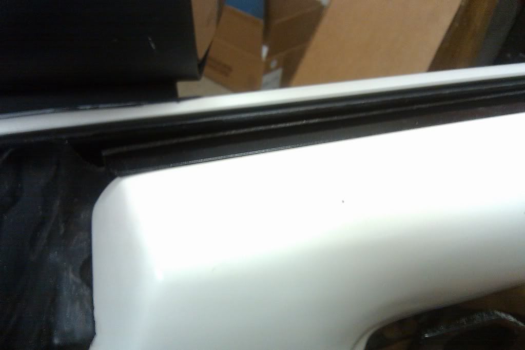

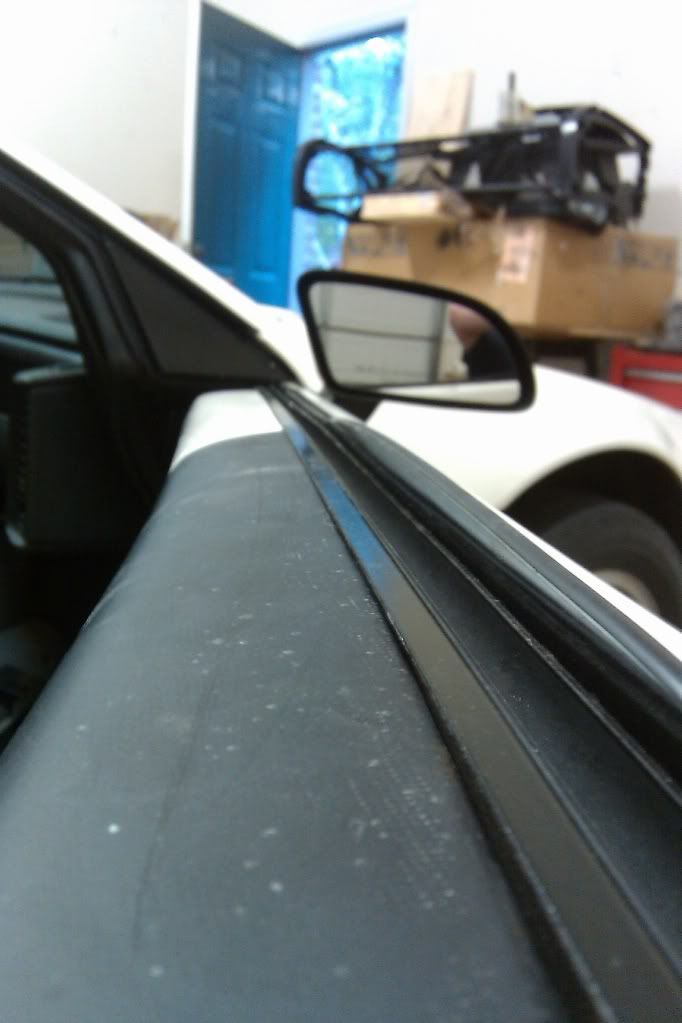

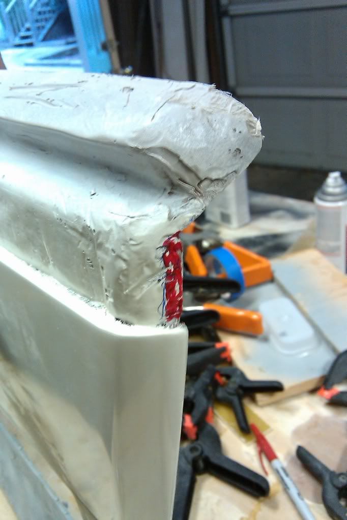

I spent a few hours fitting the passenger door panel. I had to make a few modifications, cuts, sanding, etc... but in all I'm really impressed!

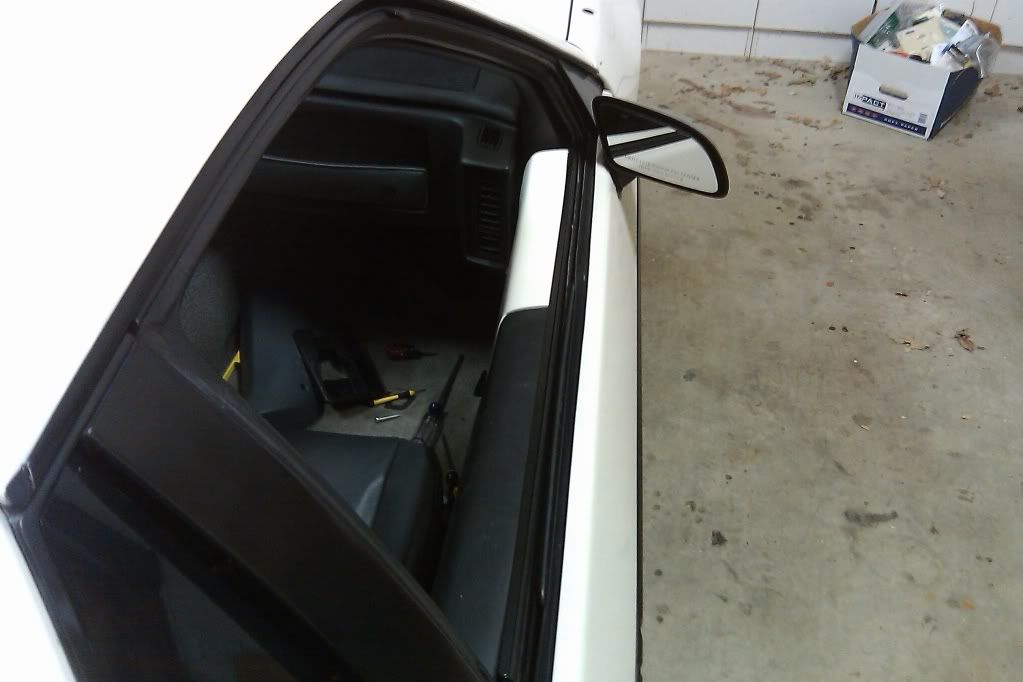

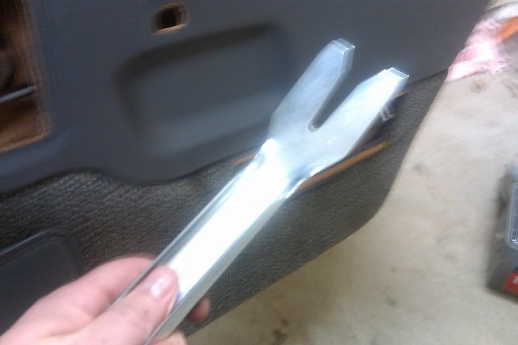

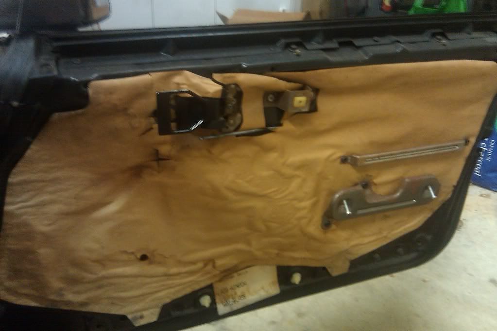

Grabbed my trusty door removal tool
And popped the panel off

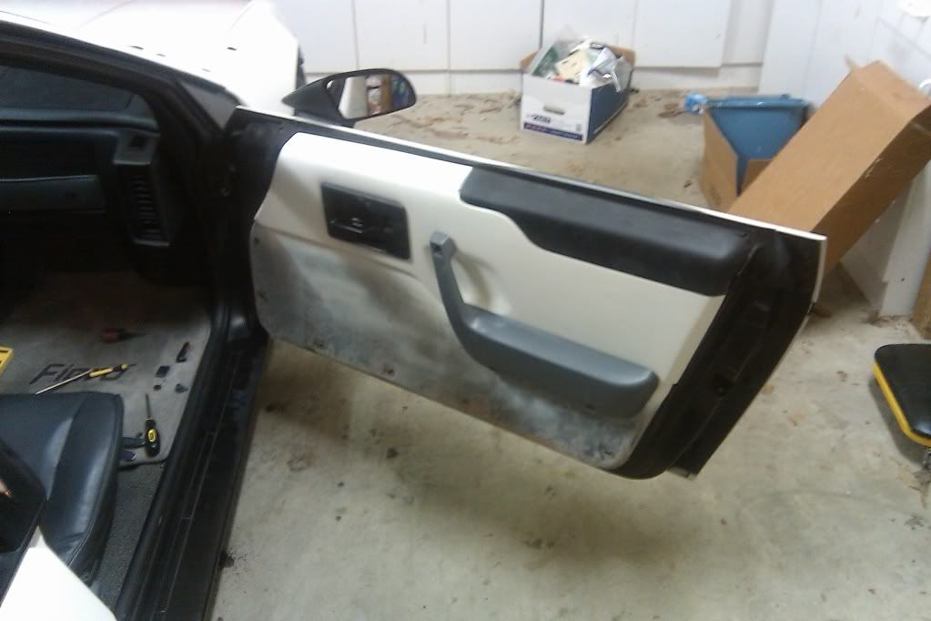

I then did a basic dry fit. Not too shabby
Pretty good here
HMMMM... small little gap
Pretty good overall

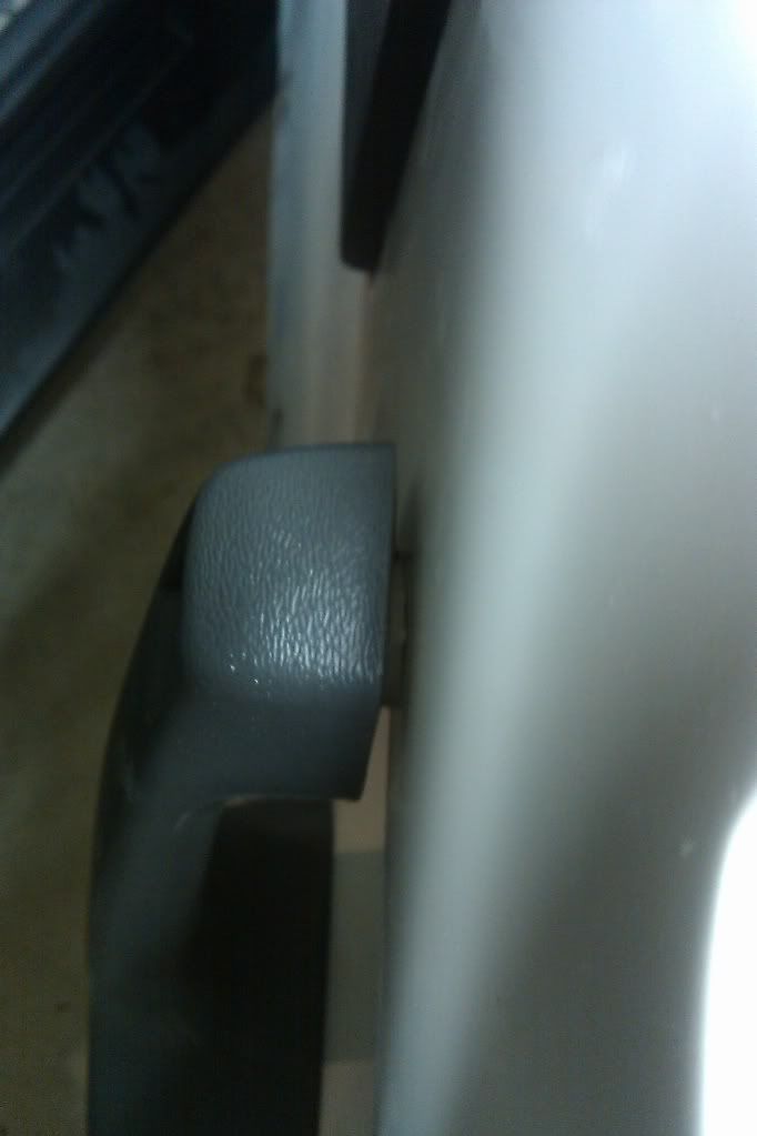

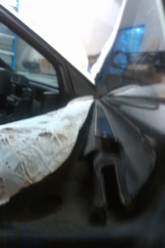

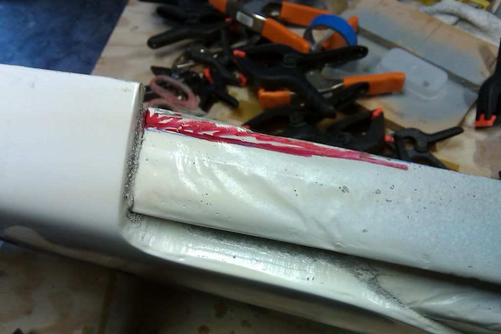

OK... where are the bad areas?

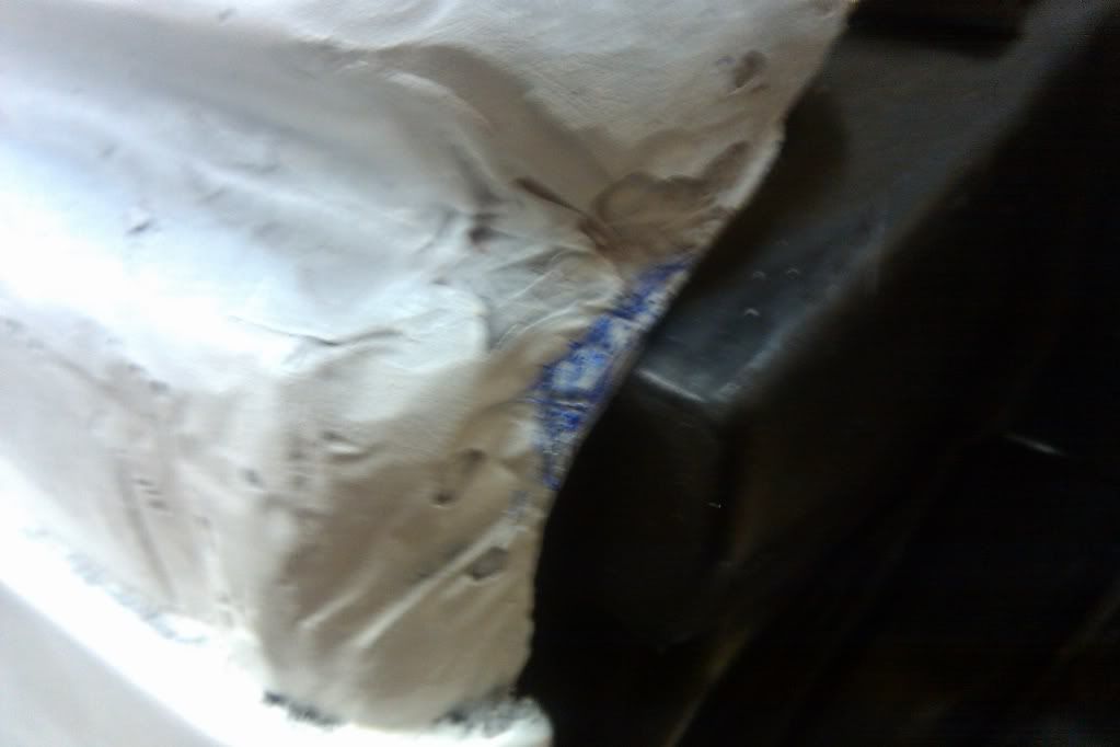

You can see here the gap - EWE

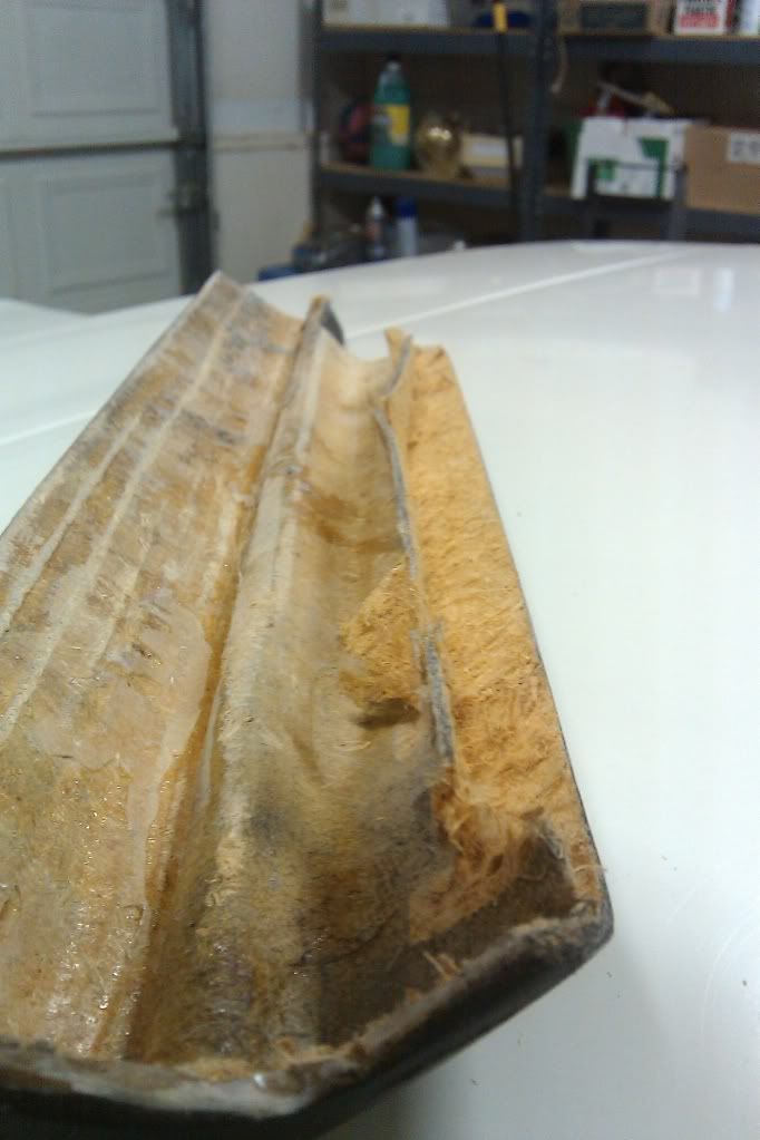

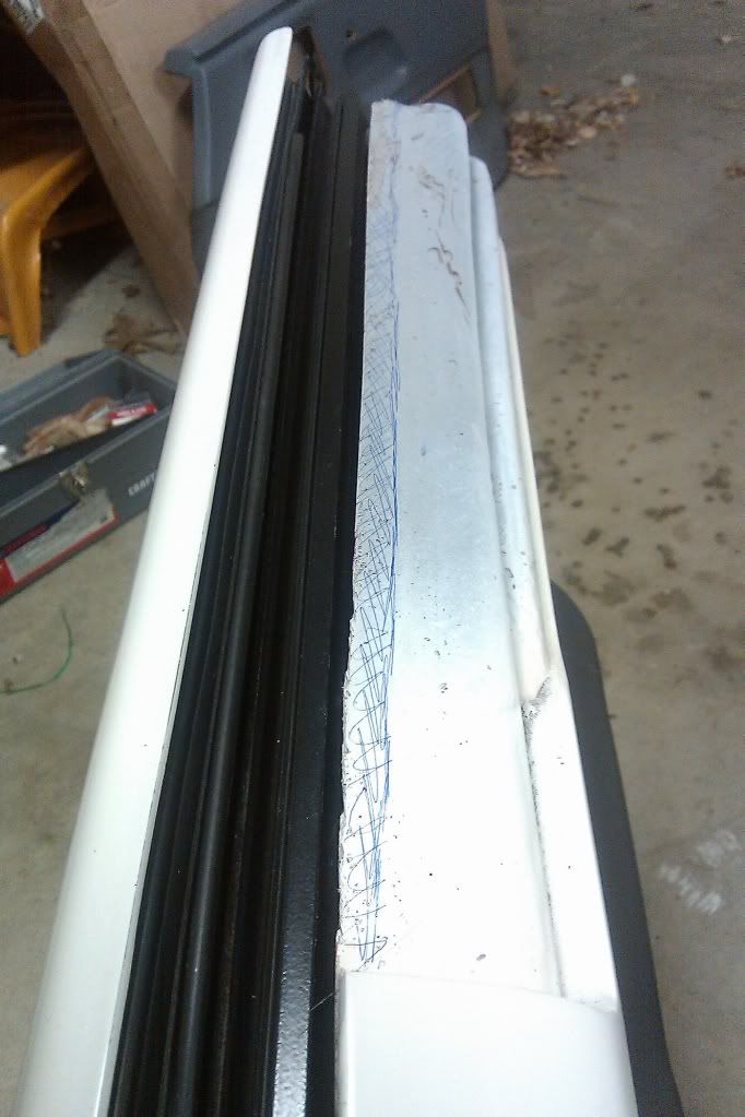

Need to remove some glass
Need to remove the blue - these areas are creating push back and not allowing the panel to fit into place
Remove the red areas
Removed

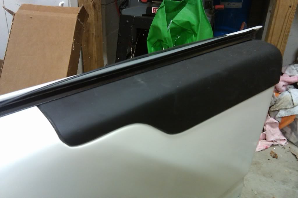

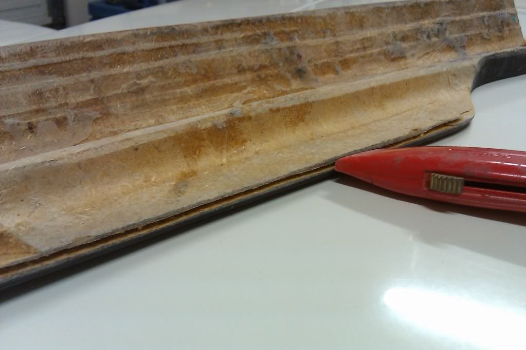

Removed material from the underside of the "armrest" portion of the door panel - since this piece will be covered with vinyl, I have to remove about half the material. Although the vinyl is thin, I still need enough room for the piece to slip into position

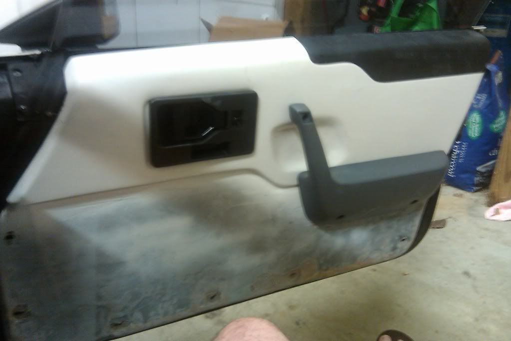

After a few "special modifications"... a nice snug fit

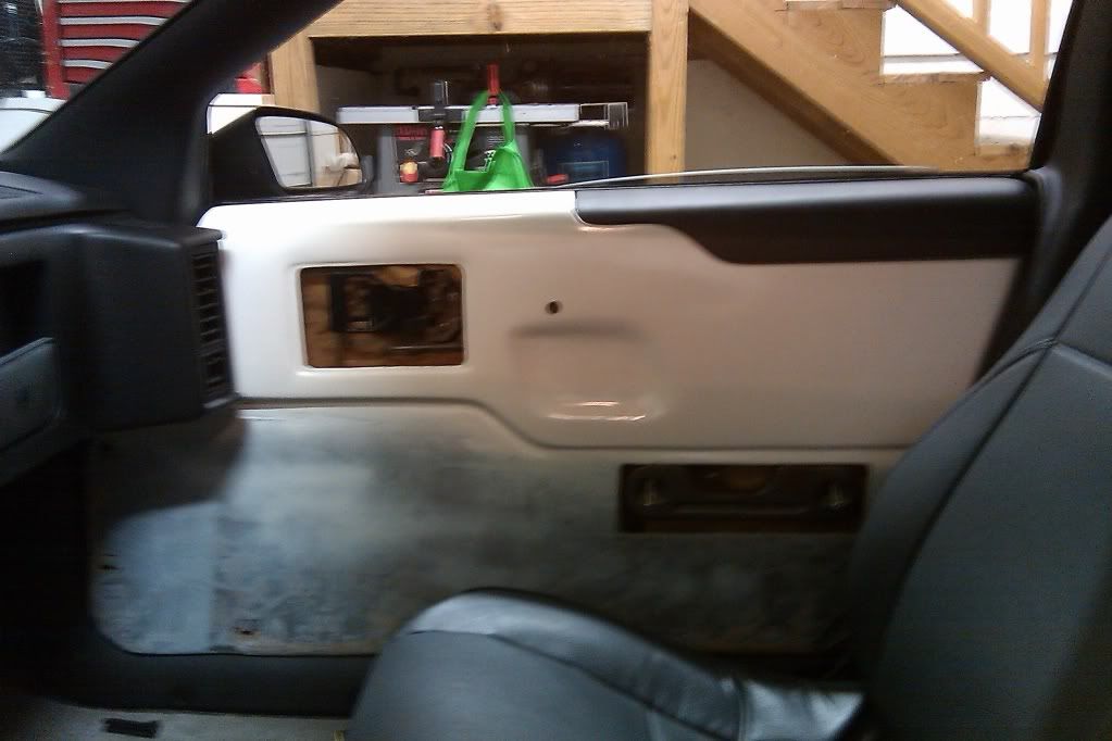

The Quasi-Beauty Shot

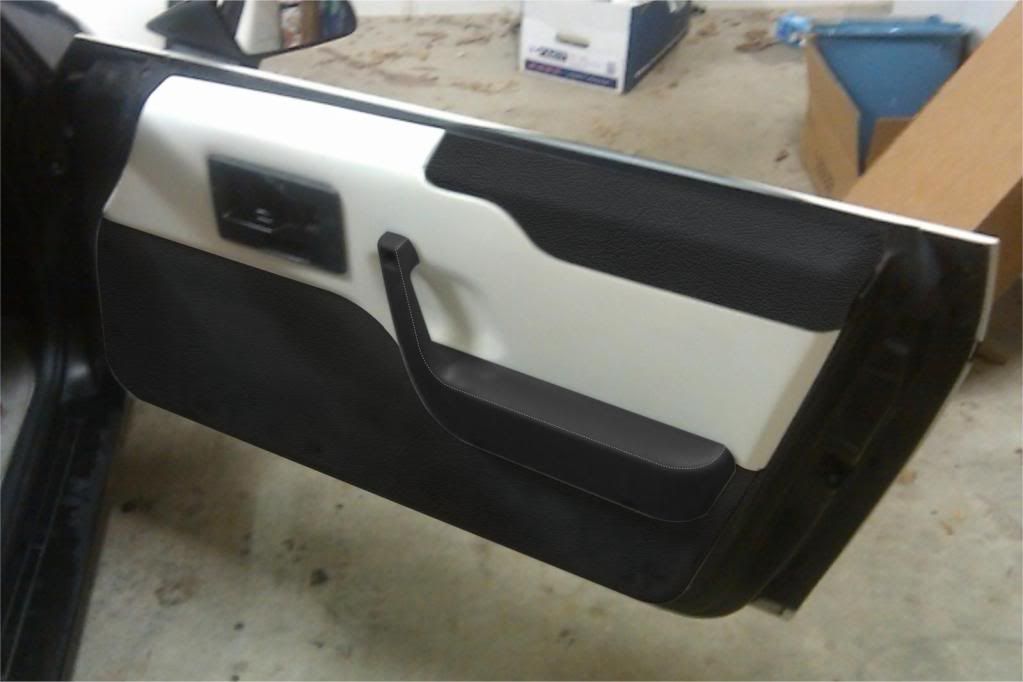

The door pull will not remain grey. The plan is cover the door pull in the same material that will cover both the lower portion and the upper black piece of the door panel. I'm going to with a tight stitched look. Not really sure how it will turn out... If all else fails, I'll paint them black.
Sofa King OCT 07, 09:27 AM
This should help give an idea of what the final door panel will look like - I updated the pic
[This message has been edited by Sofa King (edited 10-07-2010).]
Tony Kania OCT 07, 10:57 AM
Ouch! That's sharp.
Sofa King OCT 07, 12:27 PM
Ouch! That's sharp.
Thanks, T! I have to admit I was a little nervous taking the panels off. I wasn't sure whether the panel was going to fit at all. I have a lot of work to do around the door handle plate to get it to fit just right. I'm hoping to have both door panels done and installed this weekend - hoping... you know how my schedule has been these last few months.
grkboy707 OCT 07, 12:36 PM
WOW! Seeing it in place really makes me realize how great it is! The black part on the top really pulls it together. Good job!

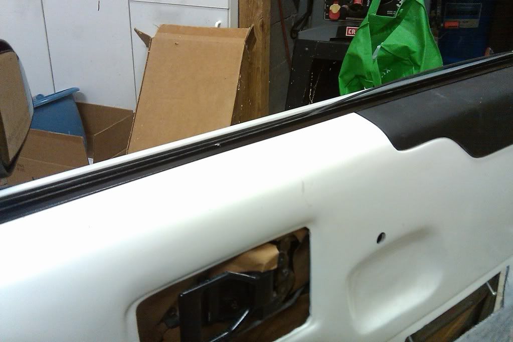

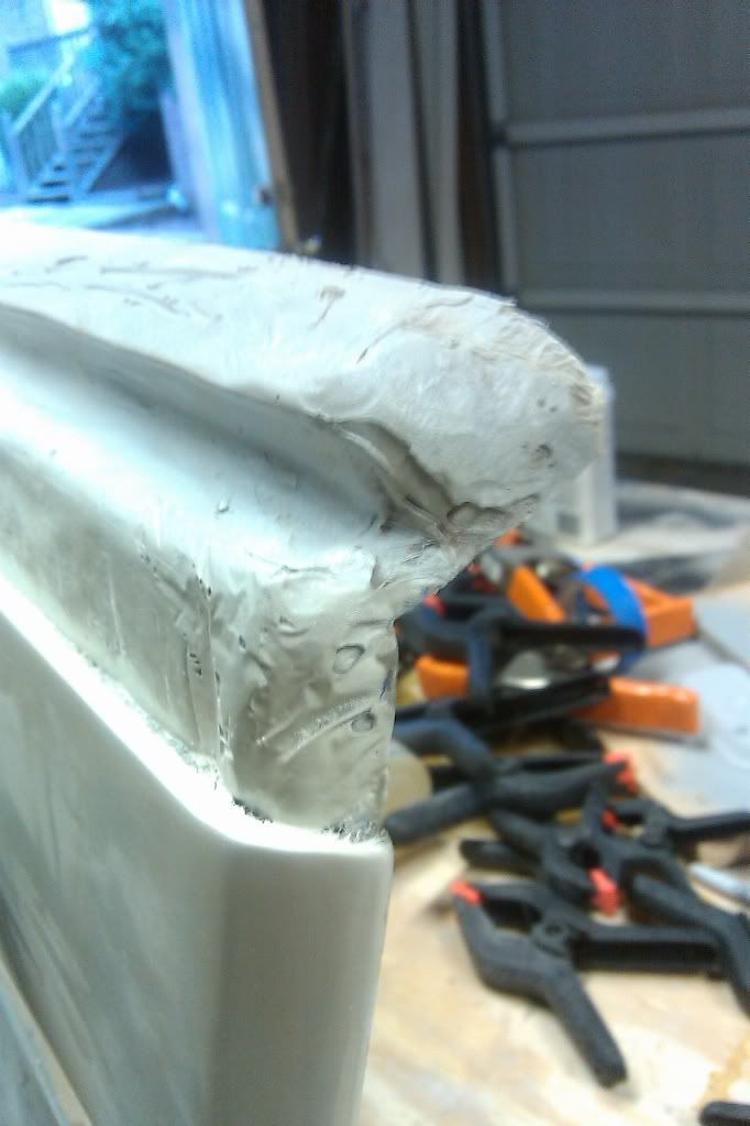

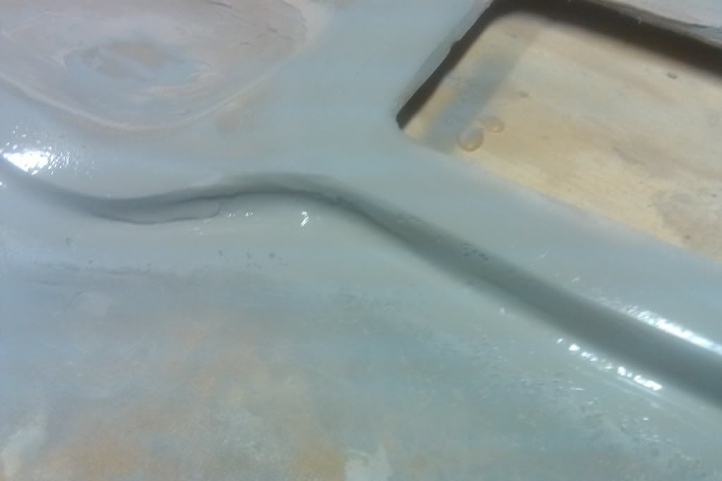

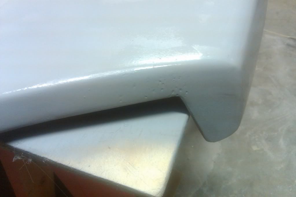

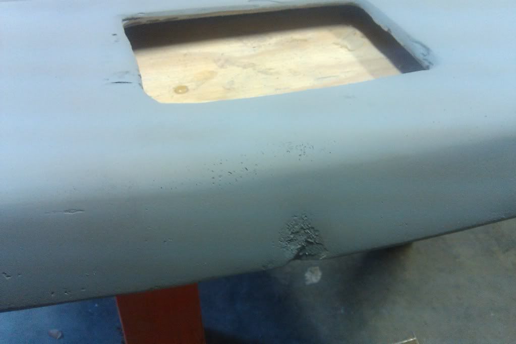

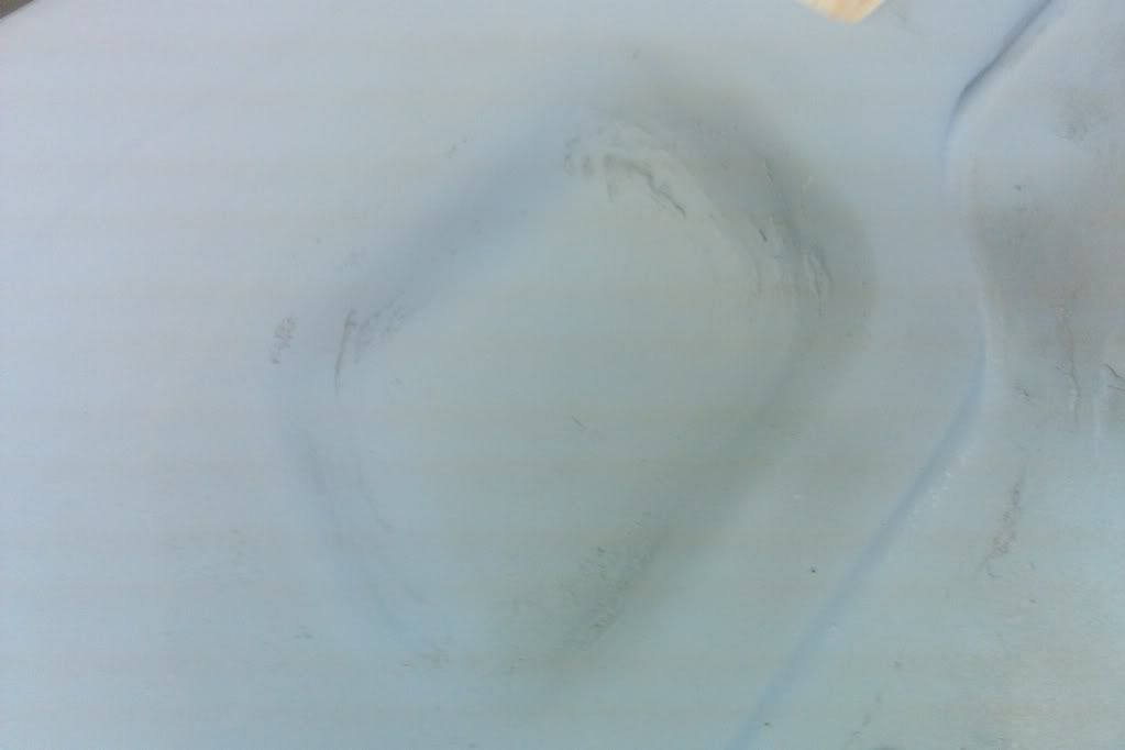

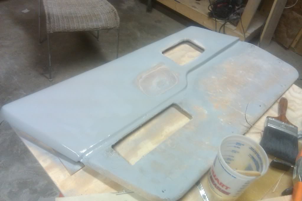

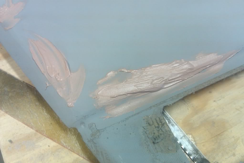

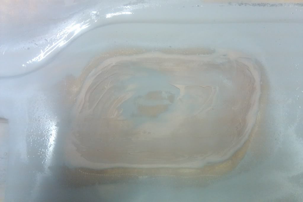

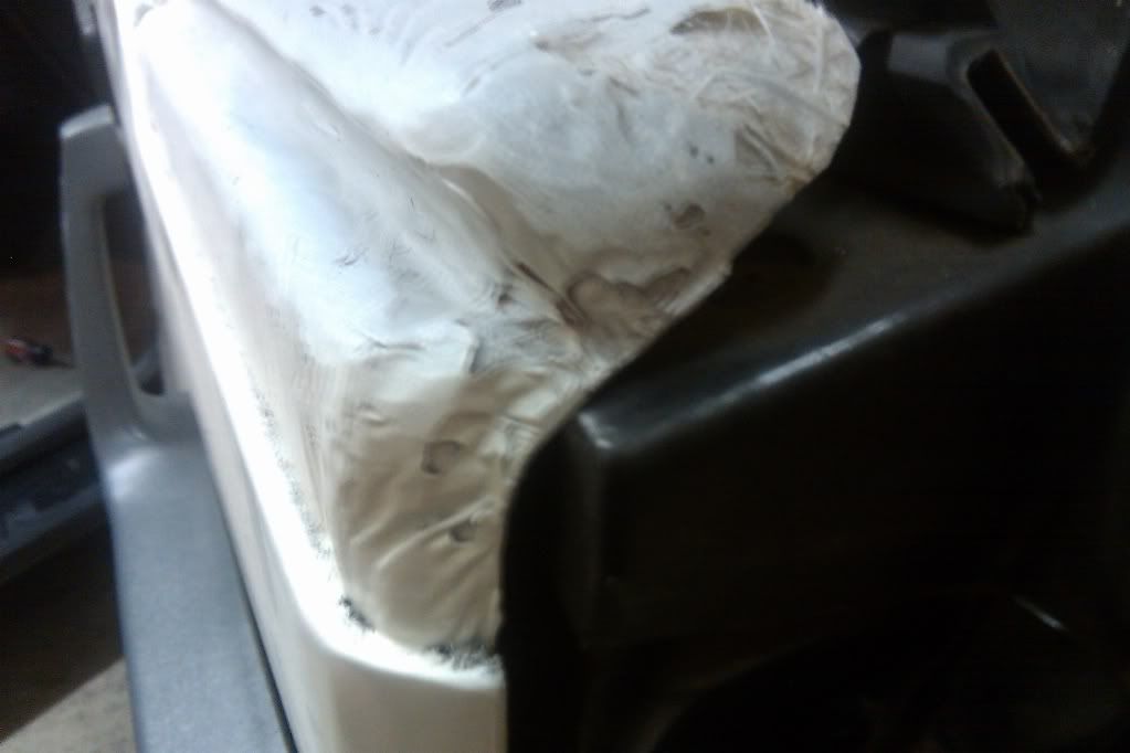

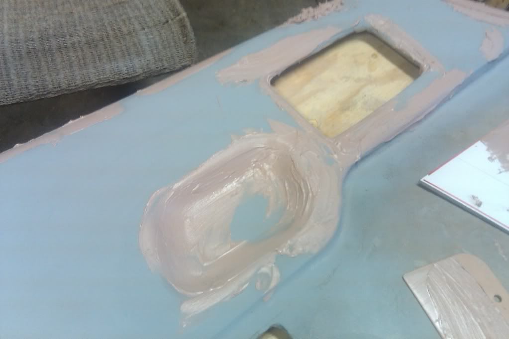

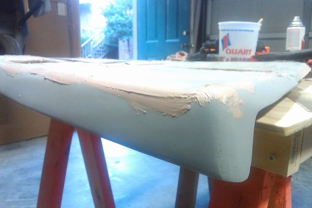

Got started working on the driver side door panel today.
As you can see I have a lot of filling and sanding to do from where I left off
This is the indent where the door pull is located - lots of filling and sanding
Adding filler
After some sanding
Spraying some primer/filler
I still have a lot of work ahead of me - but it's just sanding and filling... that's the easy part. And then comes the cutting of the upper armrest area.
