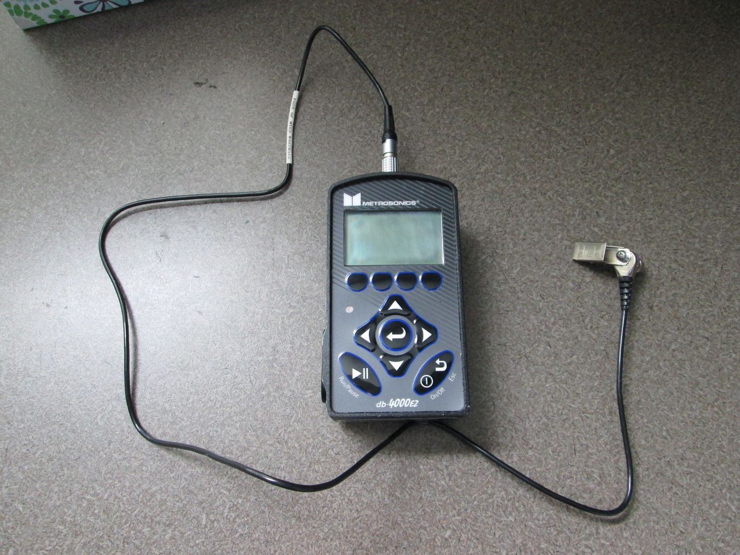

I was able to check out the dosimeter at work and do some readings.
 At Idle: 10' in front of car: 68 10' to the side: 73 10' to the rear: 75 @ exhaust tips: 98 In car windows up: 70 In car windows down: 71
Rev to 6500 RPM: 10' to the rear: 97.3 @ tips: 121
While driving: 60 mph in 5th: 83 60 mph in 6th: 79-80
I would like to get the in car decibels down to the 75ish range if possible, first order of business is putting the rest of the interior back in.
Some readings from the 2.5/125C Fiero (with GT exhaust and no cat): In car idle: 65 cruise at 55: 72 cruise at 65 74[This message has been edited by fieroguru (edited 04-17-2013).]
