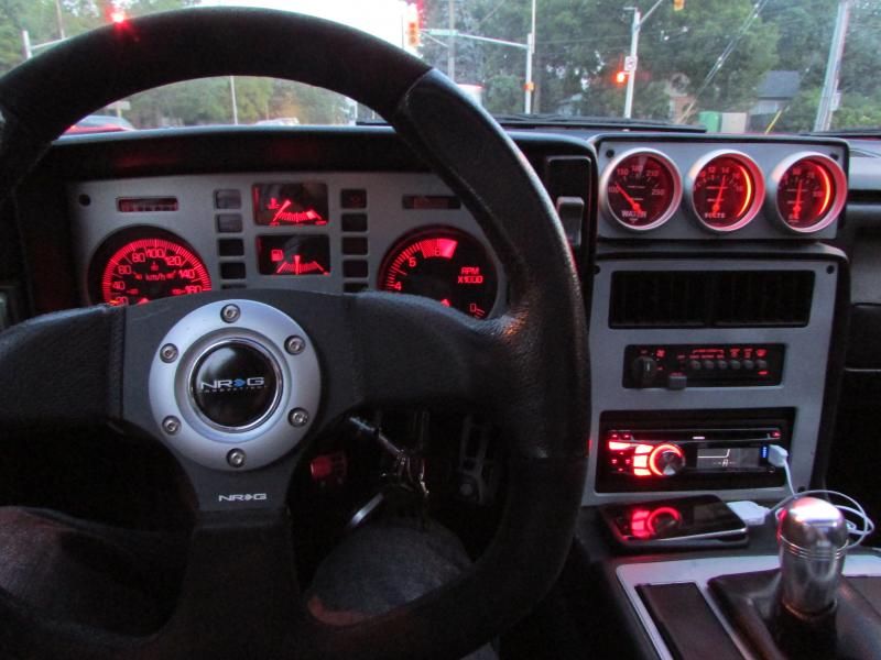

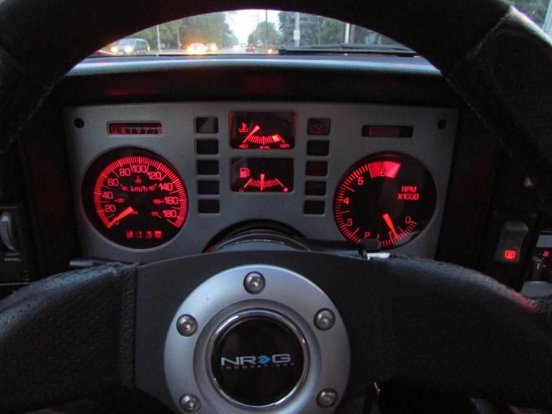

So I recently put red LED's in my instrument panel... now all of my gauges are red
I also got a speeding ticket, yay! and a new camera

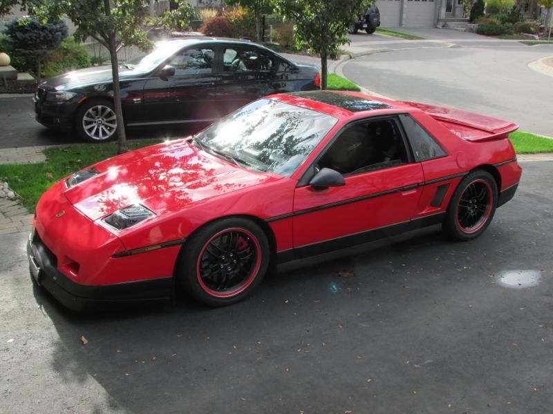

I got the rear decklid and wing repainted. I also painted the rear engine vents myself:
I also had the front lip patched back up, and I painted that too:

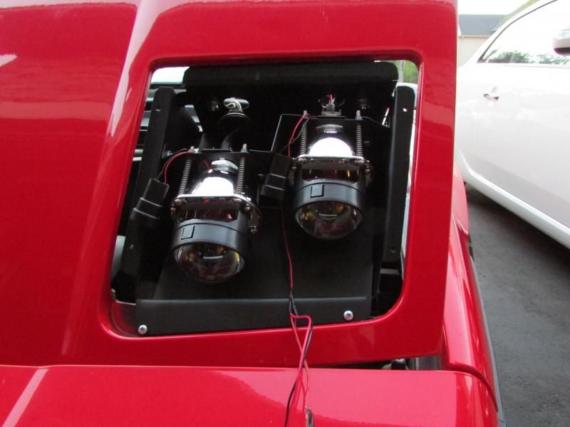

I've also been putting together a more finalized version of my headlight kit for myself since I've had my prototype set installed for a long time now. The prototype set was a little rough around the edges and I wanted to do a set properly for myself.
First, I had all of the sheet metal pieces powder coated in black. I would highly recommend powder coating for anyone who buys a kit. Find a local guy to do it for you and it shouldn't cost that much.
I also ripped out all of the old wiring since it was a bit of a rats nest. I originally threw together a harness quickly because I was excited to get the lights working. This time I'm going to do things right. I started off by making a bracket to which all of the ballasts and relay harnesses will mount to.
This is as far as I got today. I'm waiting for a few other electrical connectors to arrive, and I have to make / paint a new set of lenses for myself. My original prototype lenses were hand cut, where as the new ones are CNC cut.

Got the headlights back in, wiring is much cleaner than last time, however, it could still be better. I still haven't made myself new lenses, so the old lenses are being used.

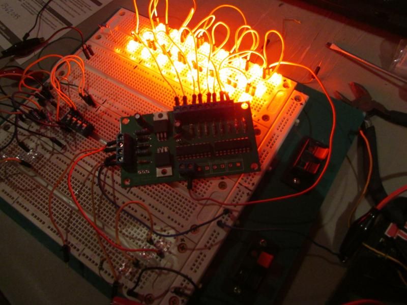

Then I had a few requests from members to make a sequential set up for the LED tail lights. I ended up delaying the release of the lights, and taking on this new challenge. I also wanted to make the whole package more professional looking so I designed some boards and had them made. I recently received the boards for the sequential controller and soldered them up. They work great! I also have some custom boards I designed coming for the LED panels too.
Take a look:
Here's a video with an explanation/demonstration:
This board is for the notchback lights (brake/turn combined into one LED panel)
I also have boards designed for the GT lights and they're coming soon!
The whole process takes a while, but I'm happy with how everything is turning out so far and how these lights have evolved.
