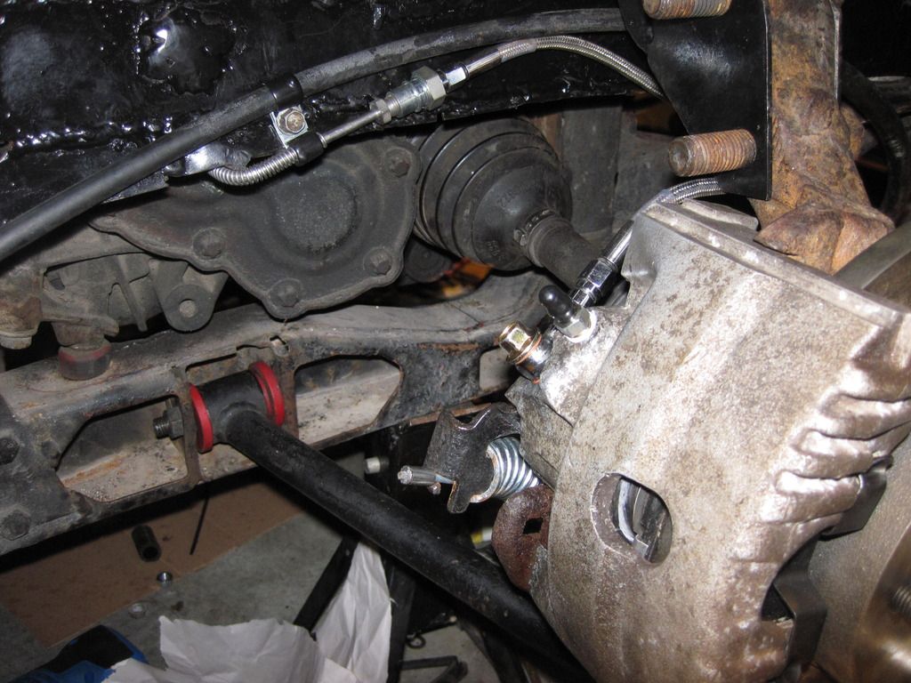

Got one of the rear calipers rebuilt .I nearly gave up on it because I broke the bleed screw , but I finally managed to get most of the threads out .I had to drill it out and then drill a 1/8 hole through the remains of the old screw and then make a seat for the new screw with a 1/4 bit .It seems to be holding OK but I wont know for sure until I get it all bled .One of the other calipers looks to be fairly new and in good shape so I am just going to clean it up and use it as is .The little yellow plastic button valve on the piston is a giveaway as to condition .If it is really old , it will be brittle and hard to the touch .Bought the rebuild kits from the fiero store and thanks to Dodgerunners rebuild thread in the how to section .

I used my old caliper piston compressor and some silicone spray lube to get the piston back in.

I got the new to me calipers on and connected .Had one leak , turned out a fitting was still just finger tight .The brakes are all bled now and seem to work fine .The parking brake is not working yet as the seized adjuster broke while I was backing it off to be able to join the cables together .So now I am waiting for the 2 short cables and a new adjuster from the fiero store .The cables that are on the car are original and pretty chewed up .

After correcting a big mistake(pistons reversed) and spending hours adjusting and getting rid of leaks etc , I finally have rear brakes that work with working parking brake .

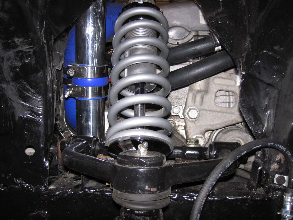

Got the garage all cleaned up so now back to working on the car .Elecrtics are reconnected and I fired it up .Sounds like I am going to be able to do without a muffler .Got the passenger side nuts and bolts all tightened down and got the coolant system filled and burped .I have heat again yahoo .Tomorrow I am going to tighten everything on the drivers side and set the toe on both sides .I set the camber at-.1/2 degree on both sides at ride height today .Pretty crowded on the passenger side , you can see the charge pipe and part of the intake plumbing and heater lines.
