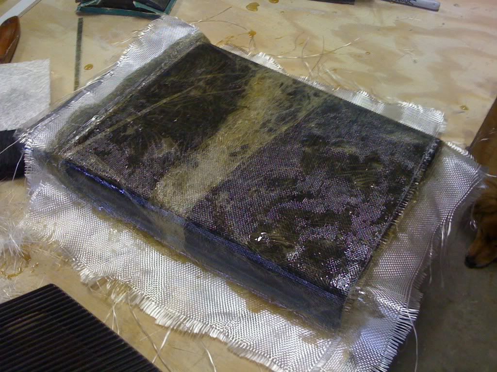

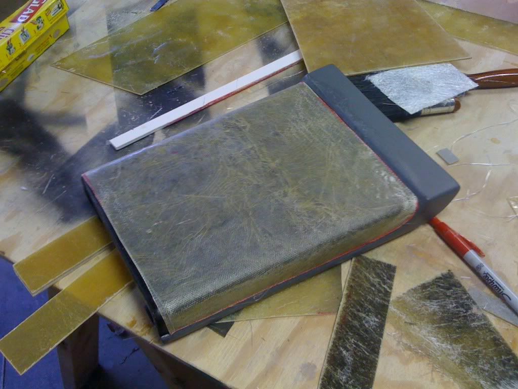

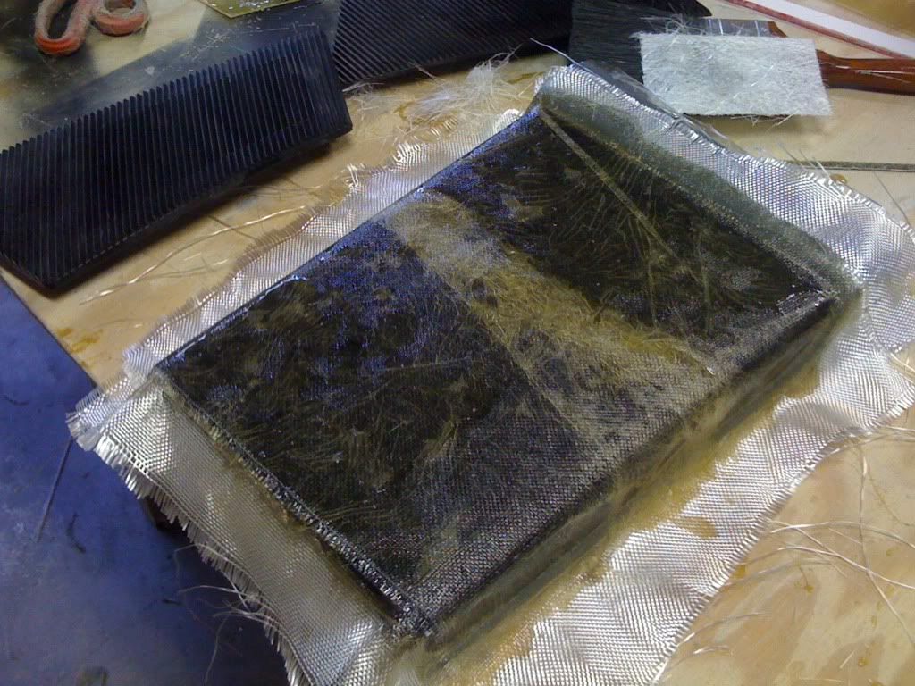

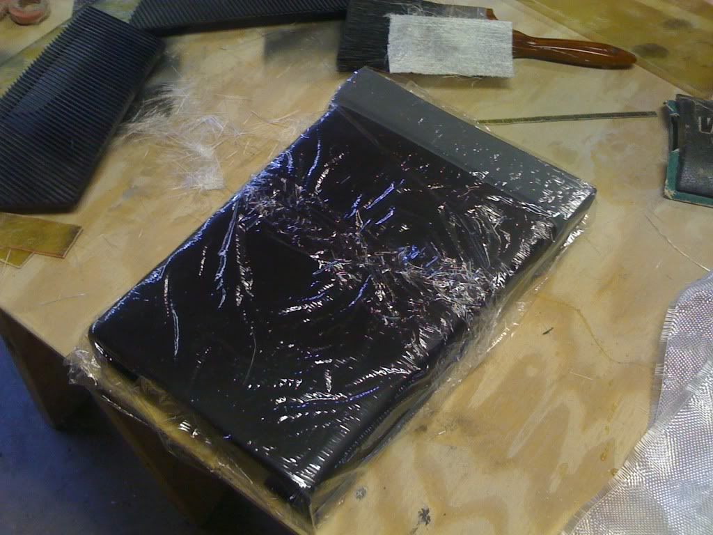

I am a little embarrassed to post these pics but it is an update. I worked a little more on the console and did create the beginnings of the center armrest pad that will fit over the cup holder. But I made a HUGE BOO BOO! I wrapped the armrest with seran wrap not thinking about how the heat from the resin might effect the wrap itself and well... ummmm... it melted... UGH... I wasn't able to get a lot done - had out of town guests.
Wrapping the armrest

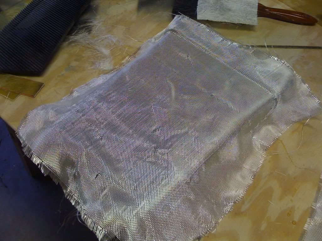

Laying the glass
Adding resin
Second layer of glass

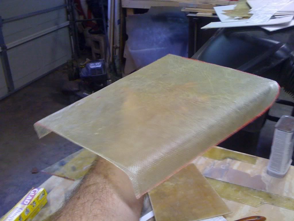

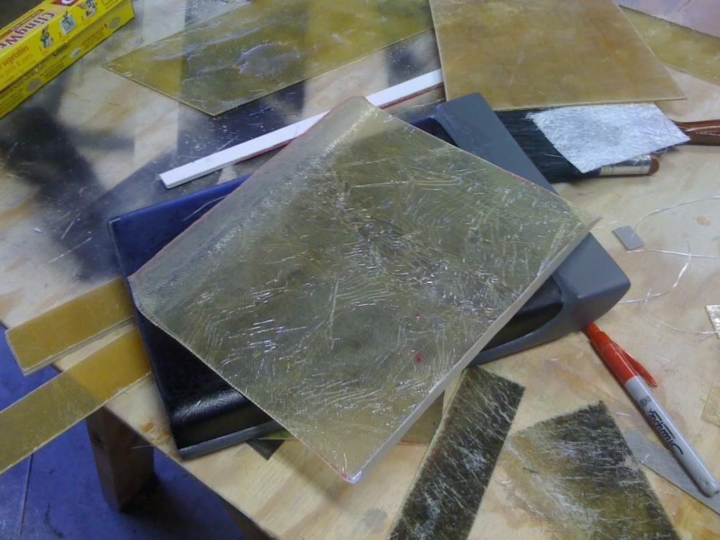

All dried, cut and fits perfectly
The plan is to build another layer of glass and then wrap this in the black vinyl material to match the door panels and sun visors - Thanks to Katatak for the great idea!

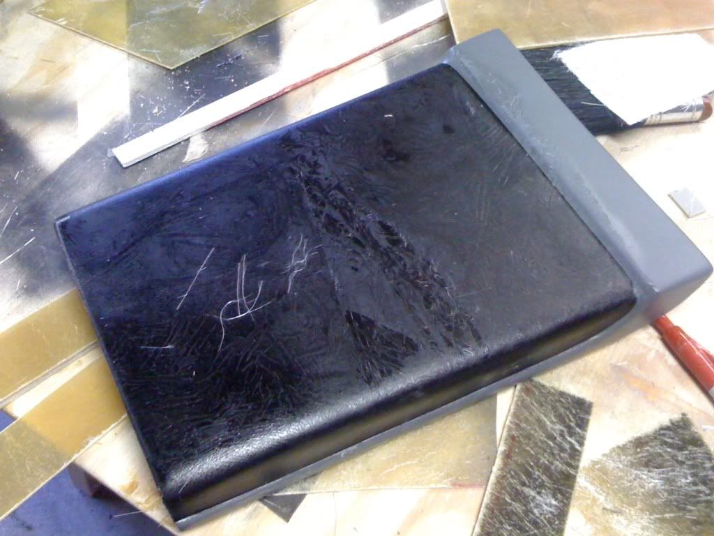

And now the disaster... I have to sand and repaint the entire cup holder

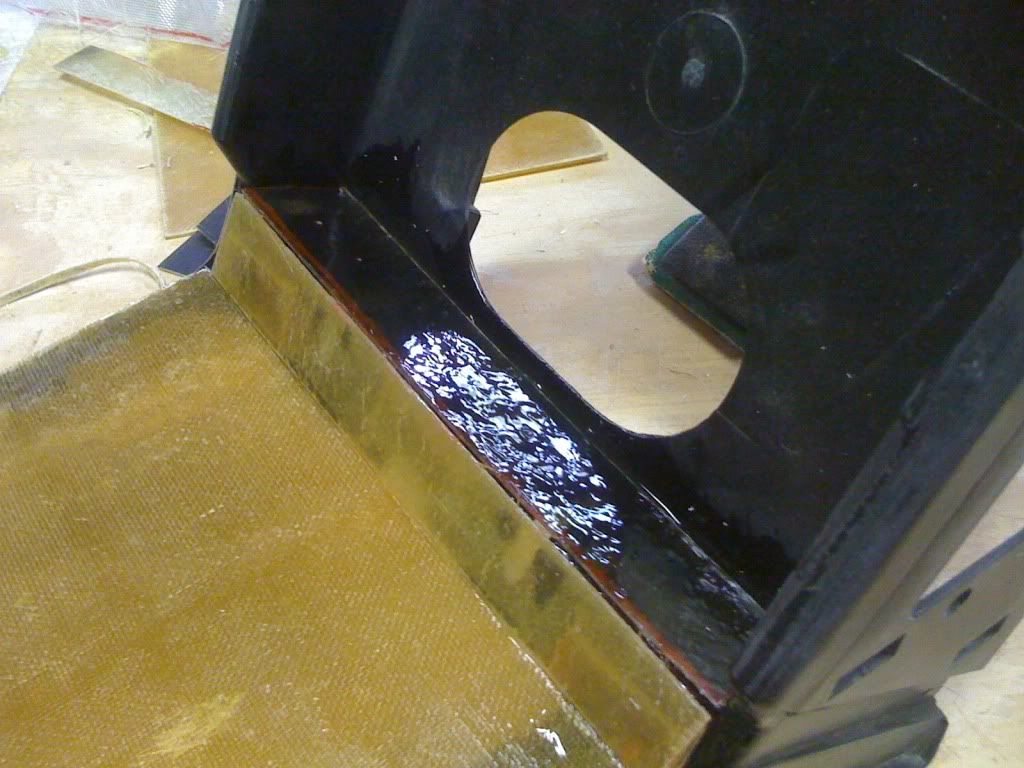

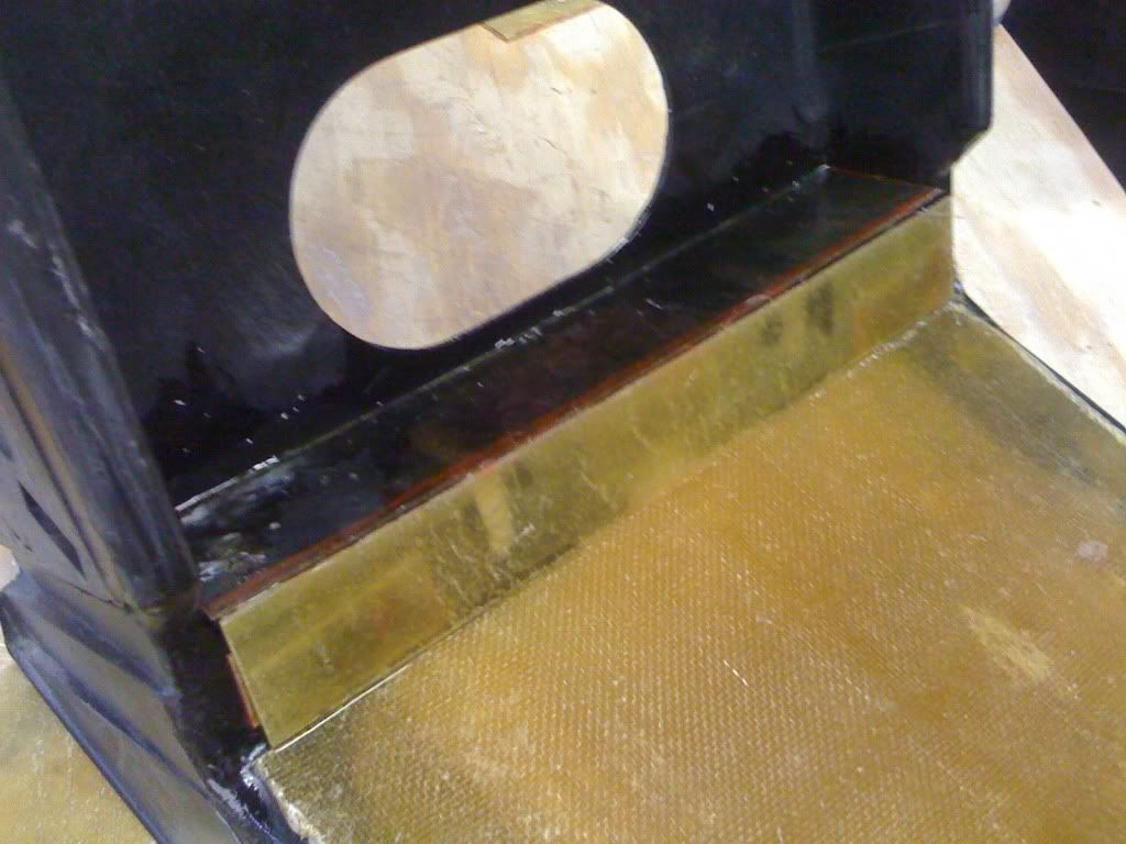

The console receiving a few little updates
That's it for now. I hope to have the new console at least fabricated by this weekend. I also have to get started on the radio console as well. I'm debating whether to use the existing piece I have. That would save time and I think I can manipulate the part into the shape I want. Note to Self: NO MORE SERAN WRAP!!!!

I really have no idea what I was thinking when I used the seran wrap... DUMB!

When I grabbed the wrap... my initial thought was I needed something that would conform and hug the shape of the cupholder so when I laid the glass I got a precise fit. Wax paper wouldn't do it and I certainly didn't want to use packing tape and wind up removing any paint. So... there was a little bit of sanity to my mistake?????? Not much... but a little bit? Right? Maybe?

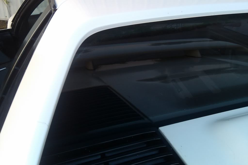

So I'm driving my car this morning when I looked in the rear view mirror and saw this splatter mark right behind my head...
My first thought... DANG IT! I just washed the car. So I got to work, grabbed a shop towel out of the trunk and began to clean the huge poop off the car when I then saw this...
Wait a minute I said... ummmm... where did the poop go? I looked back in the car... I see it... but where is it on the outside... Then it hit me... That huge explosion of bird turd was INSIDE the car! I stood there with my mouth open... HOLY BIRD CRAP! That thing almost hit me! The first thing that ran through my mind was Oliver Stone's conspriacy movie called JFK. "...back and to the left... back and to the left... back and to the left..."
