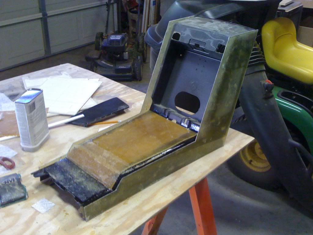

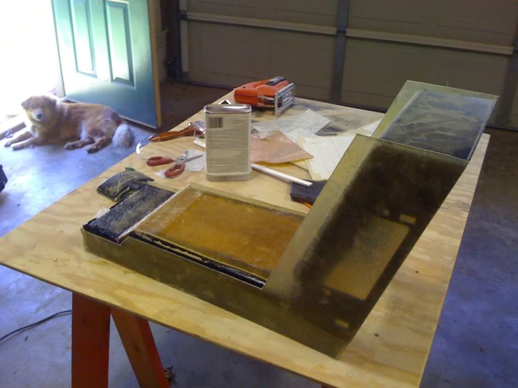

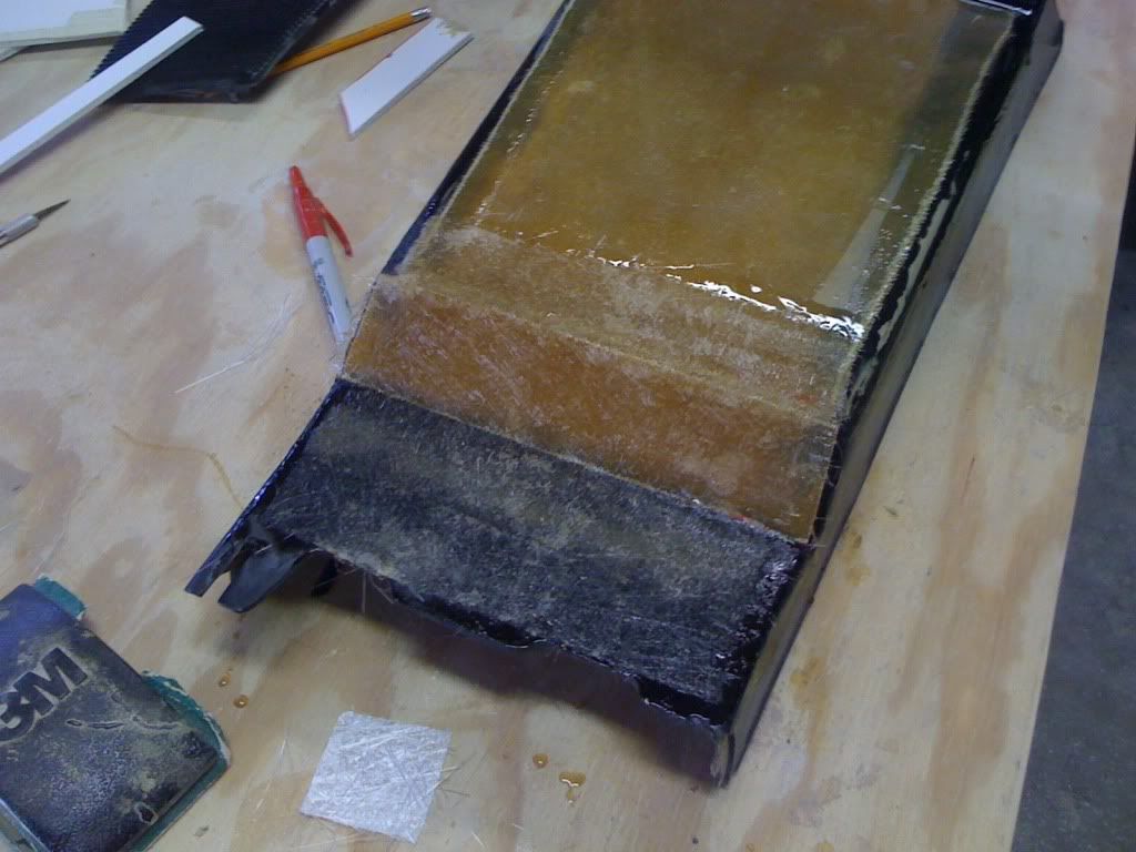

WOW! What a fantastic weekend! Perfect weather for working outside. I got started on the new console and was hoping to get most of it finished when a main pipe glogged up and flooded the guest bathroom. Anybody who has had a toilet overflow "kinda" knows what I'm talking about. A main pipe is FAR WORSE! But all is fixed now. The flood did bite into some precious glassing time but I was able to get a good start.

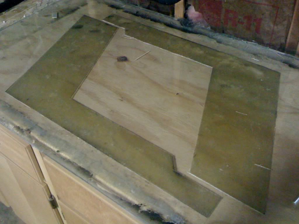

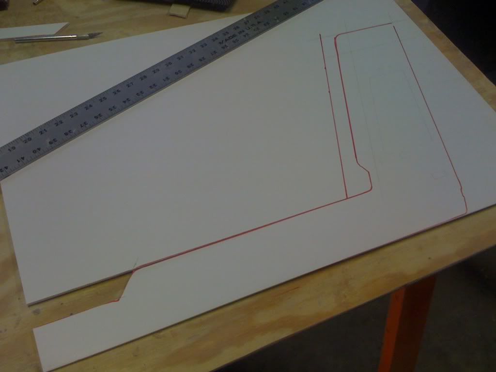

Marking out the new slides to the console

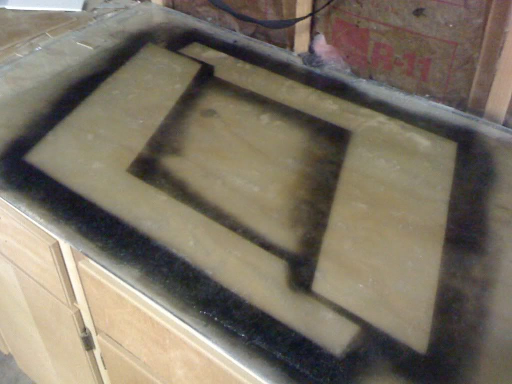

With glass laid, I then took the foam core cut outs and laid them across the drying the fiberglass. I then sprayed paint over the templates to get the outline needed to then cut the glass
All done

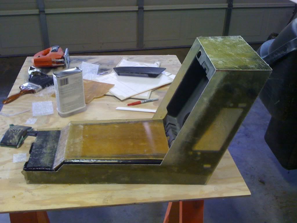

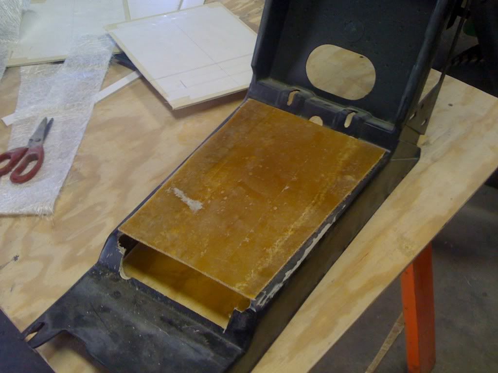

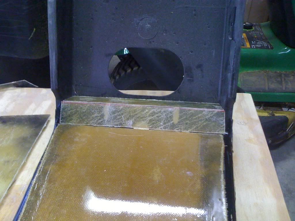

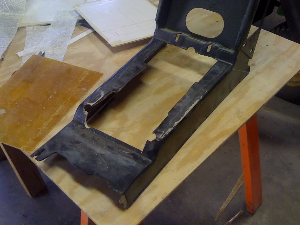

This was the original console I used. No sense in letting it go to waste. First thing... fix the hole

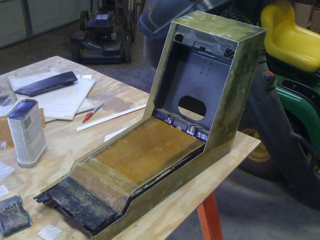

With the side pieces now dried, I peeled them from the piece of glass and placed them against the console for fitting
I will include the stock vents on this version. I have to get air to the ECM
With a top

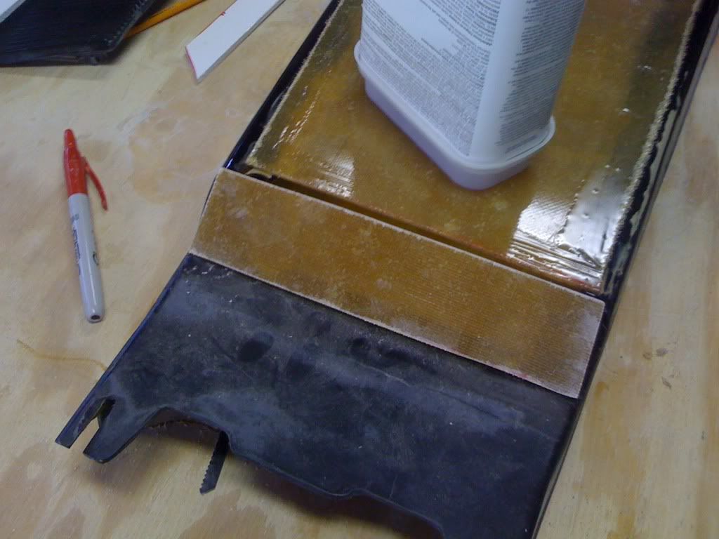

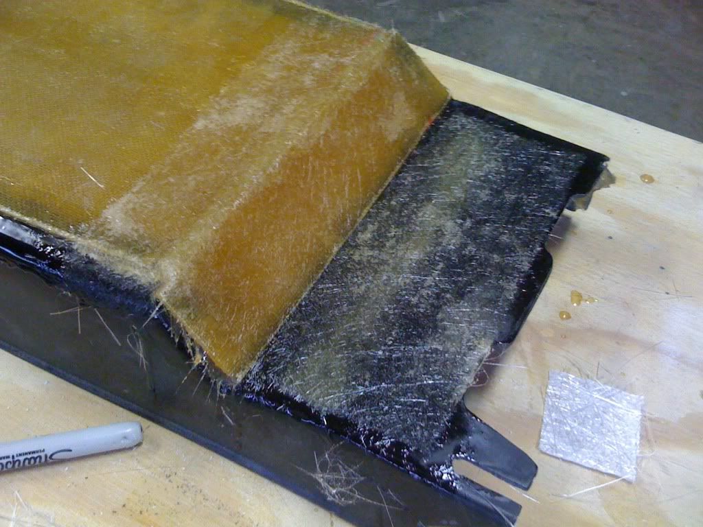

Working on the inside - I need to fill all the unwanted holes. I'm going to create a more functional storage area in this console.
That's all I was able to do. I was really bummed when the main pipe glogged up... I was really hoping to get more done. But with the weather changing... all is good!
