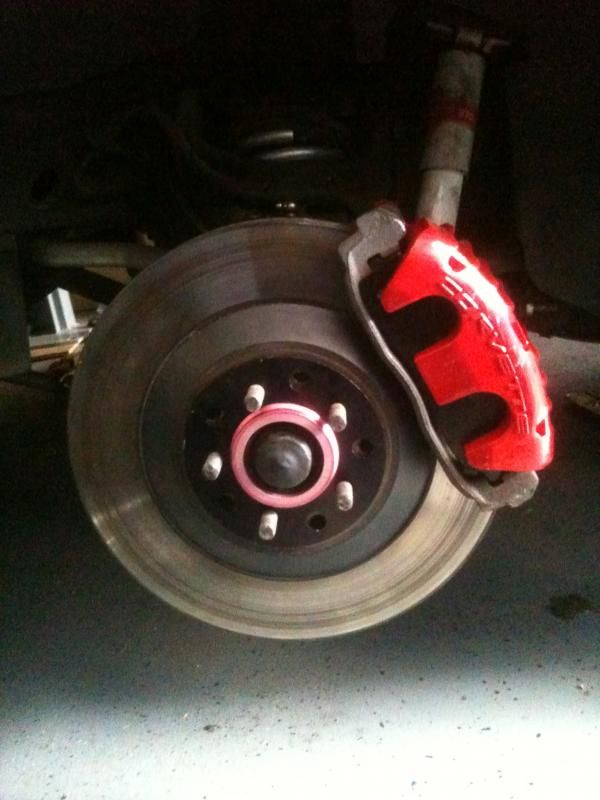

It's an 84, with 88 front suspension. As it turns out, my calipers need to be tucked in closer to the hub. I'll have to remake my brackets and add about an 1/8" spacer to the wheel hub.
Bob
Sounds good, I saw your post about your brakes in the general section. They look great!
This is where I got to today:
Test fit with the wheels on as well and they clear now. I also turned lock to lock and there is no contact. All in all a great success. Just need to bleed them!

Look pretty good, and thanx for the comments.
What size wheels will you be using?
Bob

doublec4 APR 08, 06:16 PM
Bob
17" Enkei RPF1 replicas
doublec4 APR 14, 08:32 PM
Bled the brakes today, bled the clutch, and started it up for the first time this season. If you haven't been using speed bleeder screws to bleed your brakes you've been missing out. Unfortunately my speed bleeder screw for the slave is still on it's way from Rodney, but I'm sure it won't be the last time I have to bleed that clutch!
New brakes look awesome. Can't wait to take it out for an actual run this week.

jb1 APR 15, 01:41 AM
Looks great !! What are you doing for the rear brakes?
87 GT

doublec4 APR 15, 05:53 AM
Thank you,
I originally had the Lebaron 11.25" swap all around, so I took the front brakes and moved them to the back. They were the calipers from an 85 camaro I believe and came with the slightly bigger piston than the rears (85 seville).
They should be a good match compared to the front calipers in terms of balance. Unfortunately they do not have any mechanism for an e-brake but mine never worked anyways. I'm going to look into potentially using a spot caliper.
