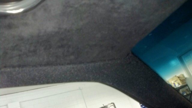

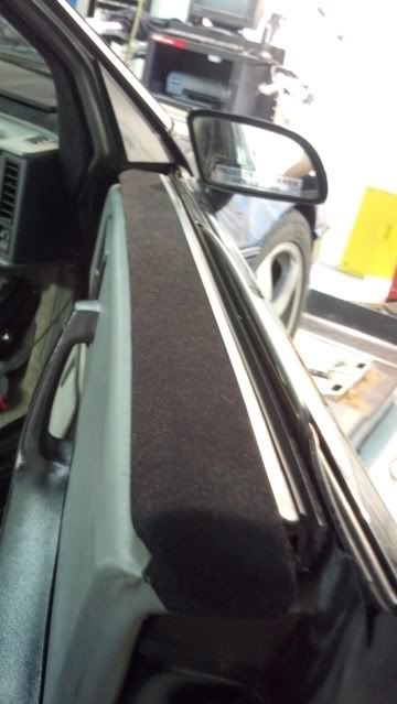

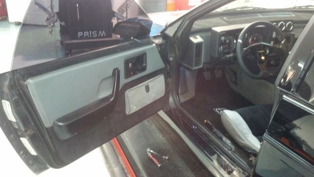

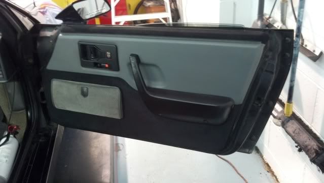

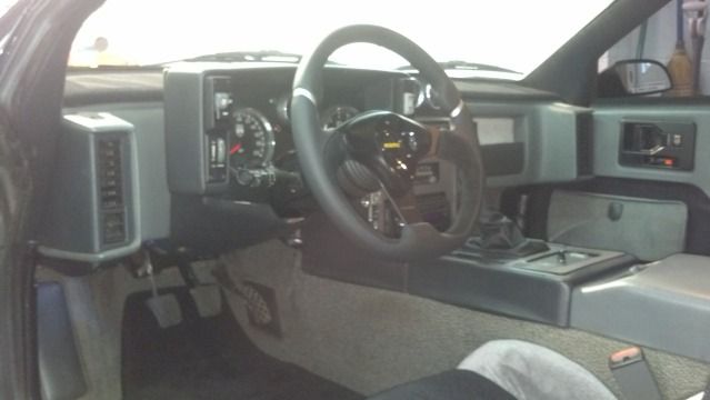

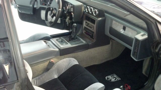

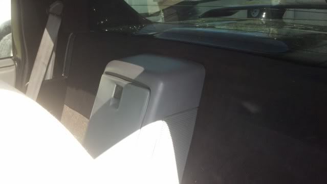

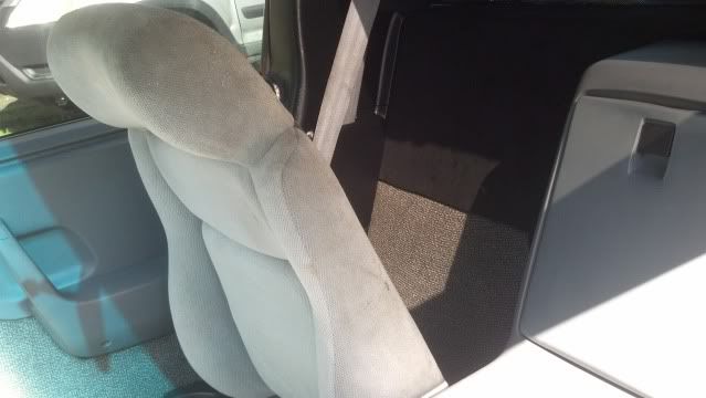

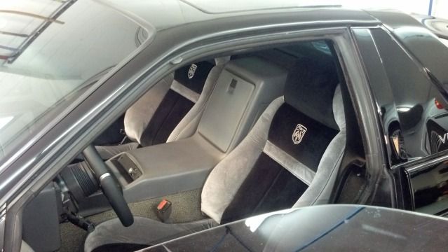

Here are the completed interior pics. The current modifications include:
suede headliner, rear covering below window and lower portion of door panels
flocked dashboard, rally gauge cover, upper portion of door panels, and A-pillars
Speedhut gauges and updated climate control lighting (courtesy of Charlie64)

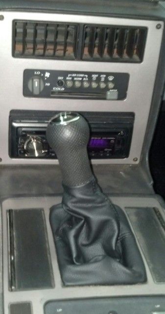

shortened shifter with new shift knob and boot
painted B pillars, floor trim and door arm rests
Momo steering wheel
All new interior swap wiring harness
loyde's custom floor mats with Fiero logo
Mr. Mike's full cloth seat covers (Joey absolutely hates non cloth seats, so we waited until Mr. Mike's made the full cloth GT style)
New window tint 5% rear, 20% sides
Here are a bunch of pics:

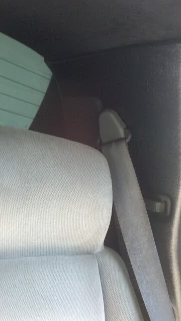

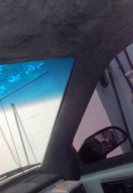

Factory VW shifter....modded to go as short as possible without swapping to an Audi TT style shifter. It is a little shorter than the stock Fiero one now.
Flocked A-pillars and suede headliner

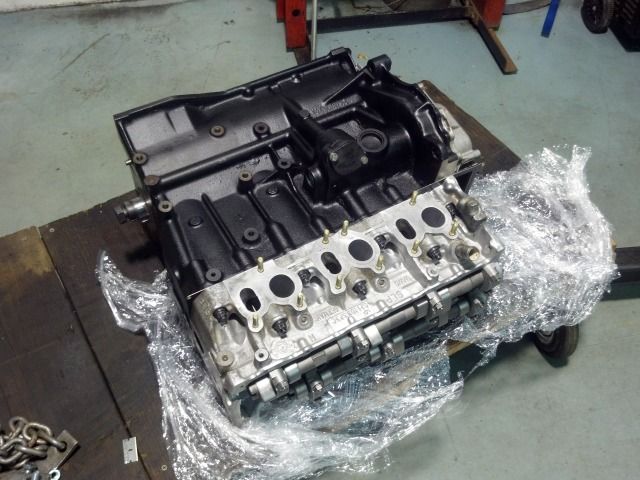

I took the oil pan off to take a look inside and decided that it was time to refresh the engine. I ordered this long block with some of their add on goodies.
http://www.spturbo.com/onli.../short-block-54.html

bmwguru NOV 09, 12:59 PM
Here is what we picked up yesterday.....Looks like I'll have a fun day of work ahead of me in the near future. Also, I met the owner of Schimmel Performance and he is a great guy to do business with. In his shop has to be the largest collection of VR6 engines and VW swaps I have ever seen.

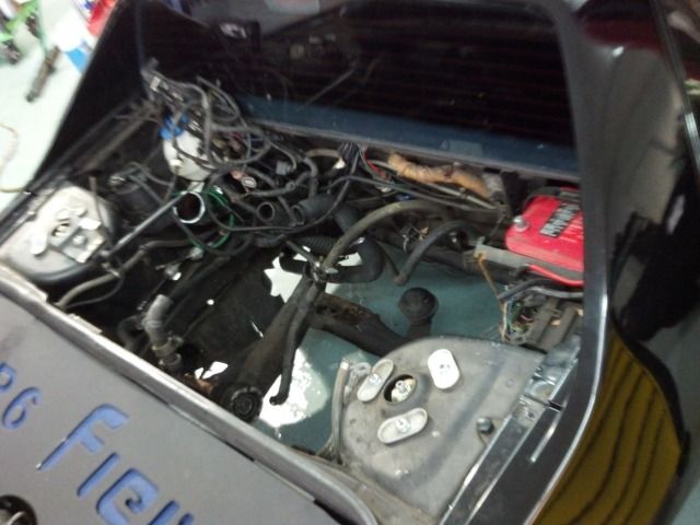

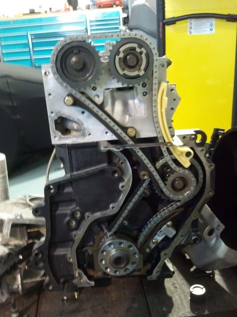

Found a free hour to remove the drivetrain and swap the stuff over. I wound up pulling it out the top so I could keep the cradle in and push the car outside when I needed to.
Found a cracked timing chain rail, so I ordered new timing components. The timing chain on this engine is on the flywheel side, so I'd rather spend the money now than do it again later.
I hope to have it all assembled and ready to go back in by this weekend...or so.
