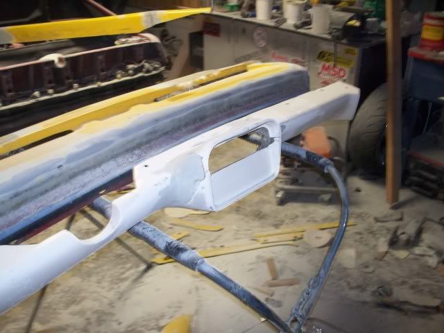

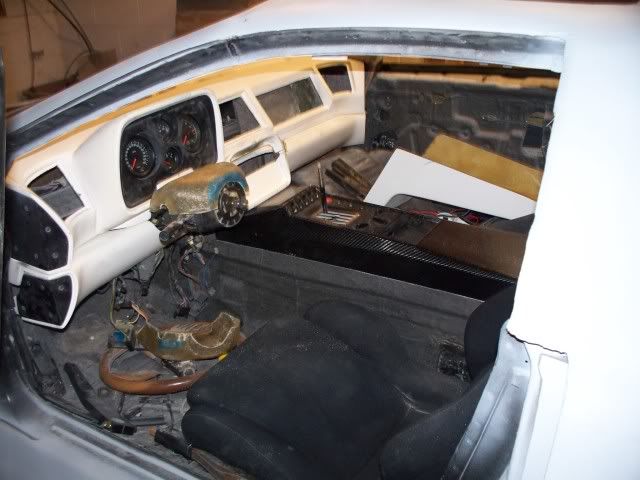

Last night I was able to get some pic's not all that much to see, I fitted the console and to do so I had to cut the lower dash and move it up. at this time it is just sitting in place because I am still deciding where I want it to go. I am also working on a 355 style cover to go on the column that I made using a real 355 cover. it will take some work but I will get it. D.

How far did you have to move the dash center? I know from before that spyderdash sat pretty low on the tunnel.

once I cut it appart I had to move it up about 1-1/2" up and about 3/4 out from the dash. then I cut the center up and took an inch out of it. the stock setup has 3 gadges on the top and the stereo on the bottom. on my set up I am going to use a nav. Kenwood that is larger and I will make custom gadge pods for the Apiller. D.

I got the bottom dash back together this weekend. I still have to finish it out but getting closer. D.

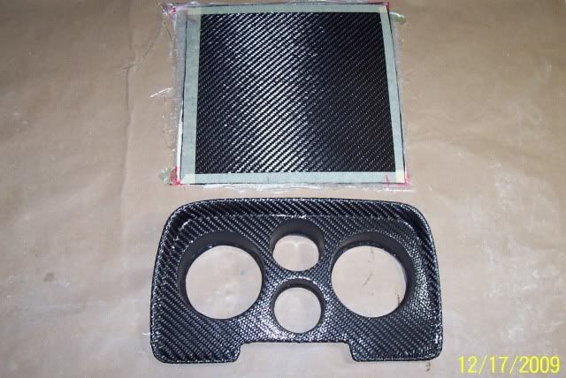

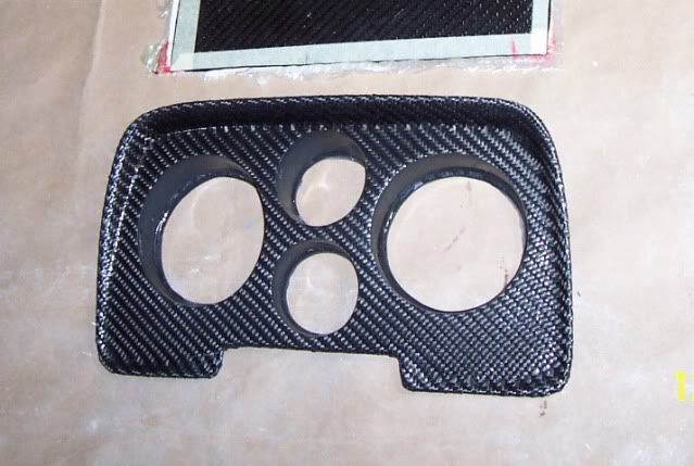

Ok, here is a little update for all. I have been working on the DD as of late to get it done and back on the road soon. but I have not given up on the choptop. the one thing I will say about my choptop is that it is always changing at least my plan for it is. it is moving forward slow at the moment but I will be getting back to it very soon full tilt. Rob AKA Amida is working on some more parts for me that I will have back soon. here are some pic's that he sent me last night. what I did was send him the gadge cluster from my car and had him overlay carbon fiber on to it so it would flow with the console he built for me as well as make me a flat piece to use for the trim around the head unit. D.
