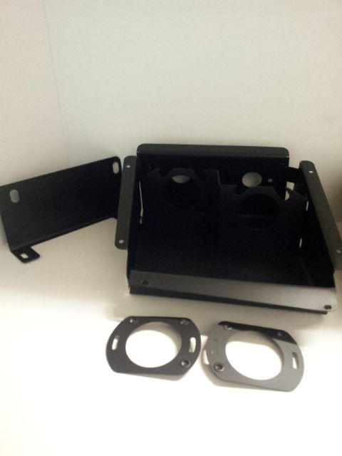

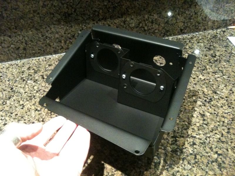

doublec4 FEB 21, 08:28 PM
Since the lights in my car were prototypes, I'm putting together another kit for myself that better represents the newest REV2 version of these lights.
Just got the buckets and brackets powder coated by a member on here, OneQuickGT, and they look awesome! I would definitely recommend powder coating the buckets and brackets for the best results and a durable coating.

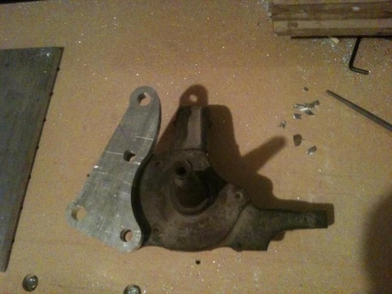

Also, I designed some brackets to put C5 Corvette front calipers on the front of my Fiero. I will be switching my Lebaron fronts to the rear and installing a proportioning valve. I've done a few calculations and I may not need to adjust the bias but we'll see with some testing.
This is what the bracket will look like:
Here is one of them cut. I also cut the stand offs (not pictured). I'm considering having them welded to the main bracket but I would have to take it somewhere for that (6061 aluminum)
This is my CNC machine cutting them:
If I had to do it again, I wouldn't machine them on my machine. It's actually a CNC Router not a mill. For one offs it worked well though.
