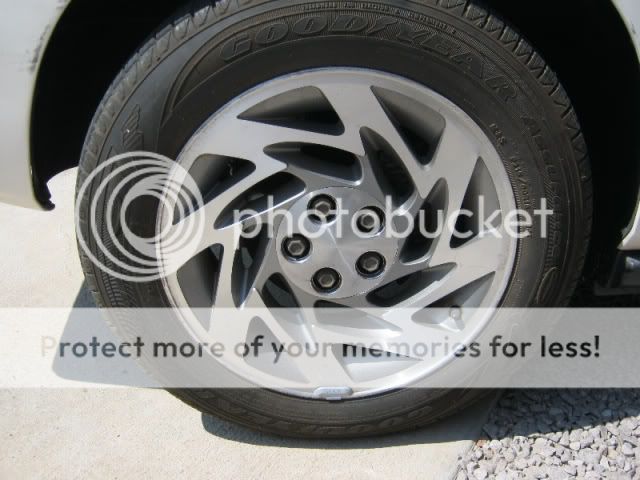

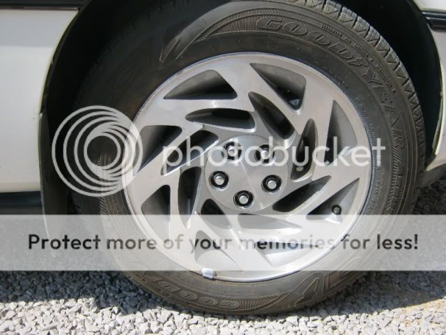

Originally posted by Rick 88:
Pat,
That cap looks better than the original one! I can't remember what the Daytona wheels looked like, but the cap looks great on the Beretta wheel. Good Job!!
I agree Rick - I like the Daytona Cap a lot more than the Baretta Cap. I seriously thought about picking up the Daytona wheels - they look pretty good but would need a rehab plus they are 14s. They have a steel backing with an alloy outer?
katatak JUN 07, 12:57 PM
Managed to get all the center caps completed this AM. Now I just have to decide between the stock lugs or chrome lugs?
Stock Fiero
Chrome
More later!
Pat
