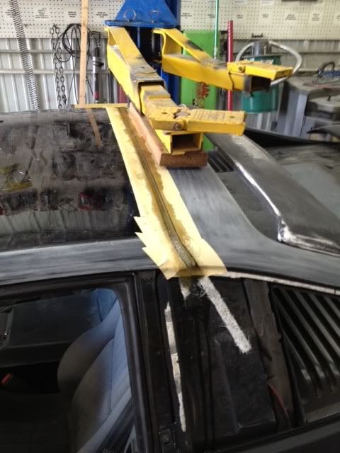

 Layer of glass. The roof wasnt totally flat so with the use of the lift arm i applied alittle "love" to a high area. 3 layers of glass later its pretty solid
Will that area you held down try to com up later and ruin your work?
Bozzie
MAR 29, 01:50 PM
2.5....... The area was just alittle high....didnt take much to level it out. A deep V groove and alot of glass reinforcement should do it. Im going to let the car settle for a year before paint. Anything changes / pops / moves can be fixed before paint. ------------------ http://i252.photobucket.com...ec/2007_12240001.jpg
