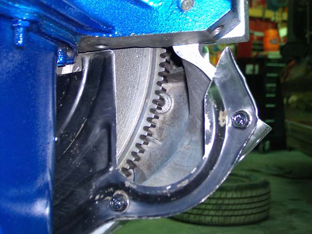

Needing one of these V6 dust shield, (stolen photo from I forgot who):

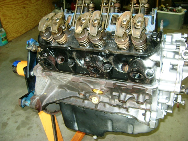

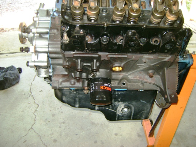

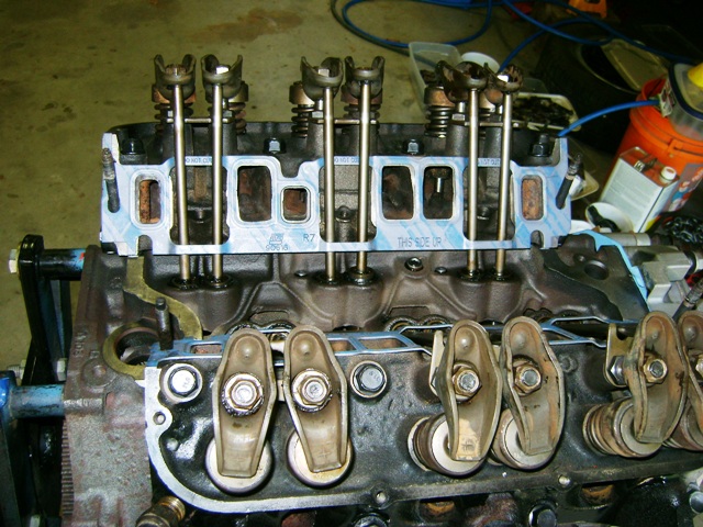

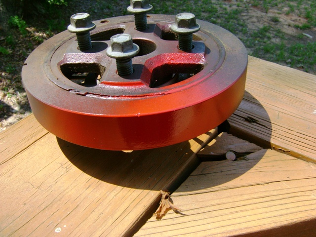

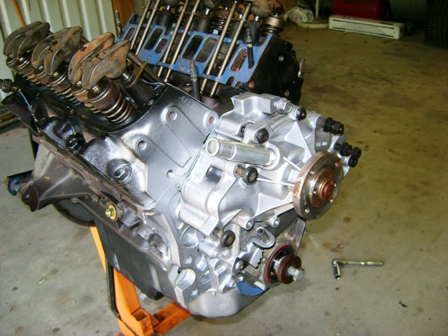

Got a few things done this morning. Cleaned all of the water pump bolts and inserted them into their proper holes. Added the rocker arms along with its two other pieces. Tightened down the adjuster nut until the stud was at the top of the nut. Marked the 3.4 balancer with the 2.8 timing mark. I used red paint for the timing mark, as the rest of it will be silver. Baking in the hot Texas sun before the silver is added. A few photos for your enjoyment.

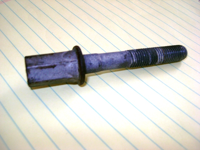

I was cleaning assorted parts and a few bolts today and came across this bolt. The flash changed the color a bit, as it is a silver bolt with the fancy head.:
 I don't remember removing this bolt. This is a 10mm bolt, with a shank of 2 3/4" long. Looks like it had a sealer on the lower end of the threads.
Anybody got a clue?[This message has been edited by josef644 (edited 05-16-2011).]
