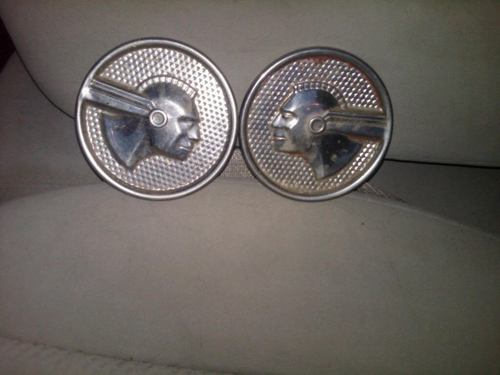

Look what I got for my birthday!
I'm going to repaint the badges with the original background in red, then mount them on the massive B pillar. They're from an early 1950's rear quarter panel on the Chieftan.

bubbajoexxx MAY 13, 01:33 PM
1953 strato chief to be exact

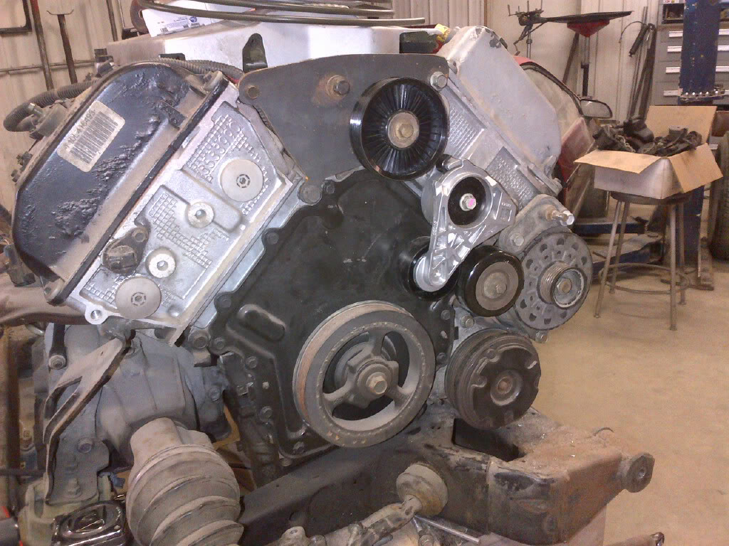

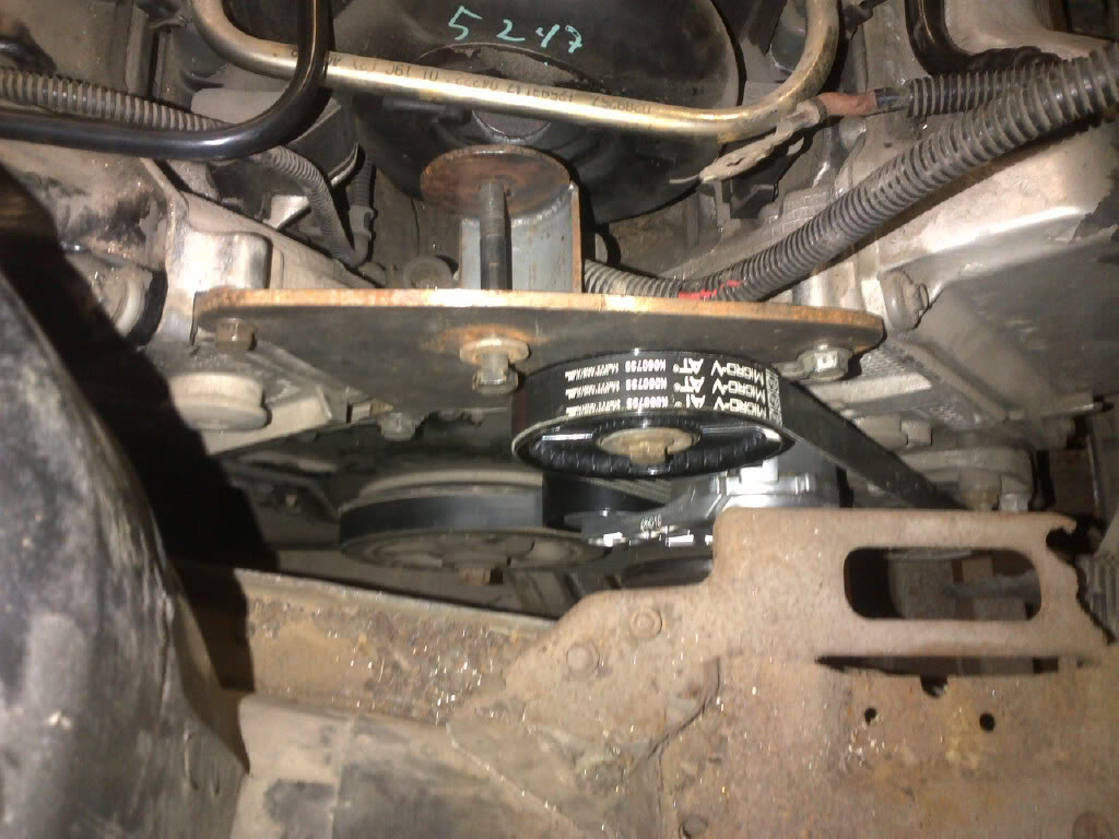

Progress! Pulled the motor and trans out (again) - we're getting to be experts at it. Here are some pics of the pulleys and serpentine belt in place.
While the motor was out, the rear brake lines were installed (from the cutting brakes to the rear calipers) and a bracket for a second dogbone was installed. Then the motor went back in and the car came back off the hoist. Here's a pic of the pulleys and belt back in the car:
