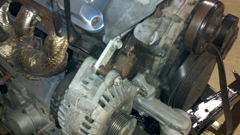

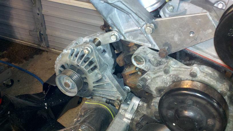

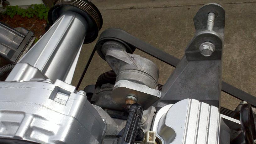

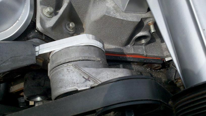

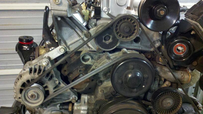

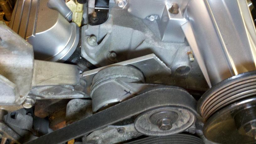

I mocked up my alternator and idler pulley today. The idler is the one from the super charger belt with a smaller diameter pulley from a 2000 Trailblazer. The dogbone bracket was milled down to the flat surface and the idler bracket will be about 5/8" thick welded to the dogbone bracket. The alternator will probably changed to a 1/4" aluminum plate with an extra mounting hole. Once I get the final product done i will post drawings with measurements. Im still revising so this could change.
Edit; Progress. Idler bracket done but still needs to welded. I will post drawings later.

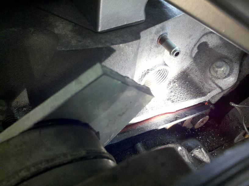

I borrowed a 3/4" NPT tap. I plan to put aluminum fittings in the two antifreeze lines. I dont know will they have to be straight or 90 degrees?
Edit; Sorry, I was being lazy. I went out and looked at it and they will have to be 90 degree elbows. I had to hog out the manifold hole. It looks like i will have to take the LIM back off to install it.

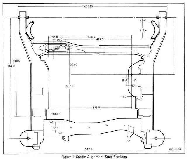

Just wanted to get in here and say what a nice job you are doing on your build. REALLY like that roll around engine cradle cart you made, care to share the specifics or better yet a drawing of it. I would love to have something like that when I start my build, I HATE crawling around on the floor to work on stuff and that looks like it puts things where you need them. Nice touch and again nice work. Having ridden in a 3800sc and having gotten to drive it I think it is safe to say you will NOT be disappointed. Makes for a very quick and responsive car. Too fun!! peace
Pete
hercimer01 JUN 27, 02:02 AM
Thank you Pete. The dolly is from Europe's site.I still havent put the cradle bolts int yet though.
http://www.fieros.eu/?type=diy&page=41&lng=en

I think i got ahead of myself by taping out the heater hose attach holes. I can make the LIM work, but the timing cover will probably have to be replaced or welded. I have a friend who welds aluminum so im lucky there.
