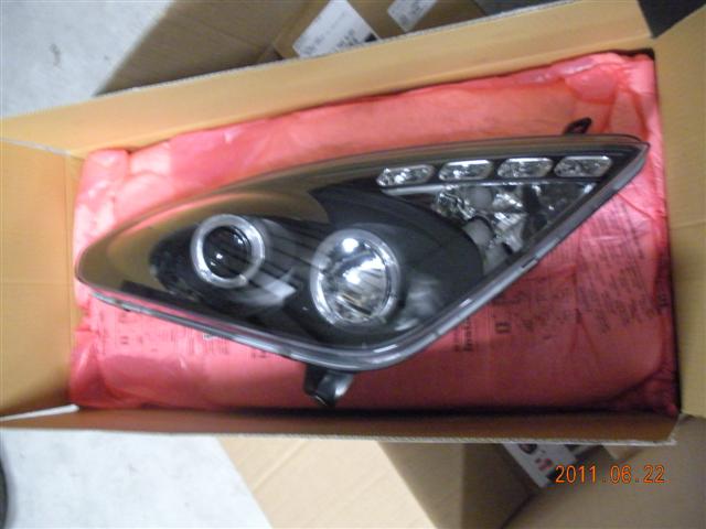

I still have the broken fiero one if you want I will set it in if that will satisfy you. Why do you think I would lie to you? I showed you the pictures the frame is not cut. Back on track, the headlights are in.

ghost187x JUN 23, 11:01 PM
more info on the headlights? can you show us what you have planned for them? thanks and awesome work!
