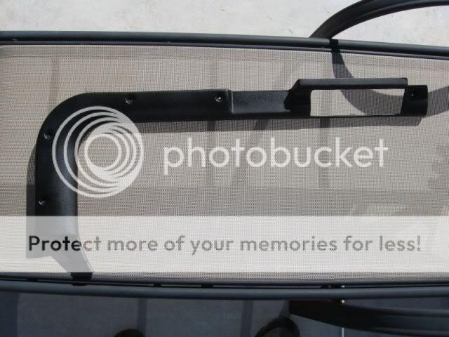

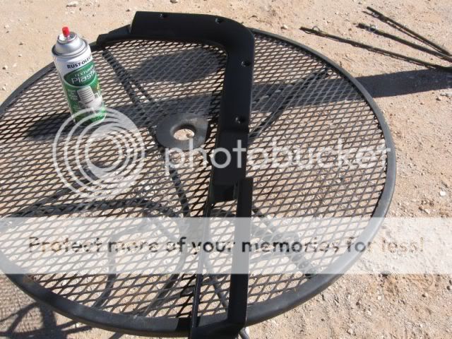

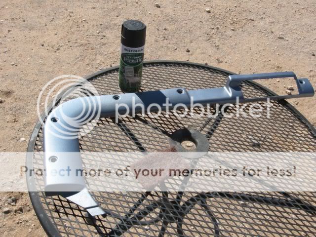

Did some work on the interior pieces today. I cleaned all the plastic with some degreaser then hot soapy water then hot clear water. I used a red scotch birght pad and went over them then wiped em down wiht a tack cloth. I picked up a can of Rustoleum Plastic Paint in the Black Textured flavor. So far so good. I am not sure how it will "wear" but I think it looks good. At least better than the silver-blue.
Ready for paint
After
I put 3 coats on them - letting them dry for an hour then lightly scuffed between coats

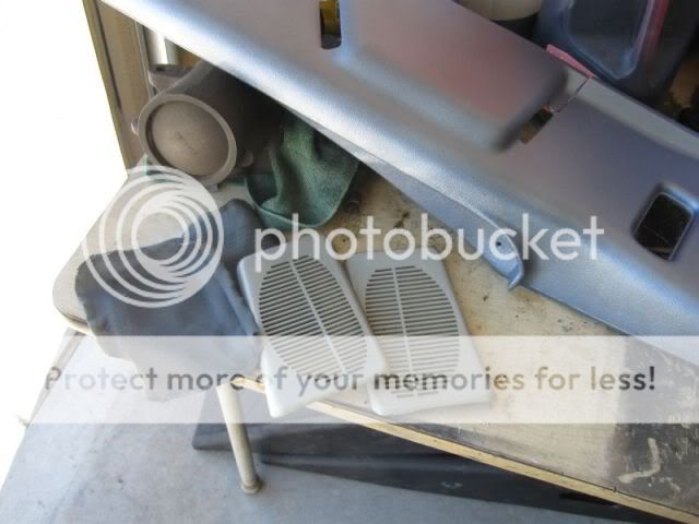

The speaker cover cloth on the B pillar trim was pretty skunky. I wanted to take the grills off so I used my dremel on the back side and cut off the "head" of each stud. I pulled the cloth off and I think I will just paint the grills a dark gray to match the brake light cover and the interior light fixture which I am leaving the factory dark gray. I will come up with some fancy dancy way to fasten the grills back to the pillar cover.
