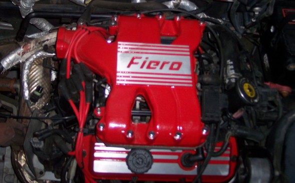

True. I have a Mig welder and I tried it before. Not much luck despite my care. This solution works great and after cleaning the trunk carpet with a pressure washer and finishing the details we're done with the engine and tranny.
BEFORE
AFTER

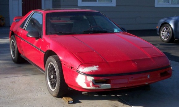

So I moved back to the fascia. I did a trial mounting to make sure everything connected well and that there was no binding. I added a thin coat of filler which still needs to be wet sanded, but it will be easier to do on the car since the subframe will hold the form.

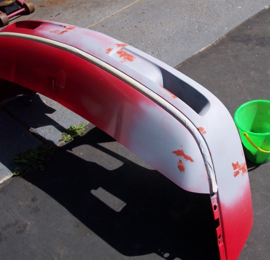

Well I got home from work early today and put in a couple hours. I got the sanding done on the fascia. I need to apply some primer and do some more fine wert sanding but I started with 100, then 220 and lastly 400 grit. With the primer I will use 600 and 1200 grit before masking and painting.

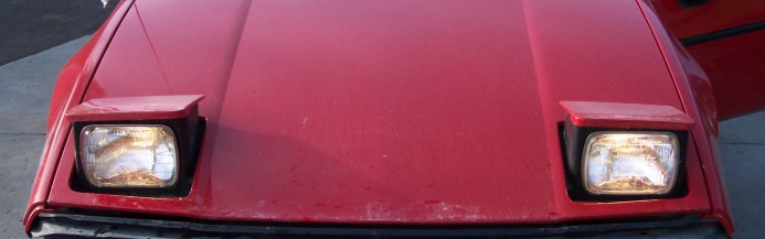

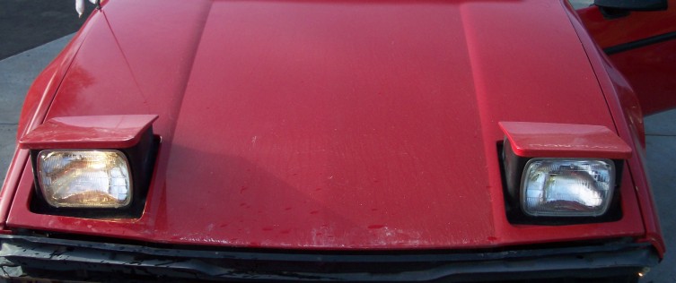

Mechanically the car is pretty good but I did need to bleed the clutch and take care of one little thing. Can you guess what it was.
I had a spare light. Took about 20 minutes.

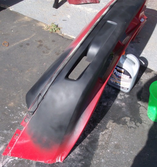

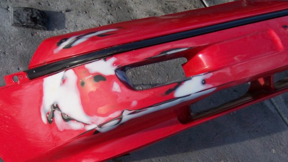

Alternating gray and black primer with a dab of spot putty, I got the smooth look I wanted. It is not 100%. The start and end point of the tear is bumped-up a little. I took it down as much as possible but there is only so much I can do with what I have. I'm OK with that. I will repaint the car one day and when I do I will replace the fascia anyway. This is a low buck repair that will look good until that repaint day comes. My cost to repair this fascia comes down to one pack of JB WELD, two cans of primer, one tube of spot putty, and one can of factory red. Total cost, around $35.
Last coat of primer
And finally a rattle can of the factory original paint. I will let it dry over night and then I will hit it with some clear before the final wet sanding and buffing.
