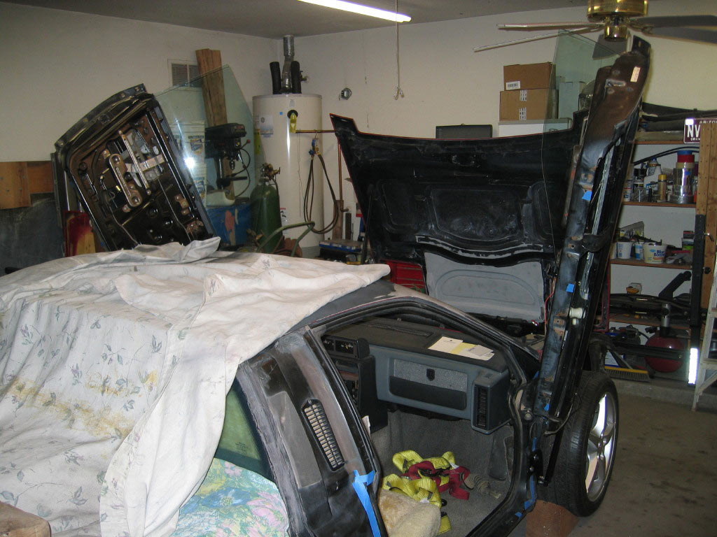

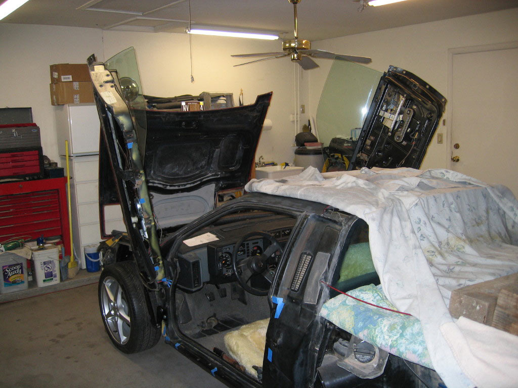

cptsnoopy FEB 14, 02:13 AM
Got the other side mounted.
Charlie
