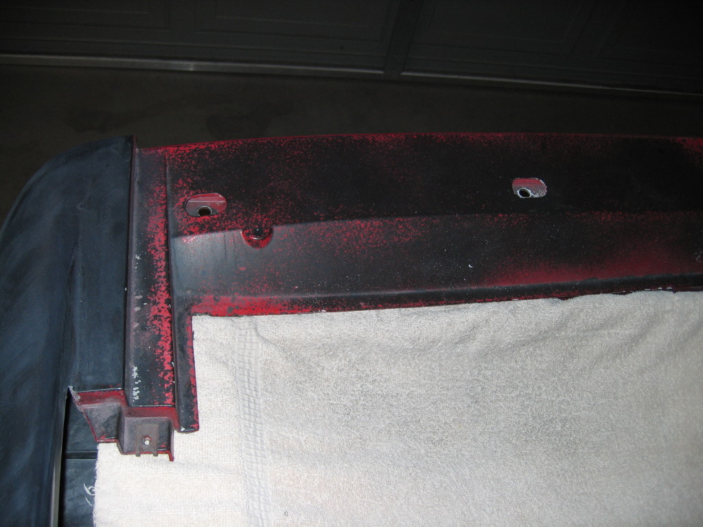

Finally got back to sanding. My biggest worry was the forward section of the roof panel where the sun rot had crusty and cracked black paint/primer showing through the red paint. It was taking too long to cut through the old paint with 320 wet/dry so I grabbed some 220 dry and got down to the SMC in fairly short order. I am happy to report that the SMC surface appears to be undamaged and if the primer sticks it ought to look fine when painted.
Charlie  [This message has been edited by cptsnoopy (edited 10-15-2010).]

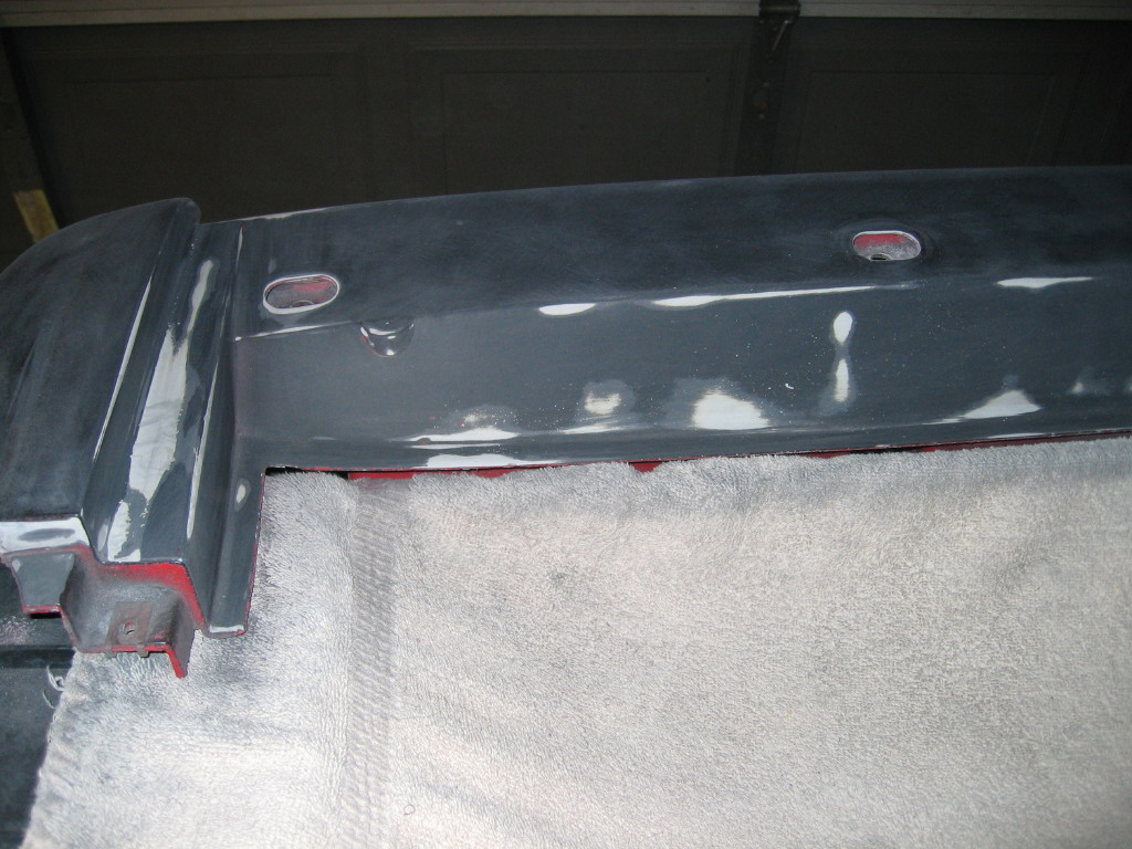

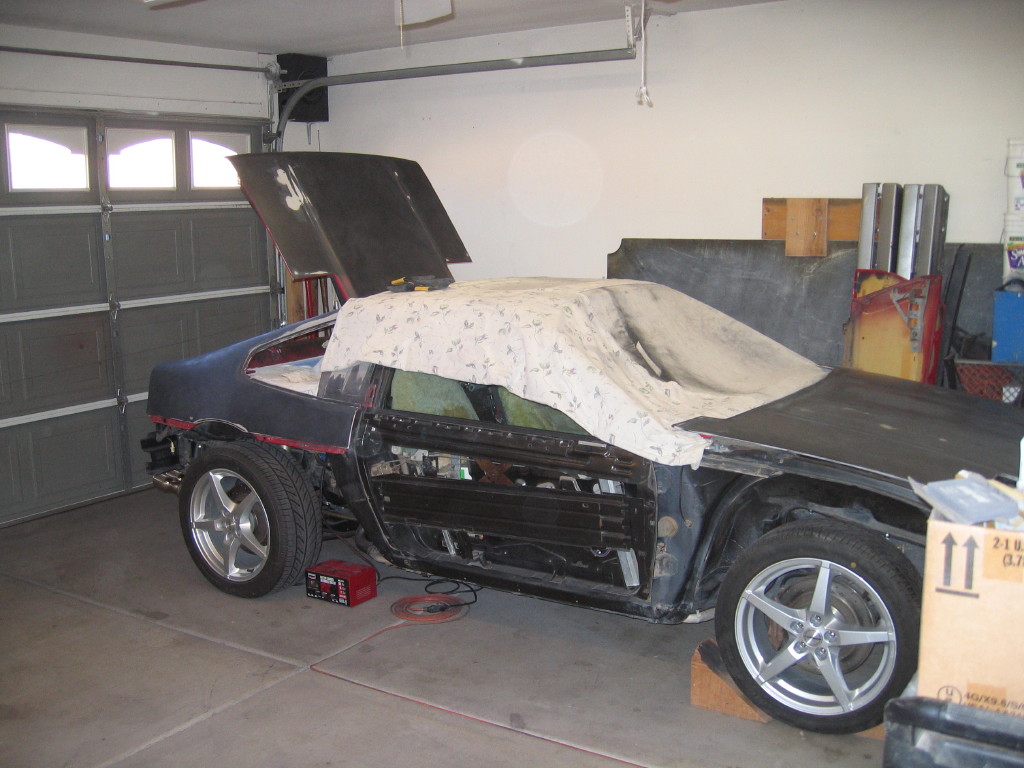

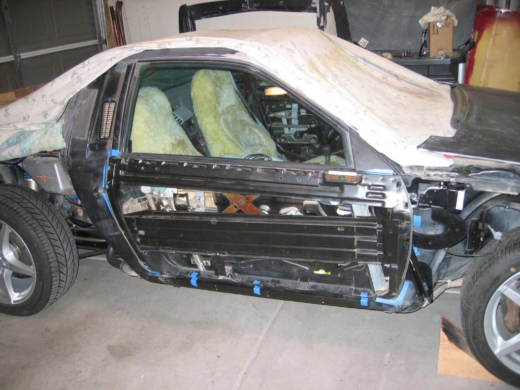

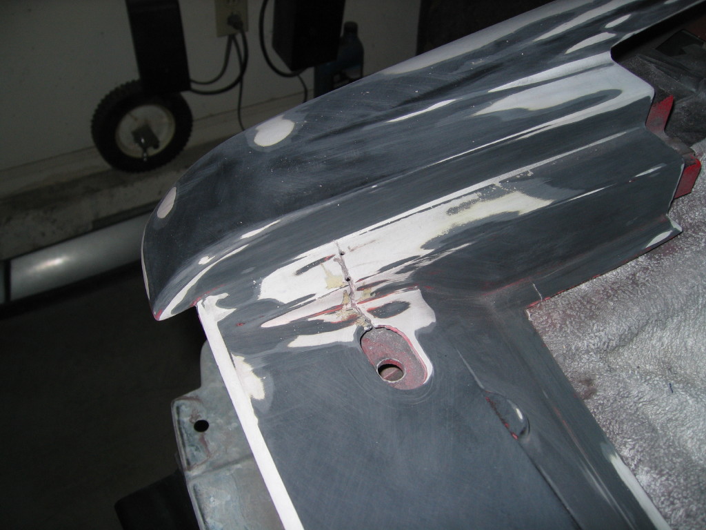

cptsnoopy

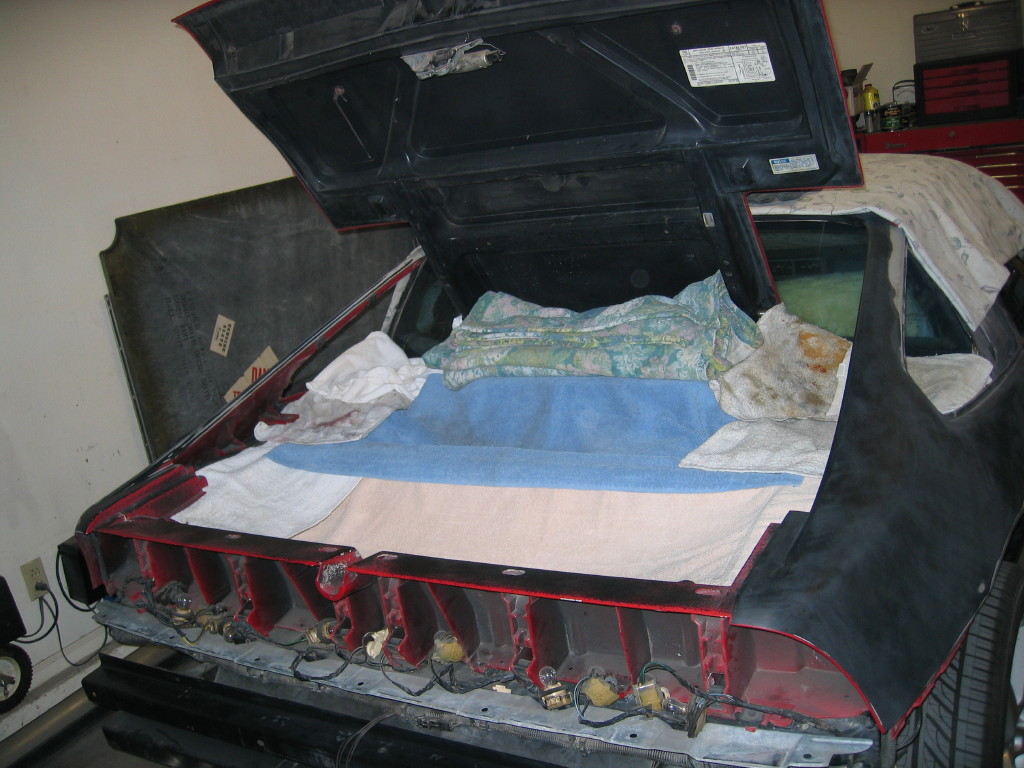

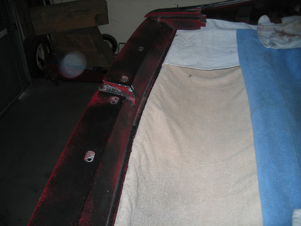

NOV 21, 11:44 PM
Little to report. Sanding when I can. Pics below show tonight's effort. Last pic shows where I need to do another SMC repair. I suspect that this was like this from the factory as I can see some body filler in the area.
Charlie

Lookin' good there Charlie. The sheepskin seats have just got to go though! Curious, who makes the wheels you bought, and what are the dimensions and offsets?

Yep, the skins are covering some seriously sad seats... I hope to get some nice new seats once I am sure the car will be drivable. They are so easy to get to I decided to put them low on the priority list.

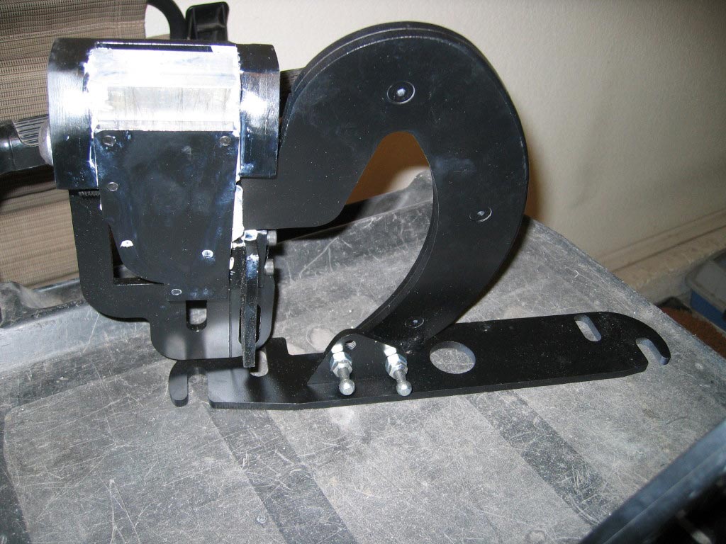

cptsnoopy

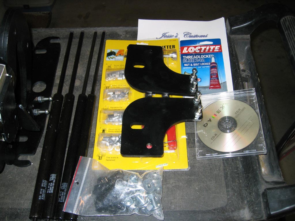

JAN 26, 02:20 AM
Another box of goodies has arrived...
Charlie
cptsnoopy

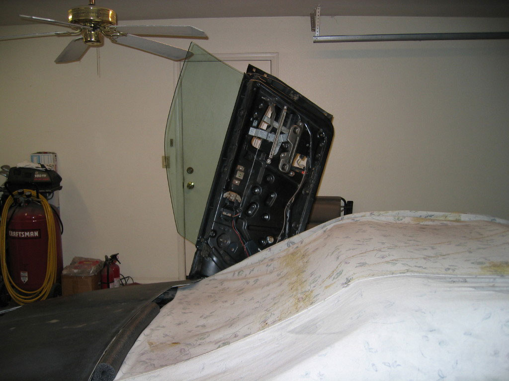

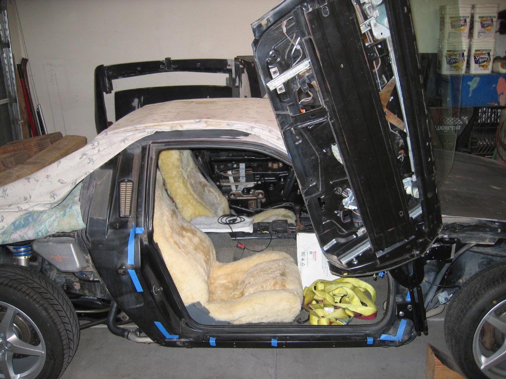

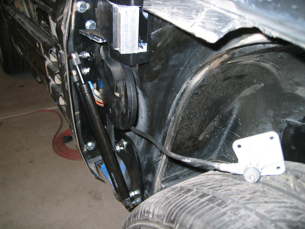

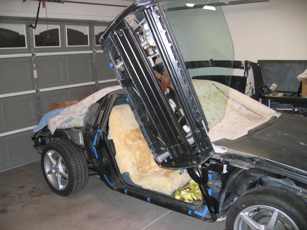

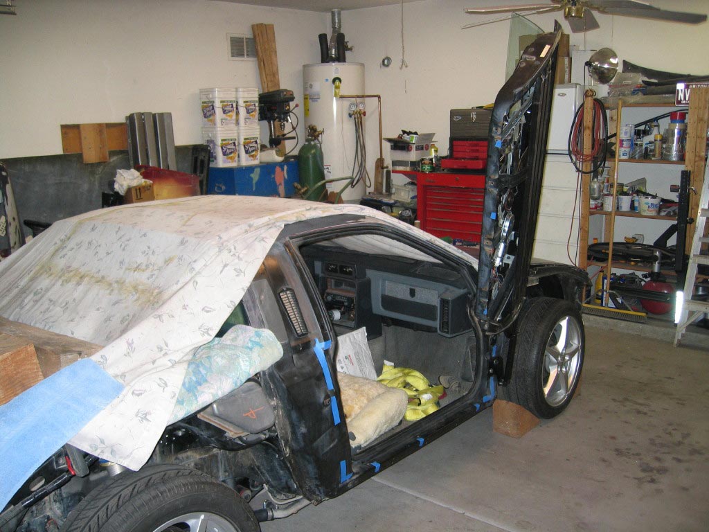

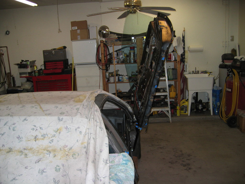

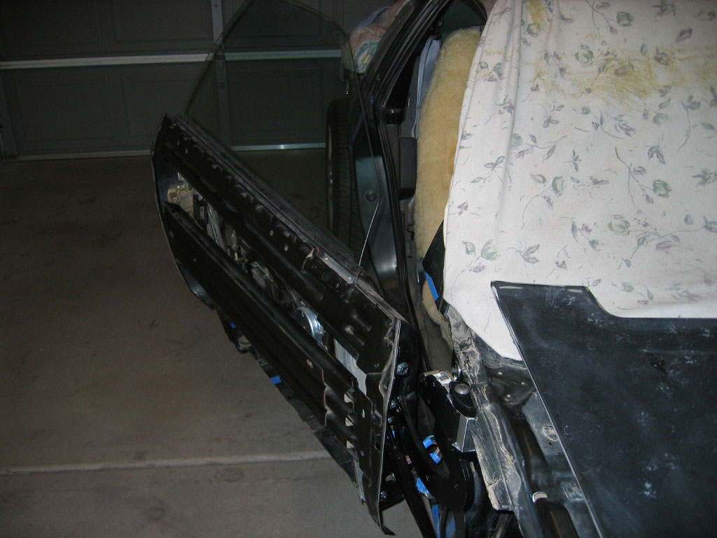

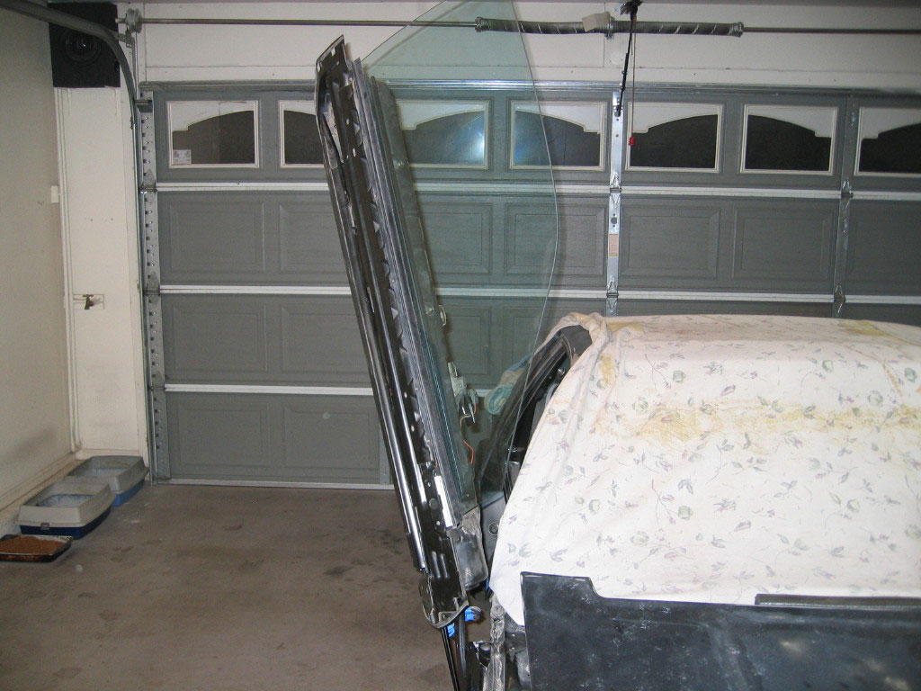

FEB 02, 01:59 AM
Passenger side installed, still need to finish the wiring. Looks like it will work fine.
Thanks Jesse!
Charlie
Bloozberry
FEB 02, 08:09 AM
Ooooooo.... I'm jealous! Watch out for that overhead fan!
I wonder if Lambo hinges would work on the F355 rebodies... being a bunch wider and all, or if the added thickness between the hinge mounting location and the outer skin would cause interference problems? Anybody know?
