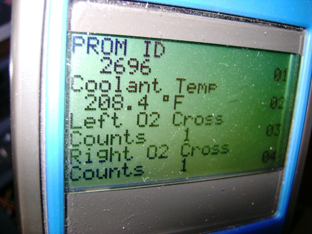

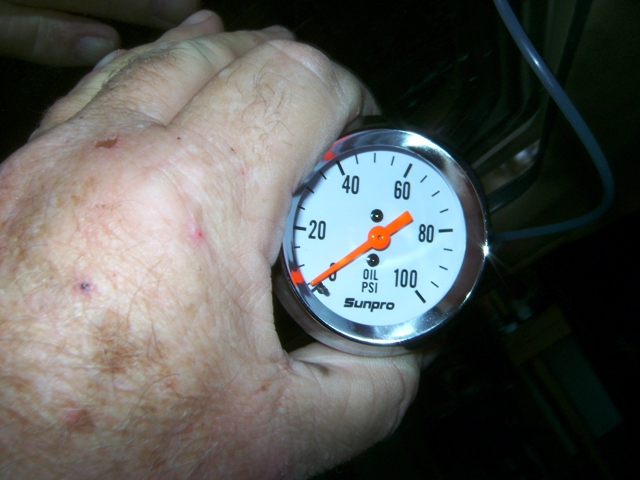

I got me a Sun Pro gauge this morning. The old fashioned type. After a 15 mile drive to get up to normal coolant temperature I pulled over and stopped. I have 0 oil pressure at 600 rpm, driving at 30 mph I have 8-10 lbs of oil pressure. I have 18 lbs at 50 mph, and near 30 at 65 mph. This engine is DEAD. I am gonna be holding a big 4.9 parts swap SALE soon. This is at 600 rpm warm engine
 showing the coolant temperature:
After spending some time thinking about this swap I have decided to cut my losses and remove this 4.9. I will install a T125 automatic and a 2.8. I will not put another dime in to this 4.9 swap. I will remove the 4.9 , it's 4T60E, and all of the necessary swap parts. I will put them up for sale in the Mall. I just want to get this over with and back to driving this great little car. This is one of the best handling little cars I have ever driven and I can not wait to get it back on the road.[This message has been edited by josef644 (edited 02-21-2011).]
