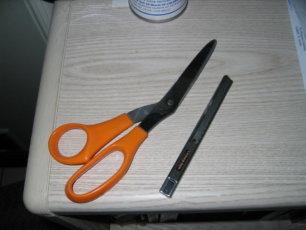

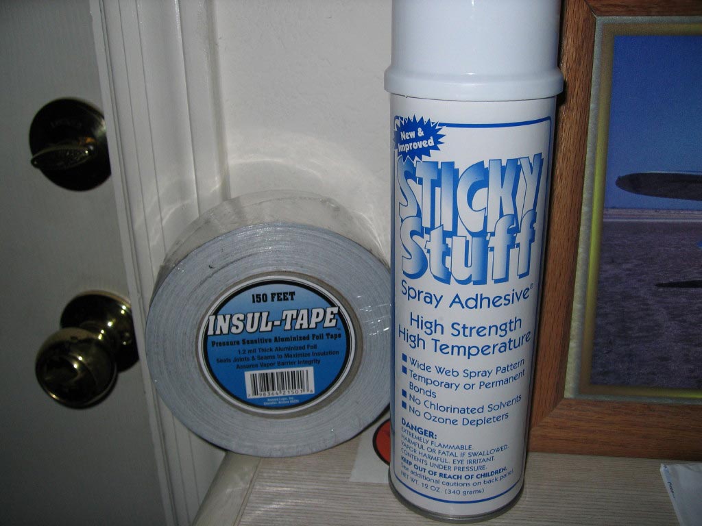

Heat shield from JC Whitney (two 4' X 6' rolls)
Stuff that came with it...
Tools of the trade. I found that Goo Gone (the orange stuff) works great to clean up the sticky over-spray.

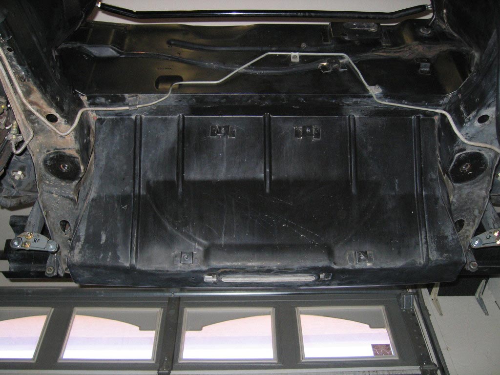

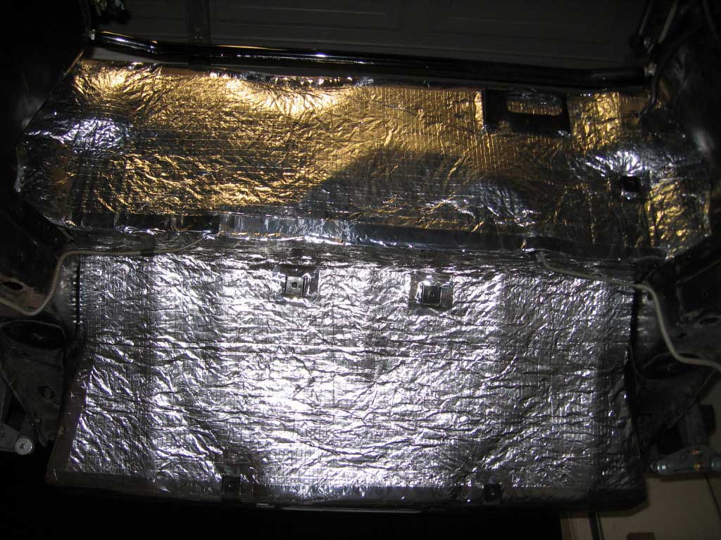

Before shot of rear engine compartment/trunk wall

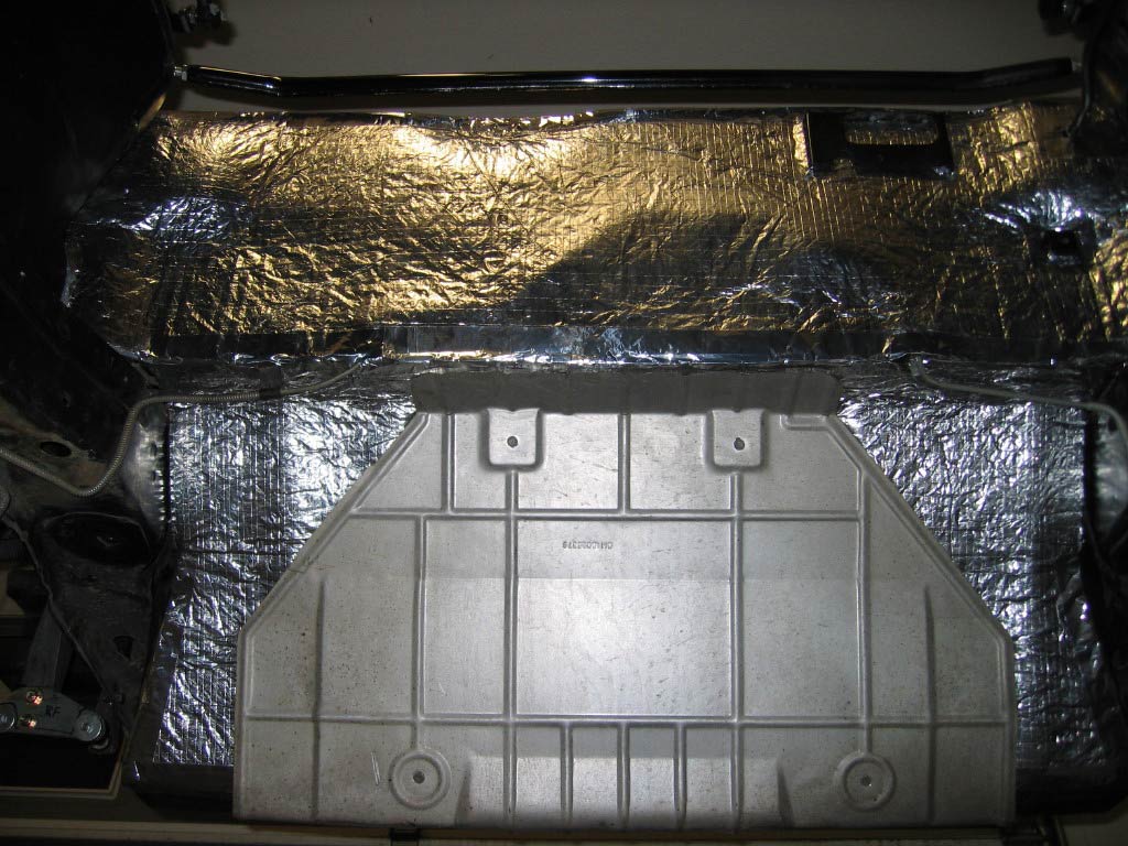

After shot of same.
With stock heat shield.

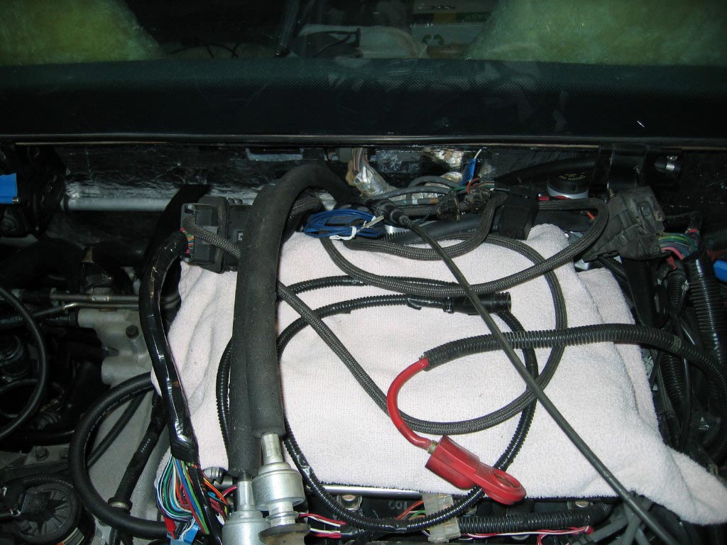

Before shot of the firewall. This is gonna require some medication...
After shot TBA...

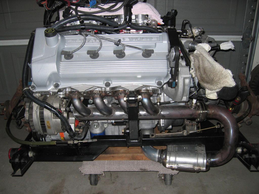

Sneaking a shot of the engine/cradle in... I just love the look of that thing!
Charlie

Gosh, that shur is pretty

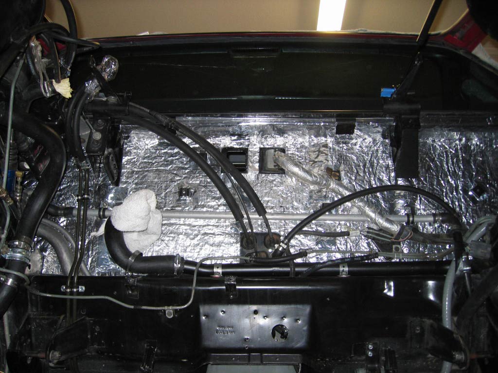

Ok, here is the firewall heatshield installed. I hope it helps.
Charlie

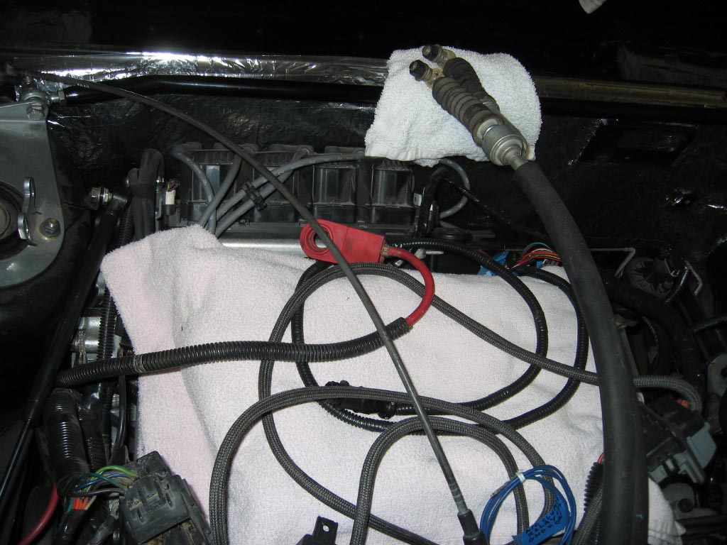

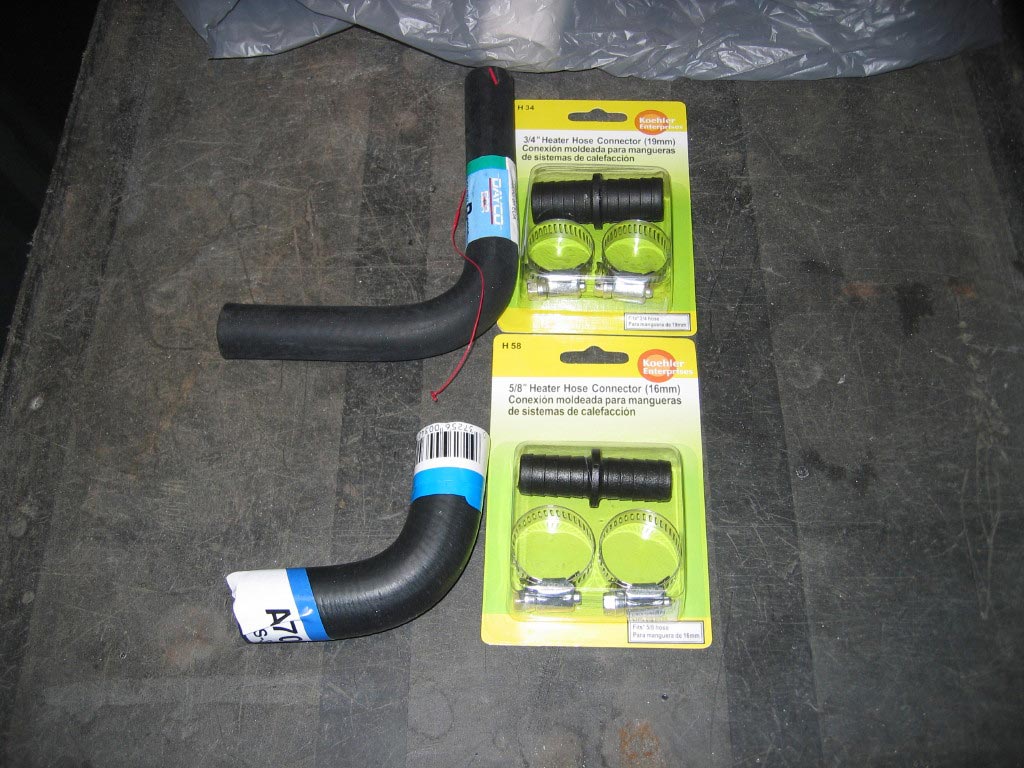

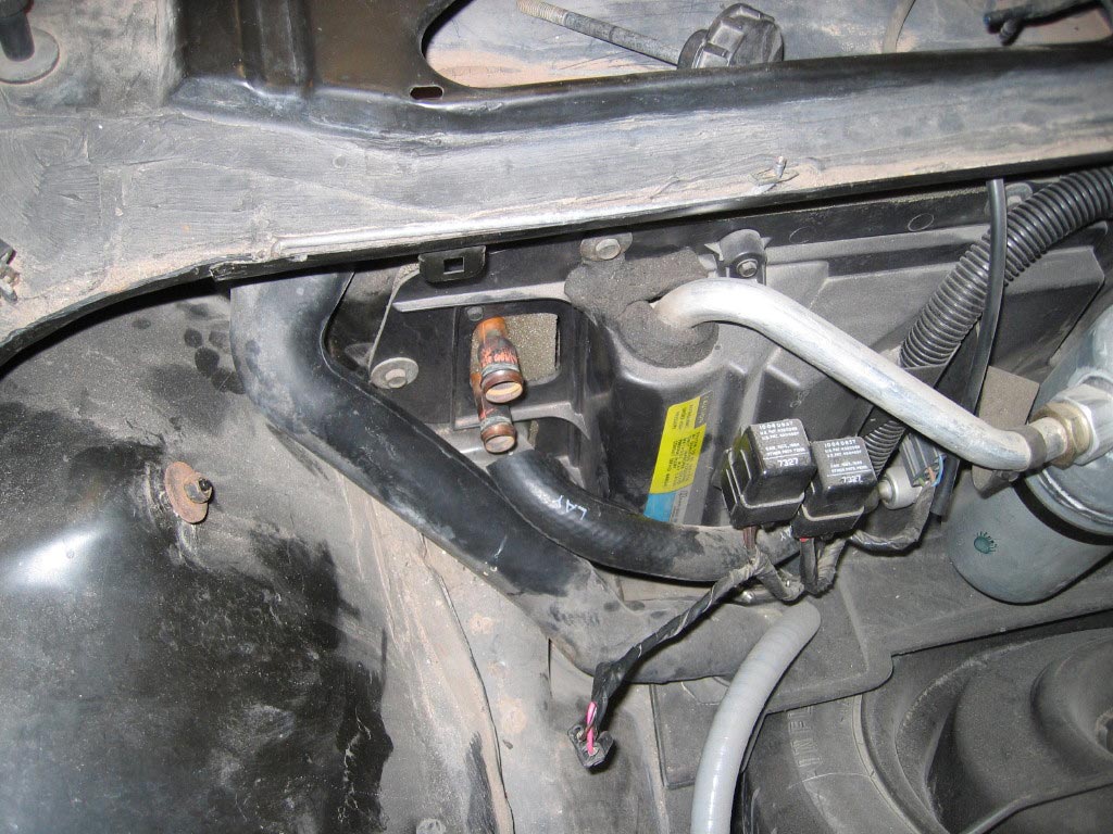

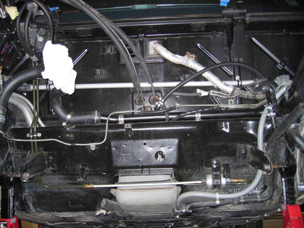

I did get by AutoZone and picked up some 90 degree molded elbows for splicing in the new heater core. Also, I lowered the car back onto the cradle and got clutch slave and rear bay coolant lines connected. When the heater core is done (probably after removing and cleaning the evap core) I will hook the rest of the engine connections up and see if the heat shield is effective.

Engine Bay/heat shield pics. Not much excitement here...
New heater core even though it does not really look new... (from Rock Auto)
Parts to splice in the elbows for the heater core...

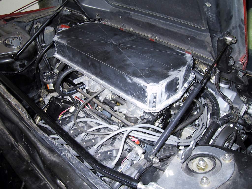

I finally got some time to get the rest of the connections made and put the coolant back in. It surprised me somewhat that the heater lines did not trap air until I ran the engine. I put back the same amount of coolant before I ever turned the engine over... Anyway I ran it until it was at operating temp for 10 minutes and found zero leaks. The other thing I was checking for was how hot the inside trunk wall got. After installing the insulation it no longer burns the skin but it is still warm. Probably as good or better than it was originally. Now, back to prepping the body for paint... In the pic below, I tried using some JB Weld to seal up the corners of the airbox. I am curious how well the paint will stick.

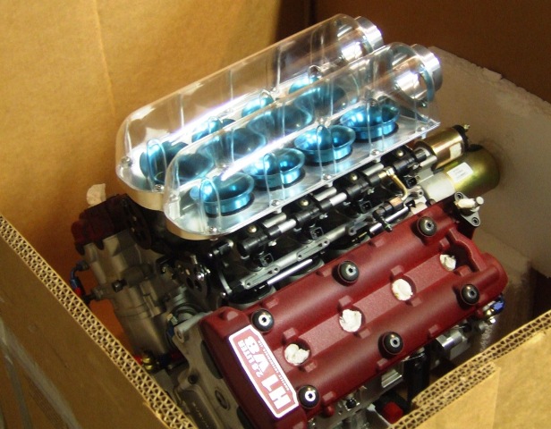

Bloozberry SEP 14, 09:14 PM
Hey Charlie,

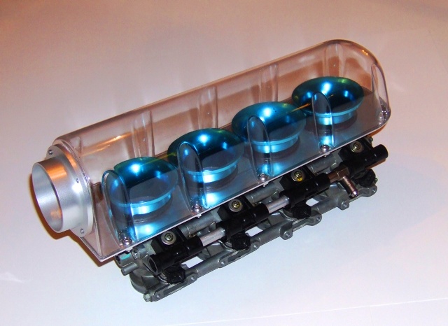

Man, I love that multi carb look! It's a shame to cover it all up with an airbox though... I couldn't bear to hide everything just for the sake of getting some cold air in the cylinders if it were mine. So I went on a surfing mission to see if there was something out there that could expose those velocity stacks and I think I stumbled on something that you need! Check these out at www.h1v8.com/albums/album_i.../4566006/1513317.htm
cptsnoopy SEP 14, 11:59 PM
Hey Blooze,
Those look awesome! Without cutting the top of the decklid open they would not fit but I wonder if I could have a similar style clear cover made for my base plate? Hmmm I will need to look into this further. If I cut the decklid it opens up some problems with rain etc. getting into the valley of the engine. Don't know how big a deal that is but I need to consider it. Thanks for sharing.
